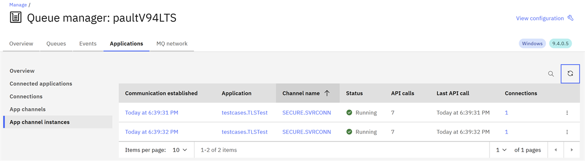

When this runs, the MQ classes for JMS do indeed create two channel instances to the queue manager even though the SECURE.SVRCONN channel has the SHARECNV attribute set to 10. Here is a screenshot from the MQ Console that shows this:
The TLSTest application is using two instances of the SECURE.SVRCONN channel - one for the connection created from cf1, and one for the connection created from cf2.

Now, one of the things that the MQ classes for JMS use when building the Remote Connection Specification is the SSLSocketFactory stored on the connection factory. This means that if two connection factories are identical in every way apart from the SSLSocketFactory property, then the MQ classes for JMS will create two Remote Connection Specification objects for them - as a result, the conversations associated with JMS connections and sessions created from the first connection factory will not share the same channel instance as those created from the second connection factory.
This is what is happening here. Even though cf1 and cf2 are both configured to connect to the same queue manager using the same channel, the fact that they have different SSLSocketFactories mean that any JMS connections and sessions created from cf1 cannot be assigned to the same channel instance as the JMS connections and sessions for cf2.

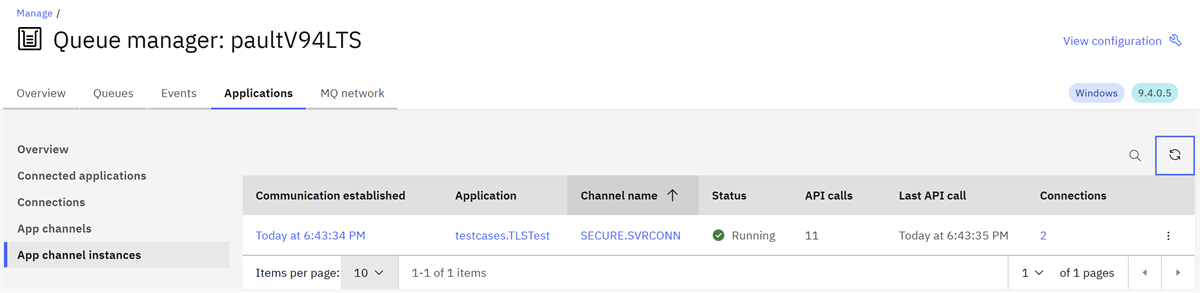

and here is a screenshot from the MQ Console showing both of the JMS connections are on the channel instance:
Here, the connections created from cf1 and cf2 are both sharing the same instance of the SECURE.SVRCONN channel.
