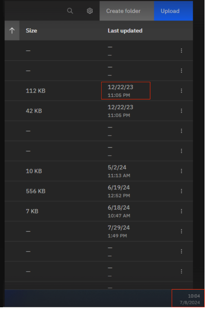

FAQ 1 : Date Format Mismatch
Question:
The time zone and date format on my machine are set to the European standard (dd/mm/yyyy). However, on the Files or Packages page in IBM Aspera on Cloud, dates are displayed in the American format (mm/dd/yyyy), which can be confusing when interpreting timestamps.
Date format

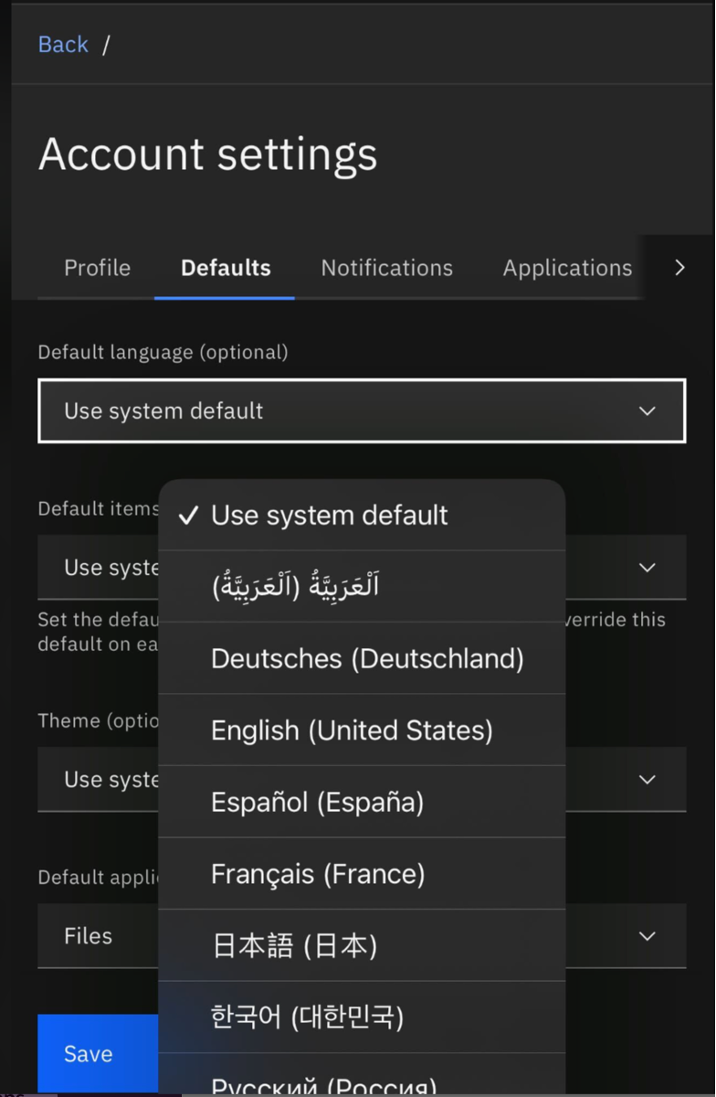

Possible causes:
  1. The “Default Language setting” under Account settings page is not configured  to “Use system default” Please refer to the below screenshot:
    Account Settings
  2. Your system’s default language/locale is set to a value not supported by IBM Aspera on Cloud the language will default to English US.
You can create a support ticket after checking these.

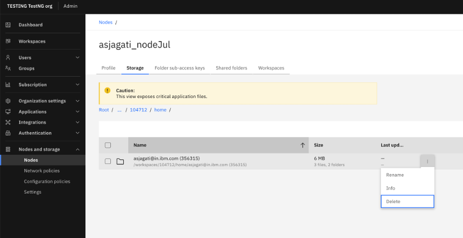

Steps to delete the home folder:

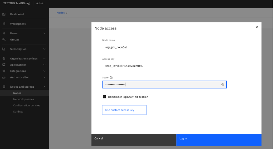

Step 1) Navigate to the admin app, navigate to Nodes and storage and search for the node.
For nodes where node ownership is restricted to "Only ATS Admins", and the user is an Org Admin, the node secret must be entered to gain access (as in the below screenshot).
Nodes and storage
However, if the node ownership is set to "All Admins", then:
  • An ATS Admin or Org Admin can access the node without entering the node secret. An ATS Admin can always directly navigate to the home folder and delete it as needed. With the simplified folder sharing feature, based on the node ownership settings, admins can access the nodes without needing to manually enter the node secret.
Step 2) Go to the user’s home folder and delete it.
home folder
Note: Be cautious while deleting as this action cannot be undone and the deleted folders are permanently removed without recovery.
