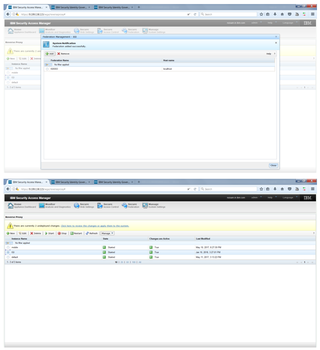

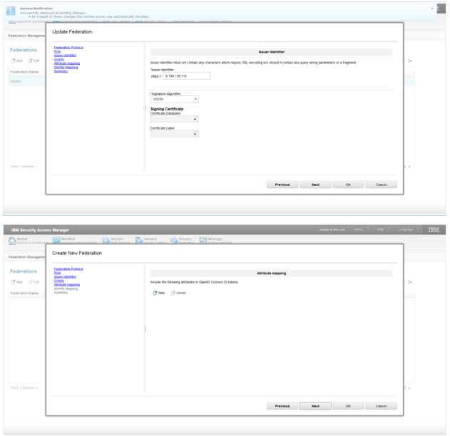

Set up a federation in IBM Security Access Manager.
Follow the directions at https://www.ibm.com/support/knowledgecenter/SSPREK_9.0.0/com.ibm.isam.doc/config/task/tsk_config_op_federation.html

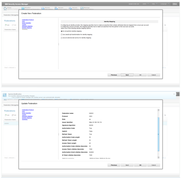

Procedure

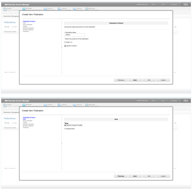

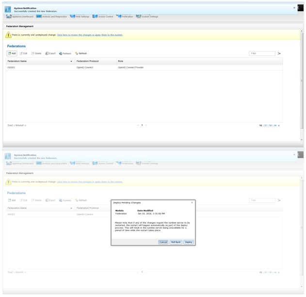

  1. Log in to the local management console.
  2. Select Secure Federation > Manage > Federations.
  3. Click Add.
  4. Enter a federation name.
  5. Select the OpenID Connect as the protocol.
  6. Click Next.
  7. Select the OpenID Connect Provider option.
  8. Enter the provider ID. This ID must uniquely identify this federation, and must not contain URL-unsafe characters as this value will be present in runtime URLs.
  9. Select a signature algorithm. If RS256 signing is selected, select a certificate from the list.
  10. Click Next.
  11. Select the grants this OP issues. Optionally, adjust any of the timeouts or lengths.
  12. Click Next.
  13. Select the method for identity mapping.
  14. Review the Summary page.
  15. Click OK to create the federation.

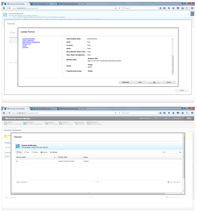

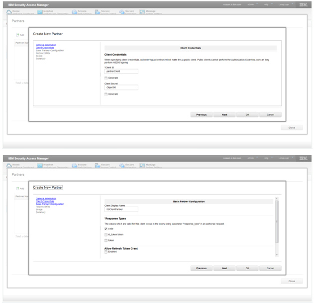

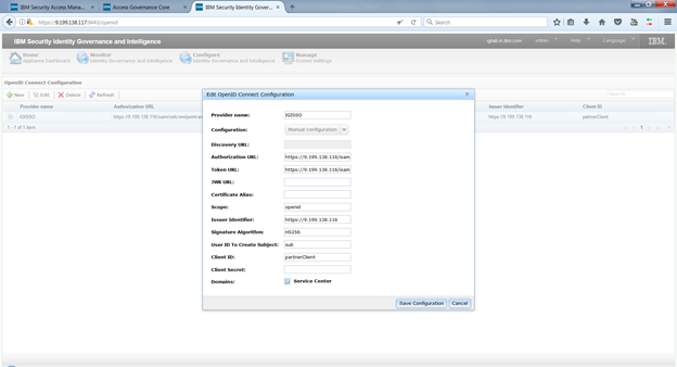

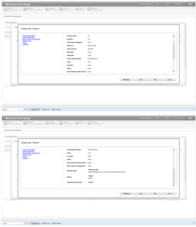

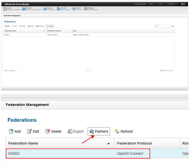

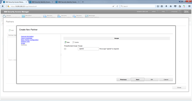

Create and register the client.
Follow the instructions at https://www.ibm.com/support/knowledgecenter/SSPREK_9.0.0/com.ibm.isam.doc/config/task/tsk_config_op_partner.html. The redirect URI is the Identity Governance and Intelligence application. The format is
Here the Redirect url is - <igi_hostname>:<port>/oidcclient/redirect/<name of Federation (created in earlier step)>
You may use the ip address for testing purpose, if using the hostname then it should be resolved from ISAM.
 Note: Hostname is the localhost, port is 443, username : easuser and password is Passw0rd by default.
This is default setting, easuser password might be different.

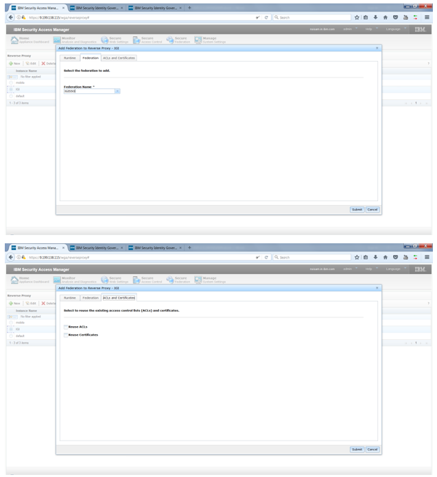

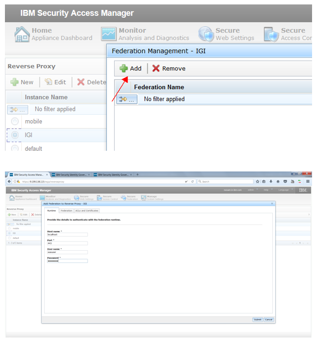

Now create junction
https://www.ibm.com/support/knowledgecenter/SSPREK_9.0.0/com.ibm.isam.doc/config/task/ConfiguringSAML2POC.html

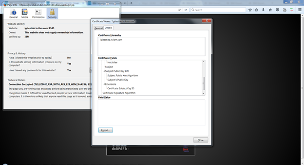

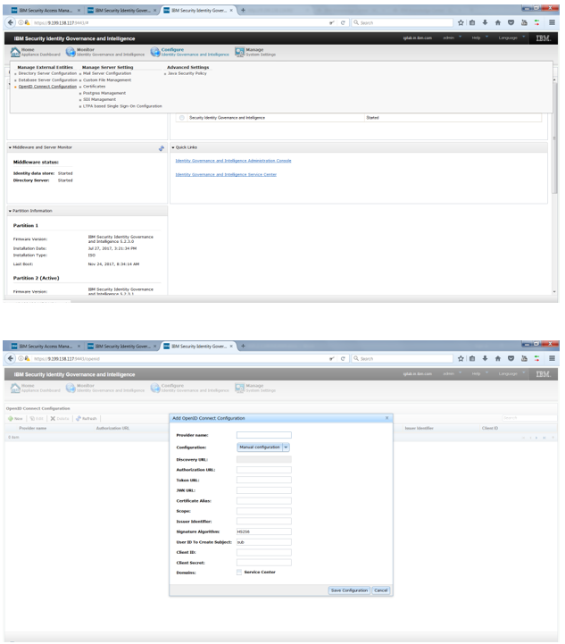

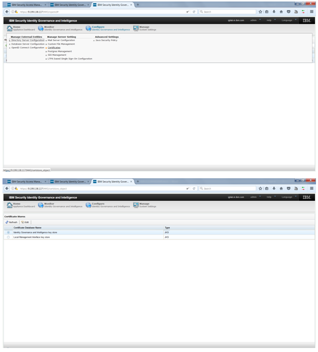

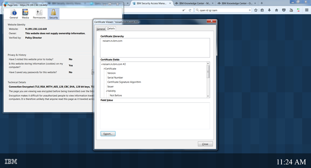

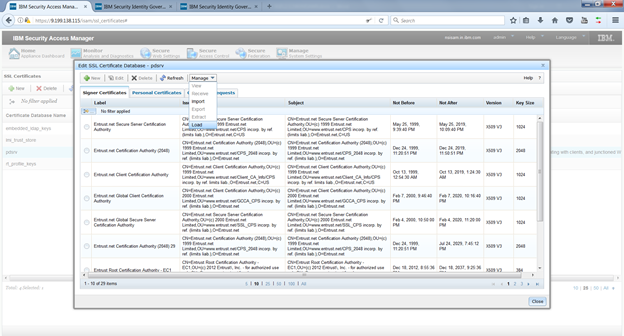

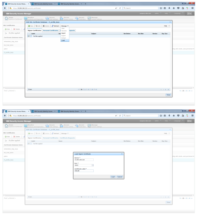

Export the certification from IGI:
You may use import or load.

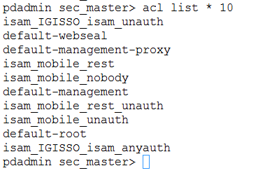

Verify all ACL’s are in place:
pdadmin sec_master> acl list

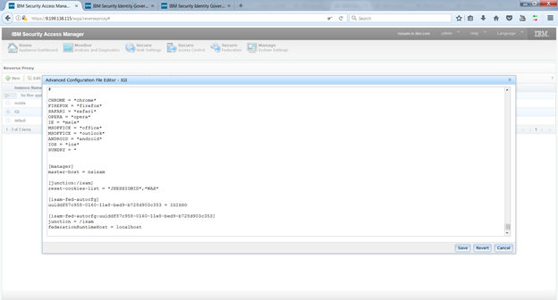

Now as per step#6,

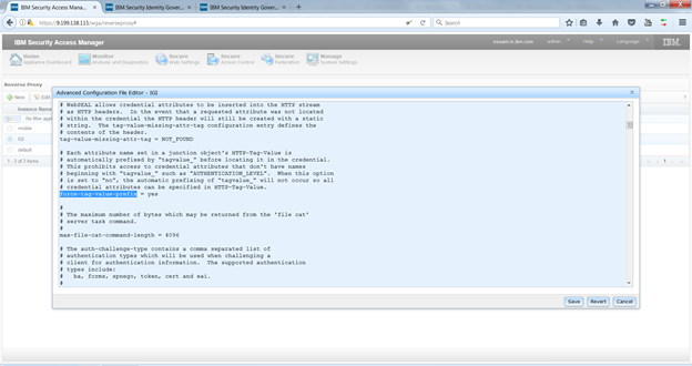

pdadmin sec_master> object modify /WebSEAL/nsisam.in.ibm.com-IGI/isam/ set attribute HTTP-Tag-Value user_session_id=USER-SESSION-ID

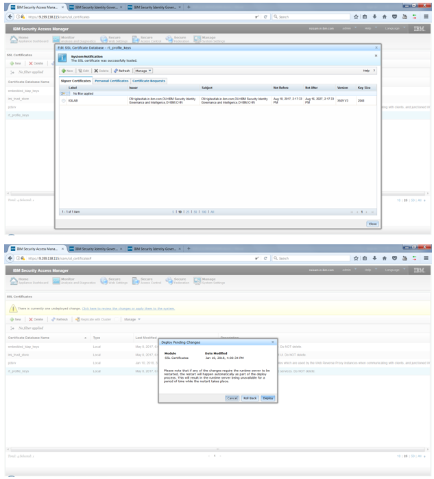

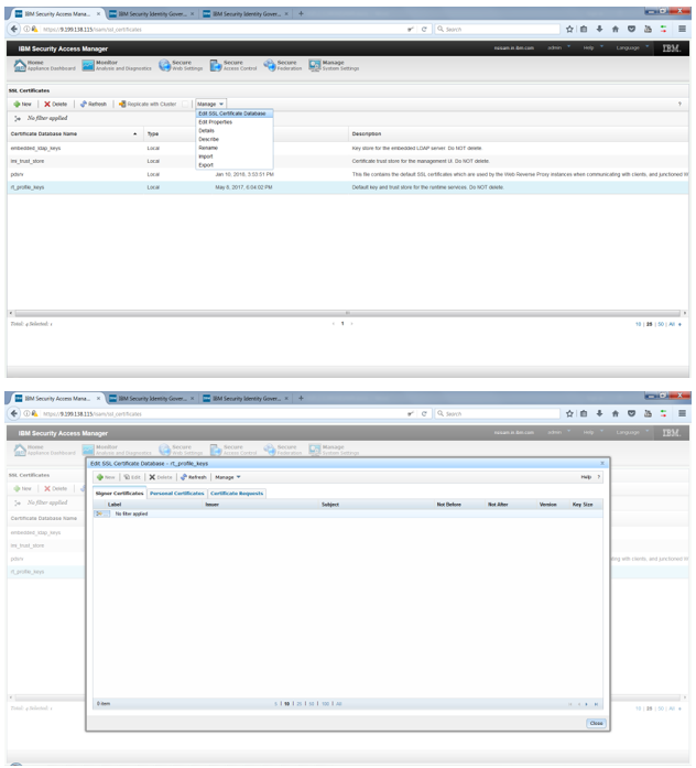

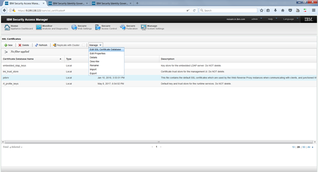

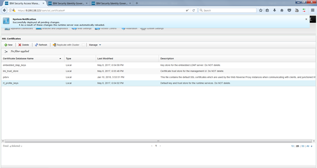

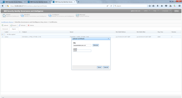

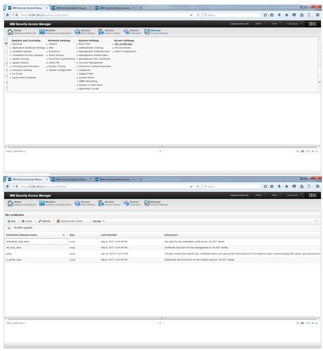

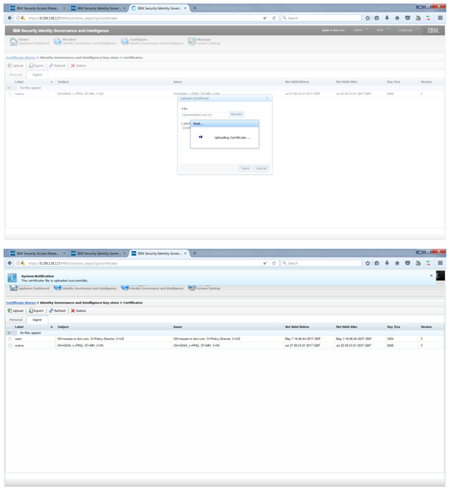

Export certification from ISAM application interface:
Import to IGI.

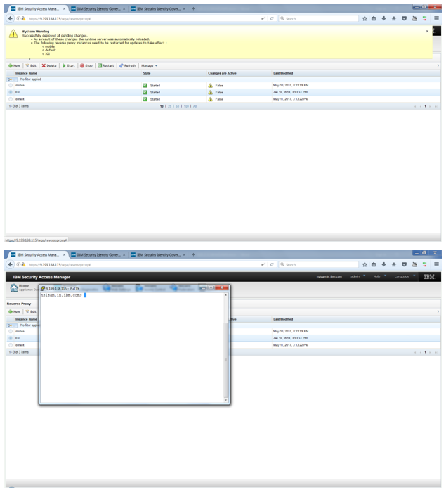

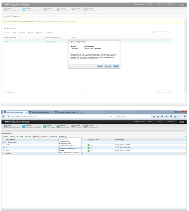

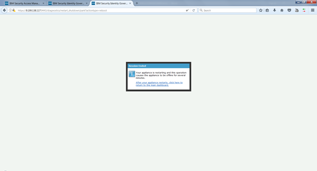

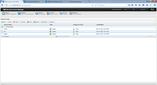

Restart IGI

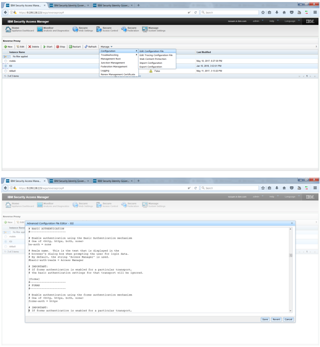

Restart isam proxy instance:

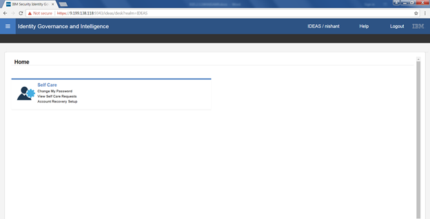

Testing the configuration

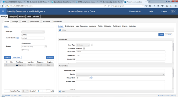

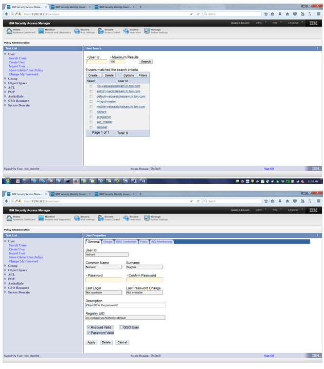

  1. Create a user in ISAM

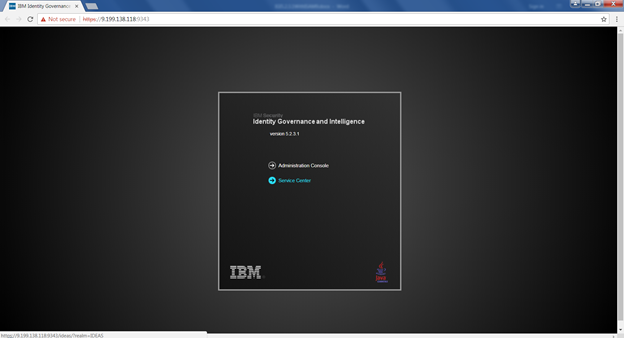

  1. Create the same user in IGI:
Login to service center:
