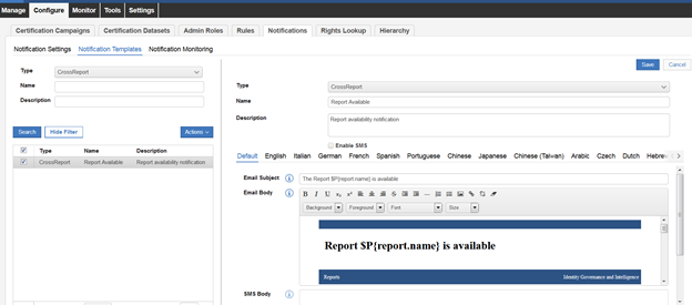

- From AGC validate a notification template is available for CrossReport

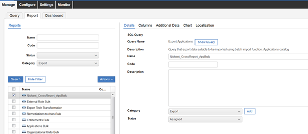

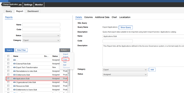

- Then from the Report Designer, copy existing report of type “Export”, this is just an example
- Save this, for example I have setup like below:

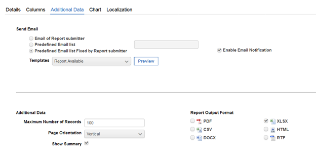

- All the other columns are left as default expect for “Additional Data” and Enabled the mail notification.

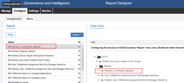

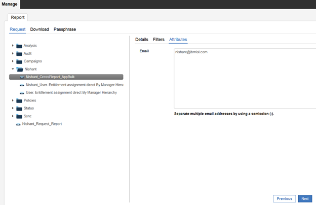

- Next we can setup a category to this report and added to menu which I created with name “Nishant”
- Then I login with “Nishant” user who has access to run this report and provide the email address and execute:

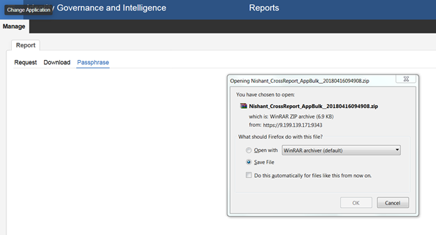

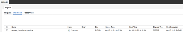

- Verify by clicking download option if this is completed:

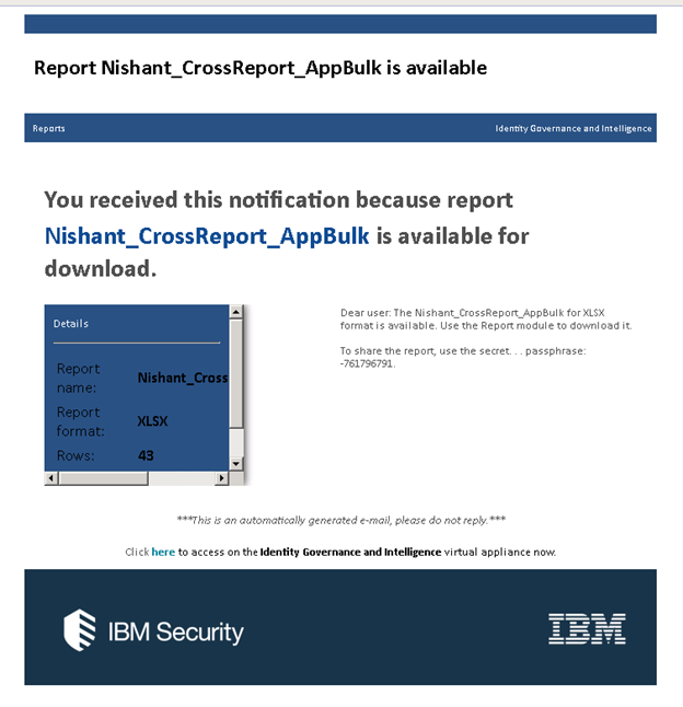

- Once this is executed and available for download you see a notification with passphrase:
Note the passphrase key here :
To share the report, use the secret. . . passphrase: -761796791.

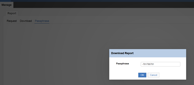

Now you can click on passphrase and provide this value (you may login with a different user who has access to Report menu in Service Center:
You will be able to
download this report:
