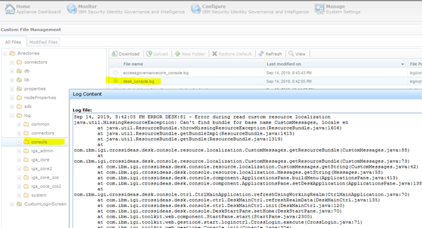

Take a restart of IGI Application and now you’ll be able to access admin console using SSO .
If some how you observe any issues , navigate to below log file and check error message
Configure IGI - > Manage Server Settings - > Custom File Management -> logs – Console -> desk_console.log
Note: Make sure that websocket is enabled on WebSEAL instance [Refer https://ibm.biz/BdqrXb].
