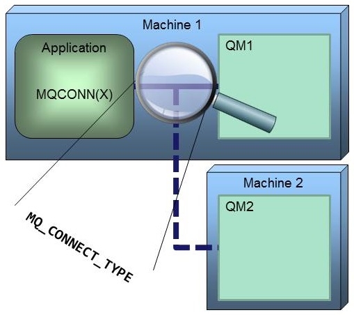

When the IBM MQ Multi-version install feature was created in MQ V7.1, the mqm libraries became "smart". That is, they were able to load the correct libraries for the version of queue manager you were connecting to, regardless of the version of the libraries you pointed at. At the same time, they became even smarter still by being able to make both locally bound connections and client channel connections (previously the remit of the mqic libraries).
The mqic libraries are still there, and still work just as they always did (after all you have applications linked to them so they couldn't be removed). But now, if you have need to convert an application which uses a locally bound connection, into one that uses a client channel connection, life is much simpler than it used to be.
Here's the old process (pre MQ V7.1)
  • Re-link application to use mqic library instead of mqm library.
  • Set MQSERVER environment variable, or point to a CCDT. Set other environment variables as well if using SSL/TLS.
  • Run application and connect as a client.
Morags_MQ_Gems_30.jpgHere's the new process (MQ V7.1 and later)
  • Set MQ_CONNECT_TYPE environment variable.
So instead of having to go to the trouble of re-linking an application, all you need to do is set a single environment variable that does the job instead.
