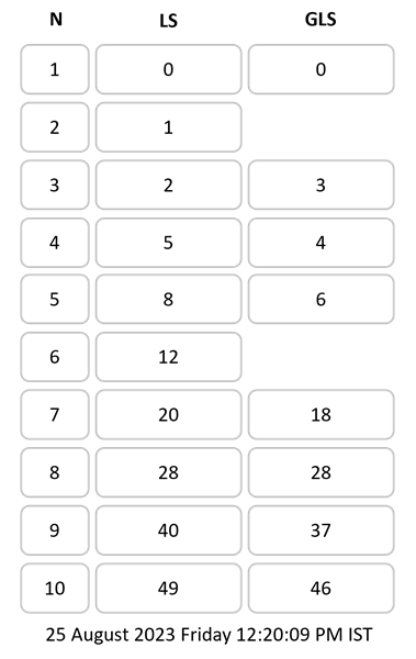

One can think of a minimal number of entries that defines a GLS uniquely. Such a set is known as a Critical Set. We believe a Critical Set of an order four GLS has four entries. Whereas it is impossible to create a GLS Order Four uniquely with only three entries. I have an algorithm to create a Critical Set of order four GLS but that does not cover all the Critical Sets of an order four GLS.
The concept of Critical Sets could be extended to Latin Squares too. Below is a study on the minimum sizes achieved so far of the Critical Sets for both Latin Squares and Graeco Latin squares.
