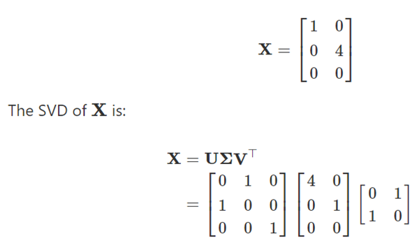

As a simple example, if we have:
We can also check that the matrices U, Σ, and V fulfill the requirements of the SVD. First, X has dimensions 3×2. U has dimensions 3×3, Σ has dimensions 3×2, and V has dimensions 2×2. Second, U and V are orthogonal matrices. Note that we select this example for simplicity. As we will soon see, for real datasets the elements of U, Σ, and V' are rarely integers.

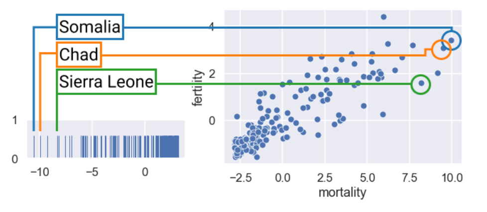

We have successfully performed PCA to reduce X from 2 dimensions to 1. Dimensionality reduction attempts to summarize the data with fewer dimensions while preserving patterns in the data. One way to verify this is to check that points that appear together in the two-dimensional data (scatter plot) also appear together one-dimensional data (rug plot).
