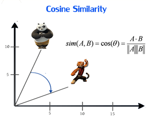

Our objective is to have words with similar context occupy close spatial positions. Mathematically, the cosine of the angle between such vectors should be close to 1, i.e. angle close to 0.

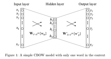

CBOW Model: This method takes the context of each word as the input and tries to predict the word corresponding to the context. Consider our example: "Have a great day". Let the input to the Neural Network be the word, "great". Notice that here we are trying to predict a target word "day" using a single context input word great. More specifically, we use the one hot encoding of the input word and measure the output error compared to one hot encoding of the target word "day". In the process of predicting the target word, we learn the vector representation of the target word.
Let us look deeper into the actual architecture.
The input or the context word is a one hot encoded vector of size V. The hidden layer contains N neurons and the output is again a V length vector with the elements being the softmax values.
Here:
  • Wvn is the weight matrix that maps the input x to the hidden layer (V*N dimensional matrix)
  • W`nv is the weight matrix that maps the hidden layer outputs to the final output layer (N*V dimensional matrix)
The hidden layer neurons just copy the weighted sum of inputs to the next layer. There is no activation like sigmoid, tanh or ReLU. The only non-linearity is the softmax calculations in the output layer. But the above model used a single context word to predict the target. We can use multiple context words to do the same.
The above model takes C context words. When Wvn is used to calculate hidden layer inputs, we take an average over all these C context word inputs.

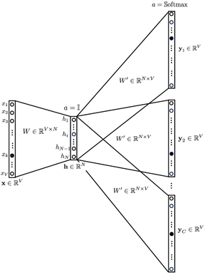

So, we have seen how word representations are generated using the context words. But there’s one more way we can do the same. We can use the target word whose representation we want to generate, to predict the context and in the process, we produce the representations. Another variant, called Skip Gram model does this.
Skip-Gram model:
This looks like multiple-context CBOW model just got flipped. To some extent that is true. We input the target word into the network. The model outputs C probability distributions. For each context position, we get C probability distributions of V probabilities, one for each word.
 In both the cases, the network uses back-propagation to learn. Both have their own advantages and disadvantages. According to Mikolov, Skip Gram works well with small amount of data and is found to represent rare words well. On the other hand, CBOW is faster and has better representations for more frequent words. To make the algorithm computationally more efficient, tricks like Hierarchical Softmax and Skip-Gram Negative Sampling are used.
