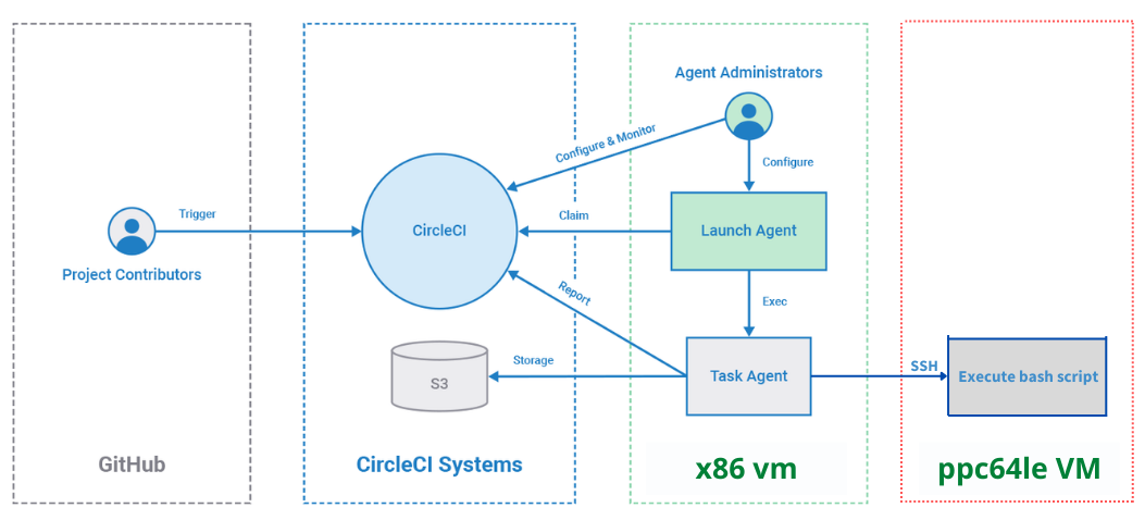

In this tutorial, we will see how to build multi-arch images by using self-hosted runners in CircleCI. Since ppc64le self-hosted runners are not supported, we will use a workaround to SSH into the Power machine from the self-hosted x86 runner.

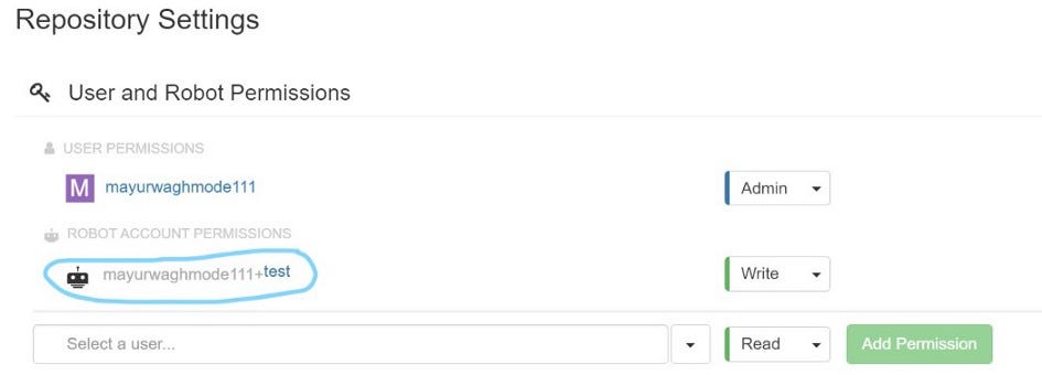

Step 1: Setup the Quay repository with a new Robot account
Create a repository on Quay.io and add a Robot account to it. A robot account will be useful to pull/push your multi-arch images from/to the container registry (ensure you set the write permission to your robot, like the picture below).

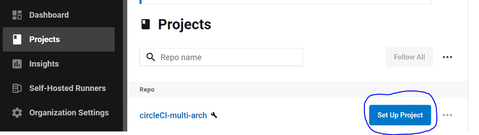

- Next, you need to add your repo as a new project on CircleCI. To add your new repo, ensure that your GitHub account is selected in the dropdown in the upper-left, find the repository you just created below, and click the Setup project button next to it.

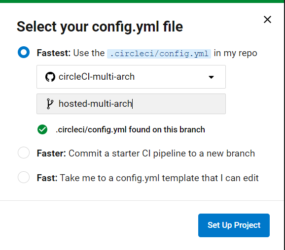

- On the redirected page, you will notice three options (Fastest, Faster and Fast), with Fastest selected as the default. We’ll use this default option.
- Enter hosted-multi-arch in the input field for the GitHub branch (notice the text underneath the field confirming the presence of the
.circleci/config.yml
file) and click Set Up Project.

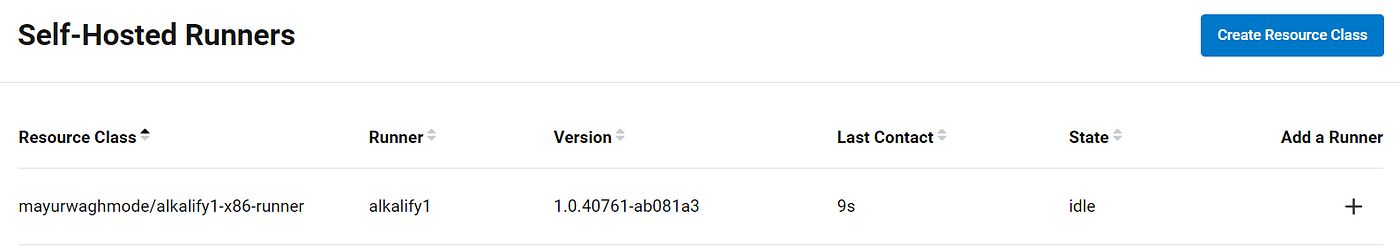

Step 7: Add a self-hosted runner to CircleCI
Follow these instructions for adding a self-hosted runner to CircleCI on an x86 machine. Once your runner is successfully configured and listening for jobs, it will display as idle which means you can execute your workflow.
You will need to update your custom resource class name of Self-Hosted Runner in .circleci/config.yml present on the GitHub repository.

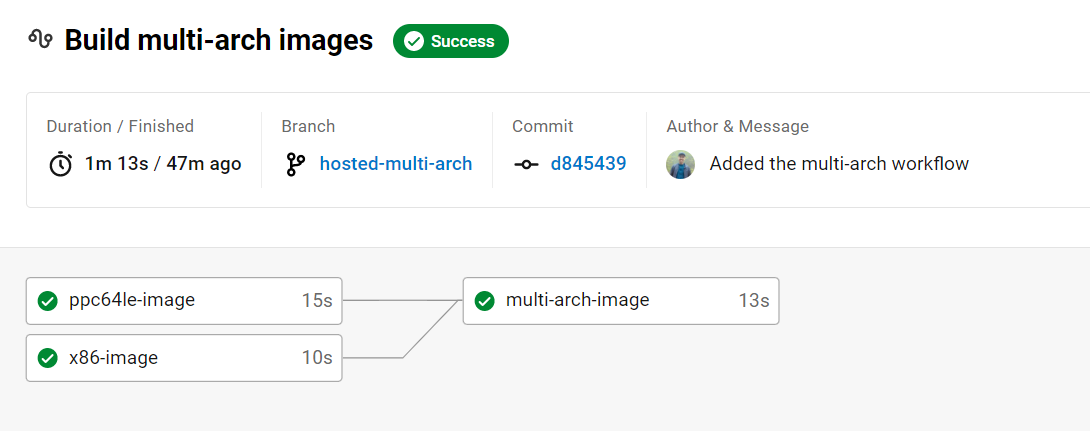

To use the newly created Environment Variables, re-trigger the CircleCI build by committing the .circleci/config.yml file or by re-running the failed workflow from the start.

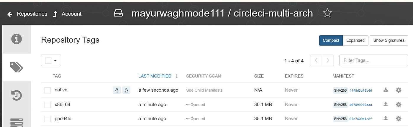

Once the workflow is executed successfully, verify that the multi-arch image is pushed to your quay repository.
