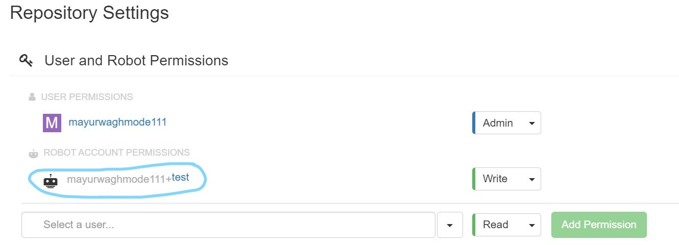

Step 1: Setup the Quay repository with a new Robot account
Create a repository on Quay.io and add a Robot account to it. A robot account will be useful to pull/push your multi-arch images from/to the container registry (ensure you set the write permission to your robot, like the picture below).

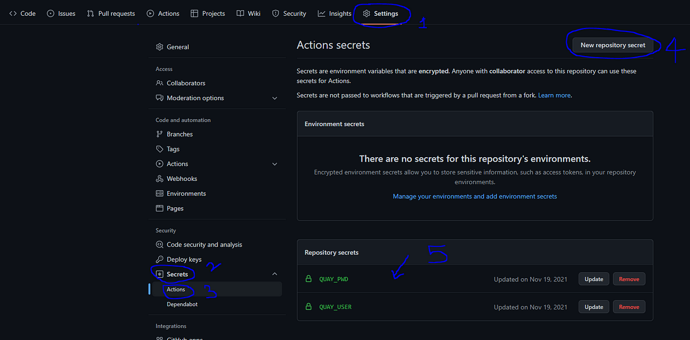

Step 2: Setup the Github repository
Create a new repository on GitHub. On the repository create a new set of new secrets to avoid exposing the credentials of the Quay.io robot. Go to Settings > Secrets > Actions > New repository secret and add a variable for the robot username and another for the token as seen below:

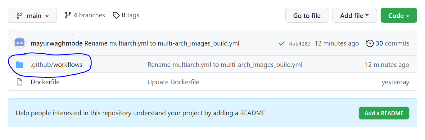

In your GitHub repository, create a .github/workflows/ directory.

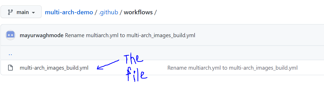

Inside the .github/workflows/ directory, create a new file where we are going to add the build configuration:
The file describes what should happen. It uses some pre-existing actions available in GitHub’s Marketplace, to ease the process:

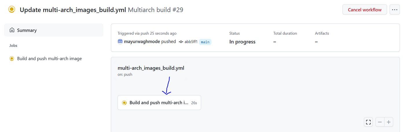

Once the job is configured, each new merge will trigger a new build (you can customize it according to your needs).

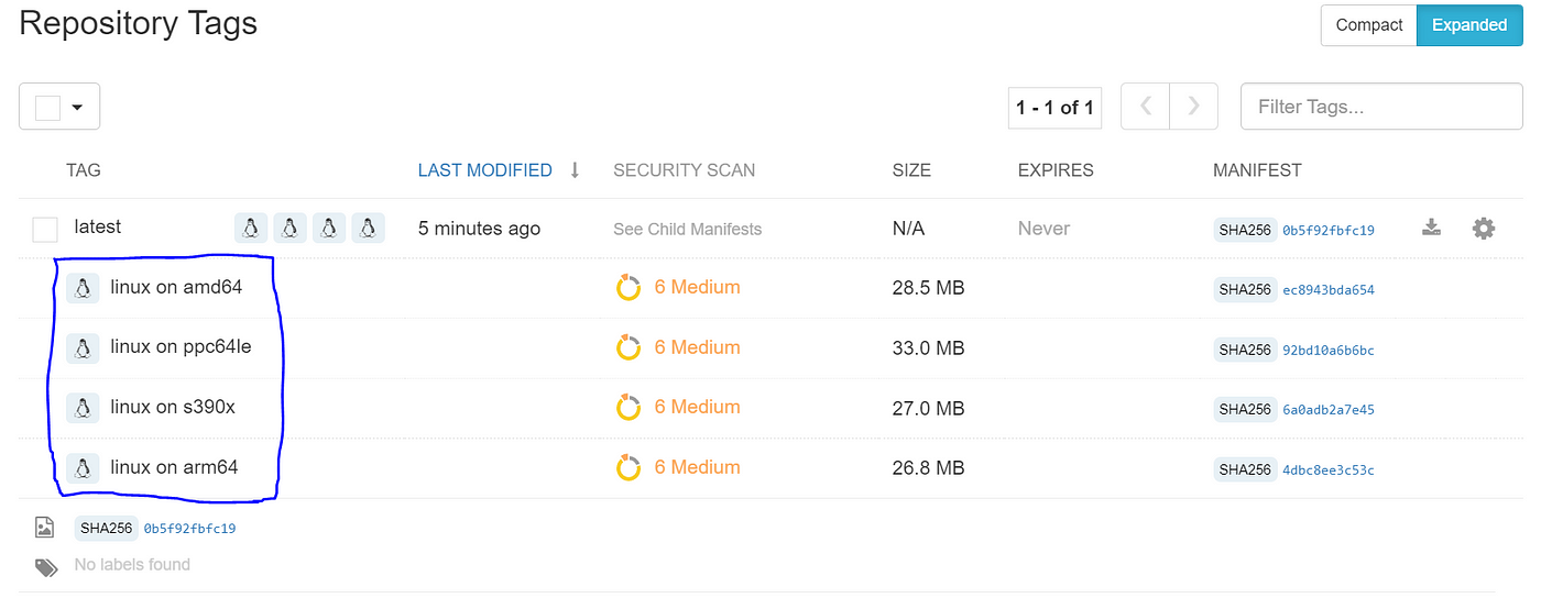

And will push it to quay.io at the end of the process:

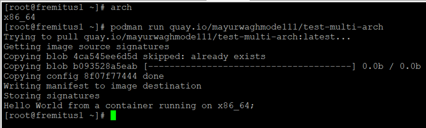

Step 5: Finally, test your multi-arch image
I haven't tested it on an arm64 machine because of a lack of resources. But hope it will work there as well.
