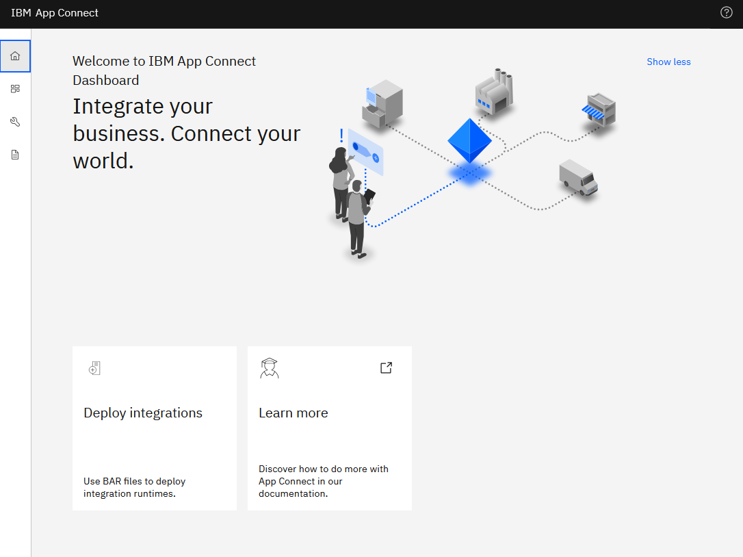

Step 5: Deploy the ACE Dashboard
The dashboard is the main UI for ACE. It can be used to store BAR files you want to use in your Integration Runtimes. Below you see a YAML file with a minimal setup. Note the version is set to ‘13.0’, important if you want it to work with the operator version ‘12.14.0’. The license and use will determine if you are going to pay any license costs, so choose wisely.

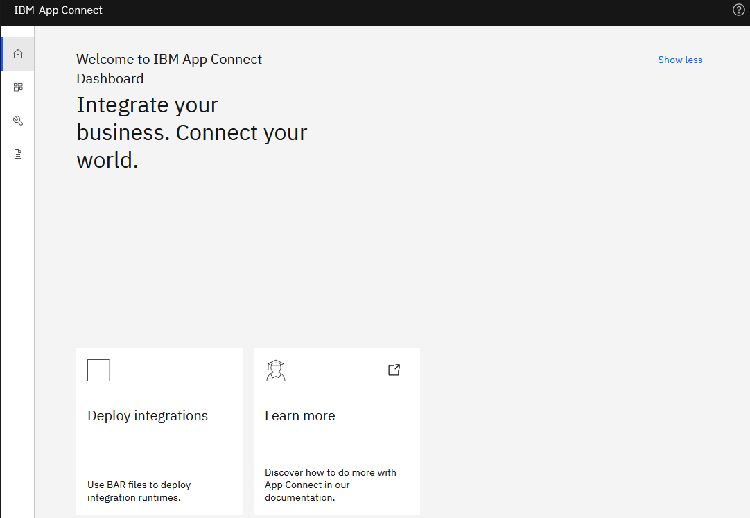

Create the dashboard:
k apply -f ./ace-dashboard.yaml
dashboard.appconnect.ibm.com/ace-dashboard created

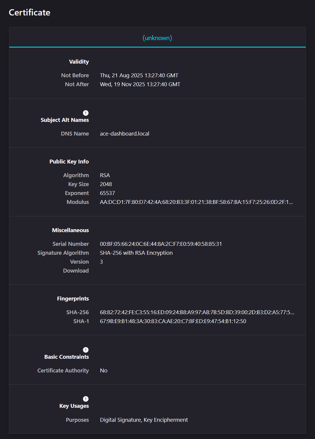

And then go to https://ace-dashboard.local/home
And have a look at the certificate; there you can clearly see the DNS Name provided by the Ingress.

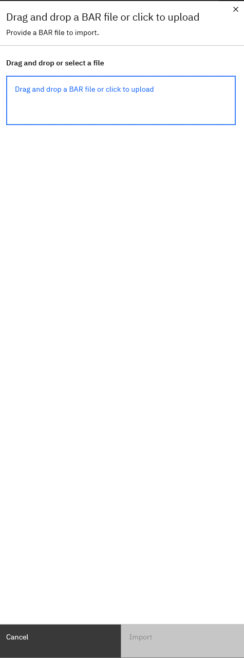

Step 7: Uploading a BAR file
You could upload a BAR file via the built-in API, as described in this blog Introducing the API for IBM App Connect in containers by Matt Bailey, but we’ve been doing so much with the CLI that I’m going to switch it up and use the web UI.

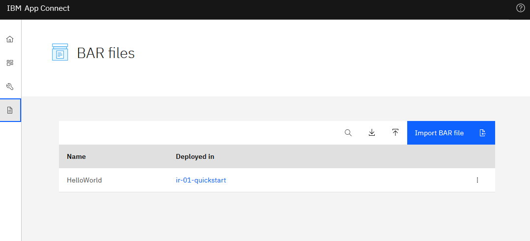

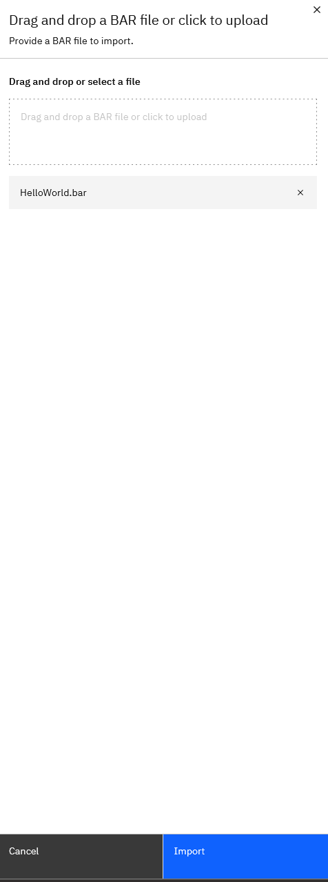

In the dashboard, open up the left-hand menu and click on BAR files
This brings you to an empty page where you import your very first BAR file
Click on the big blue button Import BAR file. A new window slides open from the right.
Find the BAR file you want to import, and click on Import in the bottom left
All uploaded BAR files will be listed on this page

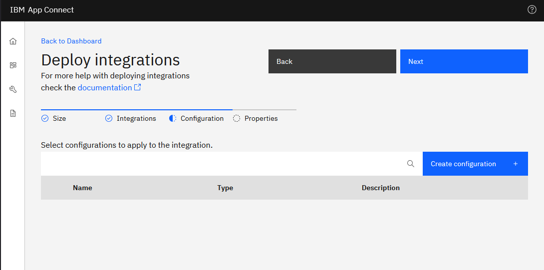

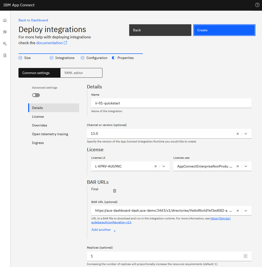

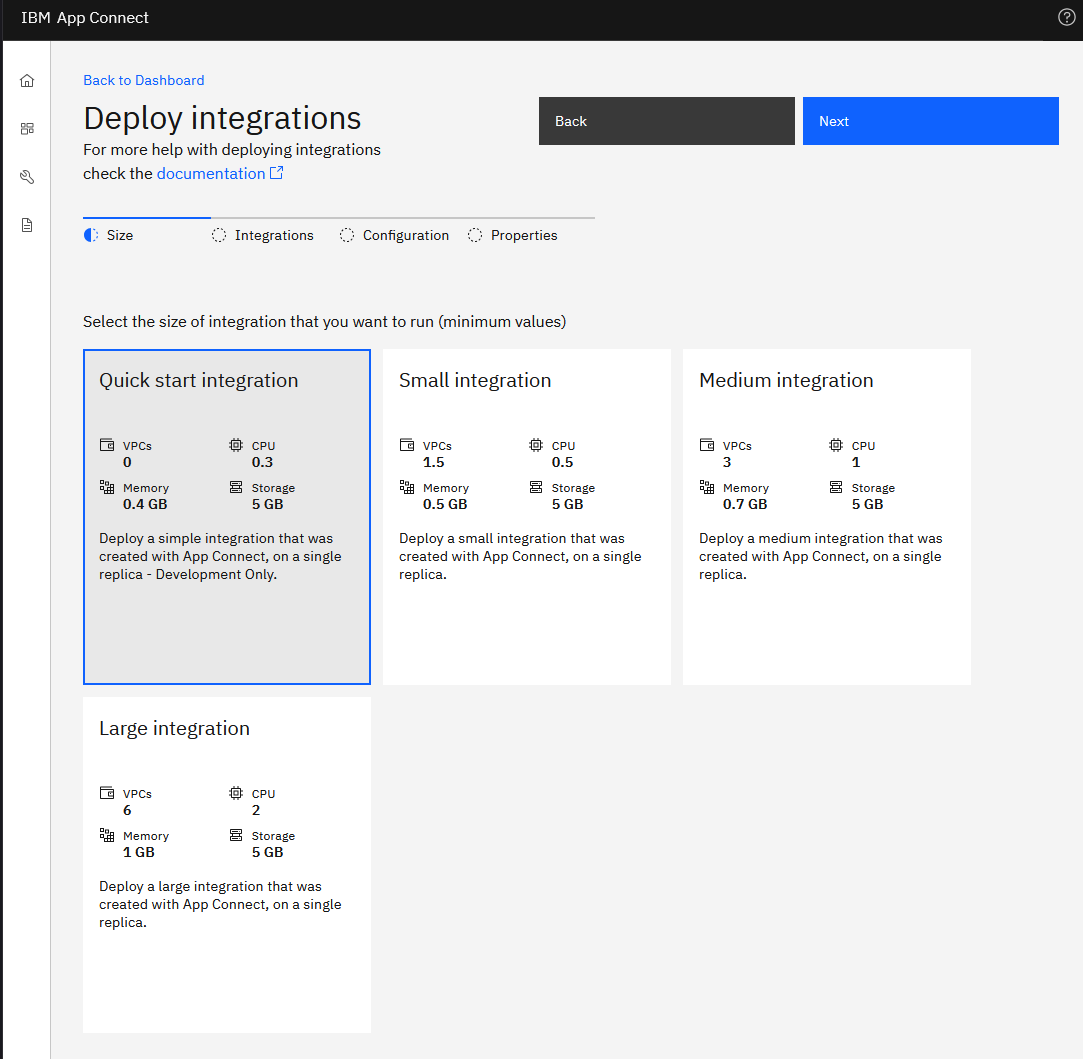

Step 8: Creating a runtime
Go back to the main dash
Click on deploy integrations

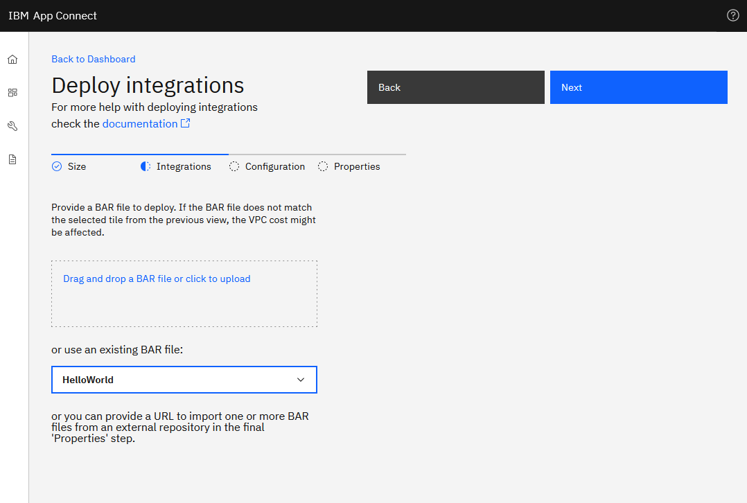

Select the quick start integration
Select the previously uploaded BAR file
We don’t have any pre-made configurations, so we can skip this
Just use the default values; those should be fine for most situations. Then hit Create
And your integration server is starting. If you check your Minikube cluster at this point, you will see the following objects created

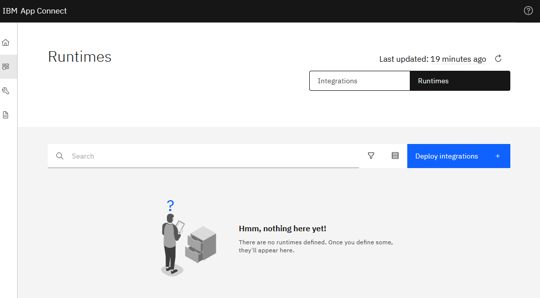

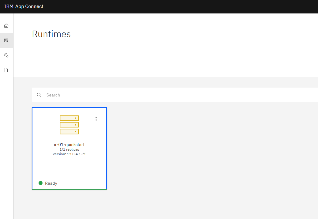

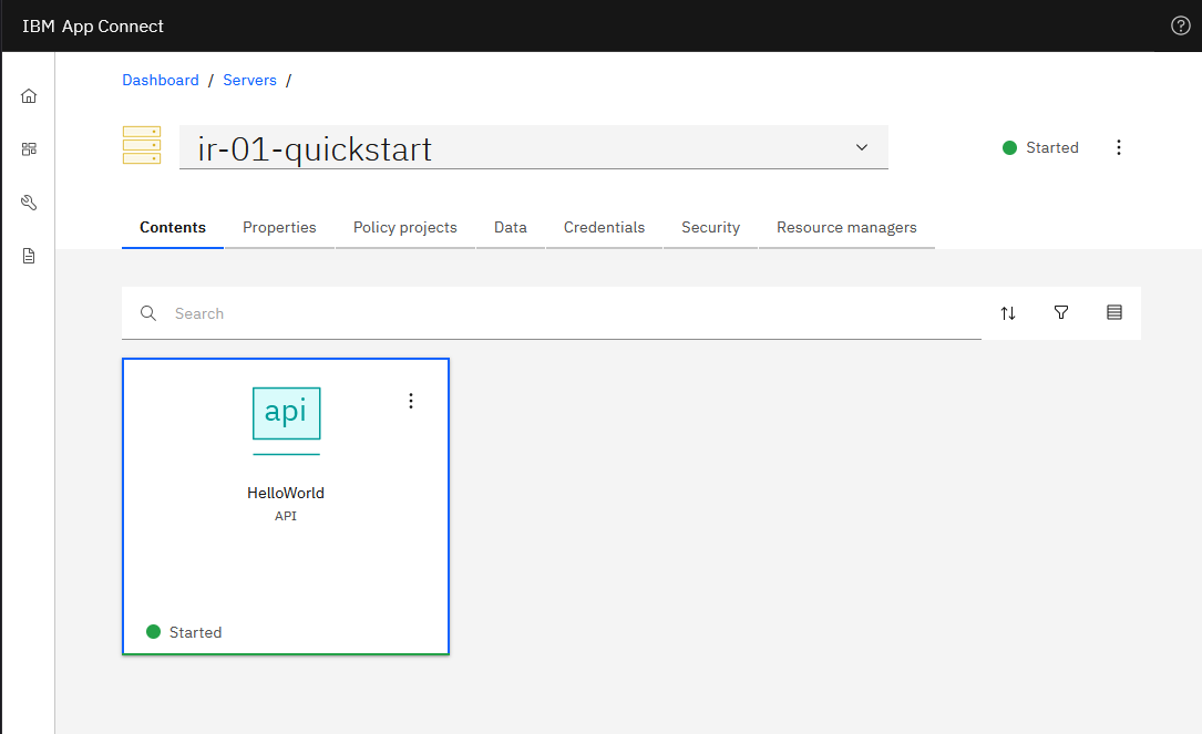

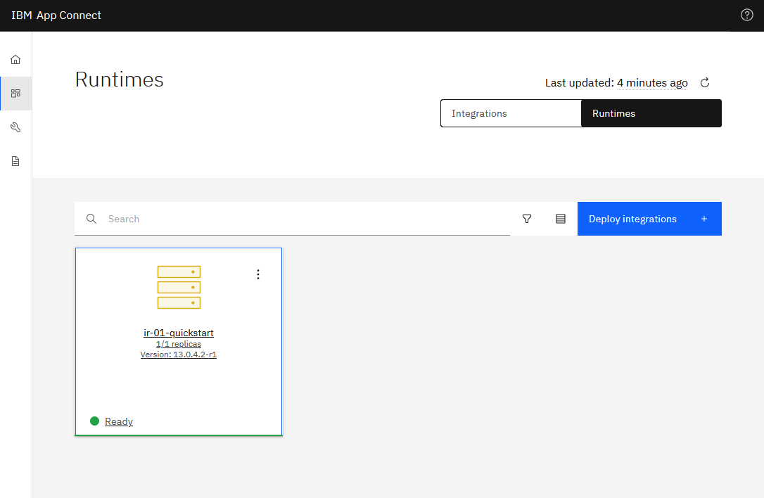

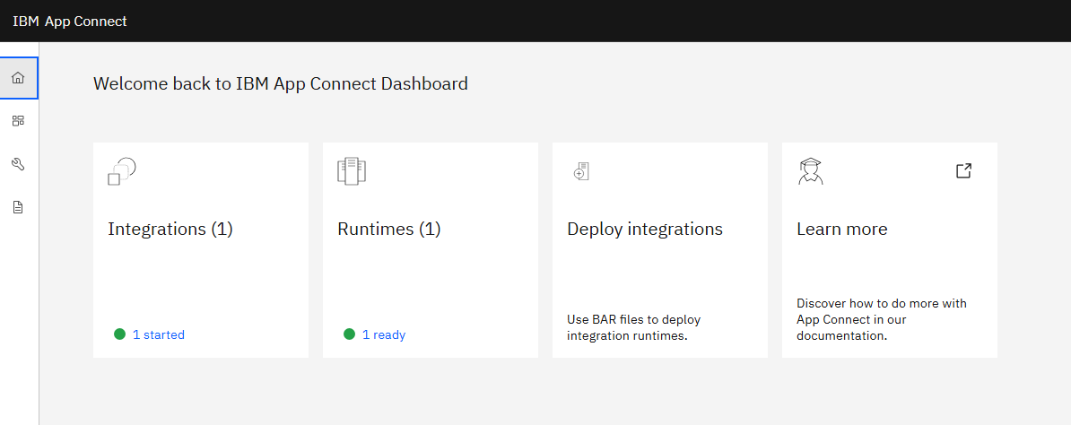

Once everything is running, you should see the runtime inside the dashboard
Dashboard issue: runtime not visible
If you have created the runtime, and the Kubernetes artifacts are all up and running, but the dashboard is not showing you the runtime—and everything else looks fine.
The BAR file shows that it’s deployed
The runtime works and is accessible

As for the issue, it was actually an issue with how I named my dashboard. The name ace-dashboard.local triggers a bug in the internal logic of the dashboard. IBM support helped me out on this issue, and simply renaming my dashboard host to ace-dash.local fixed the issue.
The fixed dashboard config:
# ace-dashboard-ingress.yaml
apiVersion: networking.k8s.io/v1
kind: Ingress
metadata:
  namespace: ace-demo
  annotations:
    nginx.ingress.kubernetes.io/backend-protocol: "HTTPS"
    nginx.ingress.kubernetes.io/proxy-ssl-verify: "false"
    nginx.ingress.kubernetes.io/ssl-redirect: "true"
spec:
  ingressClassName: nginx
  tls:
  - hosts:
      - ace-dash.local
    secretName: ace-dashboard-tls    # cert-manager creates this Secret
  rules:
  - host: ace-dash.local
    http:
      paths:
      - path: /apiv2
        pathType: Prefix
        backend:
          service:
            port:
              number: 8300   # UI port; UI proxies /apiv2 to API
      - path: /
        pathType: Prefix
        backend:
          service:
            port:
After applying it, the runtime showed up.

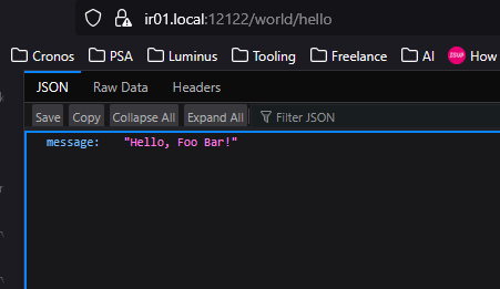

API ingress
If you are not happy with calling your localhost, you can also create an extra Ingress to the integration runtime
#ir01-ingress.yaml
kind: Ingress
metadata:
  namespace: ace-demo
  annotations:
    nginx.ingress.kubernetes.io/backend-protocol: "HTTP"   # use "HTTPS" if you point to 7843 instead
spec:
  rules:
  - host: ir01.local
    http:
      paths:
      - path: /
        pathType: Prefix
        backend:
          service:
            port:
              number: 7800            # or 7843 if you want HTTPS to the pod
Apply it
k apply -f .\ace\ir01-ingress.yaml
Add the hostname to your Windows hosts file (from elevated prompt)
Add-Content "$env:SystemRoot\System32\drivers\etc\hosts" "`n127.0.0.1`tir01.local"
Let’s expose port 443 locally on 12122
k -n ingress-nginx port-forward svc/ingress-nginx-controller 12122:443
Forwarding from 127.0.0.1:12122 -> 443
Forwarding from [::1]:12122 -> 443
And finally, test the entire setup by pointing our browser to https://ir01.local:12122/world/hello
Success!
