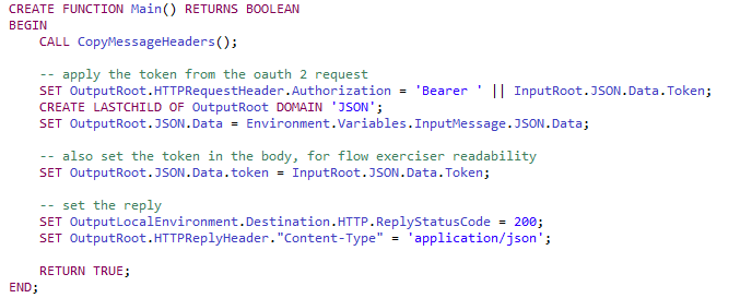

Flow Setup 1: Using the Environment
Copying an incoming message into the Environment feels like the easiest trick in the book. One line of ESQL—job done. But here’s the catch: it’s not parser-aware. In some cases you get away with it, but when JSON arrays are involved, things get messy fast. Arrays collapse into objects, metadata disappears, and suddenly your “quick fix” becomes a late-night debugging session.
Case in point: our demo flow.

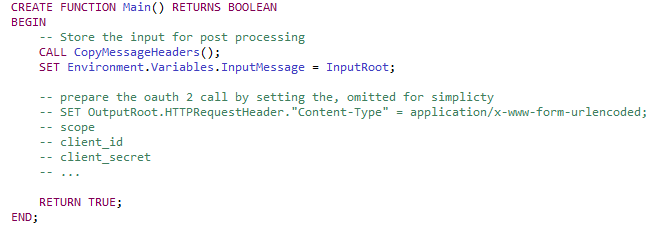

The input message is stored in the Environment, specifically Environment.Variables.InputMessage. The actual message is restored at the end.

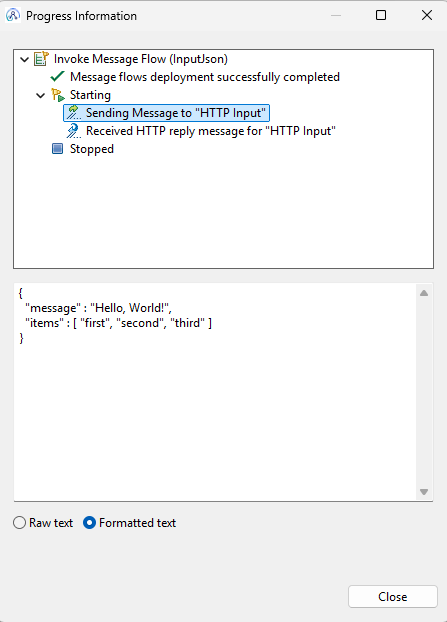

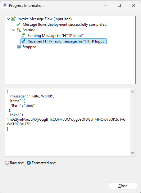

If we then compare the input vs the output message:
The token has been added (to the message, for visibility inside the flow exerciser), but you can see that the items array has collapsed into a single field containing the last array element.

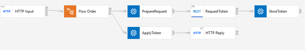

Flow Setup 2: Using the FlowOrder Node
Up until recently, using the FlowOrder node was the only way I knew that gave consistent results. The setup is rather simple if you think about it. Instead of doing everything serially, FlowOrder allows you to define different logical processing branches. Take the flow below as an example.

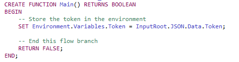

This flow has two branches: the top handles token requests, the bottom calls the API. Think of them as two separate functions working in sequence, which means they need a way to pass information between them. The cleanest approach is to put the token into the Environment, since it’s just plain values without parser context attached. I have no issue using the Environment,it’s a solid place to keep state, just not for anything that depends on the parser.
The top branch prepares the OAuth request (or it would, if this were not a dummy setup) and stores the received token in the Environment.

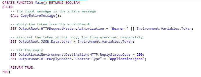

The bottom branch starts from the original input message, adds the token to the Authorization header (and to the body for debugging purposes), and sends the message to the API endpoint.

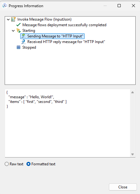

You can clearly see the intact input message with the added token.

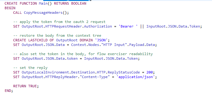

In practice, you don’t need to configure or enable anything special. As soon as you reference the Context tree in ESQL, ACE populates it at runtime. That means you can simply grab the payload from the input node and copy it back into OutputRoot, then add your token. The flow looks very much like the one we started with:

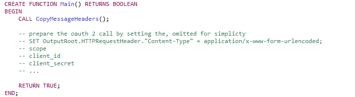

The difference is in the Compute nodes. The PrepareRequest Node generates the token request—nothing more.
The RestoreMsg Node is the one that calls upon the Context Tree.

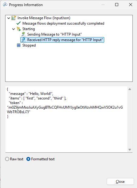

Finally, let’s compare the input and the output message:
Proper JSON with the added token.

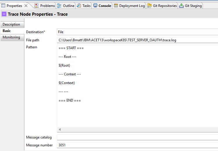

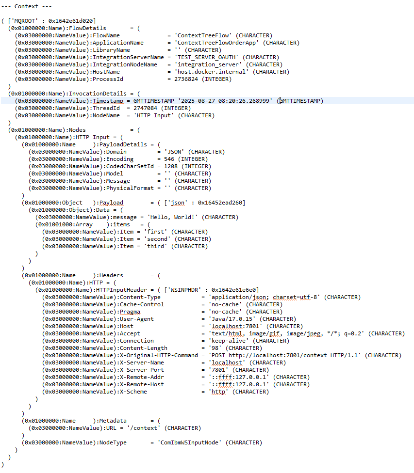

To show how the Context tree builds up, I added a Trace node. I wired it to the Input and last Compute nodes to capture the tree at different stages.
The Trace node configuration:
Immediately after the HTTP Input node, the Context tree only contains information about the Input node.

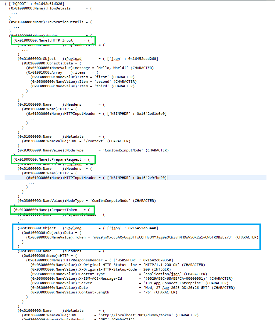

Further down the flow, you can see the tree filling up with each node:
The green blocks show the nodes you already passed with their metadata. The blue Payload blocks show the messages the RestRequest node received. The Context tree keeps on building until processing in your flow stops, giving you context about all the nodes that came before.

Thanks for writing this blog post and it is good to see a detailed example of one of the main uses of context trees in ACE flows outside of designer connector functionality.   It is worth noting that when a message flow deals with subflows then the ESQL Context correlation name is scoped to the nodes within the subflow. This means if the input node is outside of the subflow then trying to access it using the Correlation name will not work. So in the example on this post the path:
SET OutputRoot.JSON.Data = Context.Nodes."HTTP Input".Payload.Data;
would not reference the "HTTP Input" node outside of a subflow. For this reason ESQL also has a CONTEXTREFERENCE function which can access Context content outside of a current subflow. So changing the ESQL to be:
SET OutputRoot.JSON.Data = CONTEXTREFERENCE("HTTP Input").Payload.Data;
Would access an input node even if called within a subflow.
In ACE 13.0.5.0 (which has just been released) we have extended the CONTEXTREFERENCE function to also take keywords such as:
SET OutputRoot.JSON.Data = CONTEXTREFERENCE("HTTP Input" PAYLOAD).Data;
We have also added the CONTEXTINVOCATIONNODE function that can access the input payload from the input node without needing to know its name. So the following ESQL can now be used:
SET OutputRoot.JSON.Data = CONTEXTINVOCATIONNODE().Payload.Data;
Or
SET OutputRoot.JSON.Data = CONTEXTINVOCATIONNODE(PAYLOAD).Data;
If the input node itself is inside a subflow and the flow propagates out of that subflow then the input node context tree section will not be visible to the Context correlation name or the CONTEXTREFERENCE function. This is because on exit of a subflow the Tree passed to the subflow output terminal node is now associated with the subflow node that is being propagated out of. So such a flow would have a Context Tree that starts with the subflow node. In this case the new CONTEXTINVOCATIONNODE function can always access the input nodes Context tree section.
