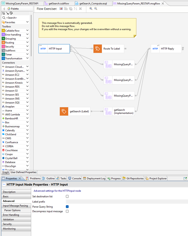

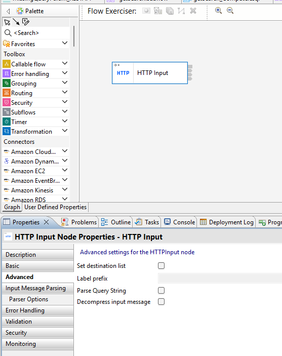

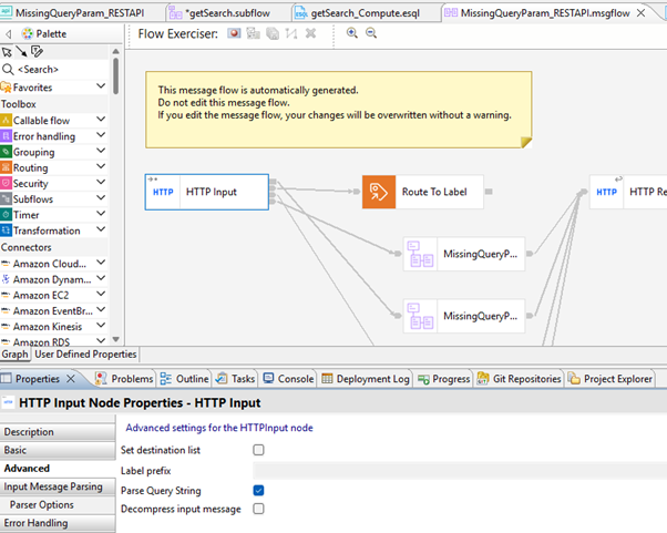

Parse query string

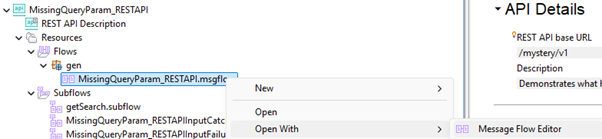

The most obvious of suspects can be verified simply by looking at the HTTP Input node. Open the message flow with the message flow editor
And take a look at the Parse Query String option in the Advanced options group. This one was checked.

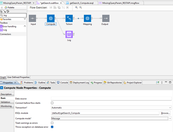

Compute mode
Second suspect: the Compute mode of the Compute Node. If an upstream Compute Node is set to a Compute mode that includes the LocalEnvironment, make sure the InputLocalEnvironment is actually being copied over to the OutputLocalEnvironment.
No issue here, these settings are ok.

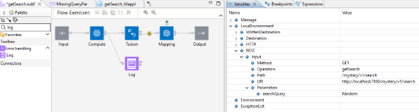

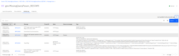

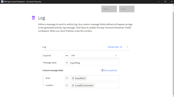

Looking further at the flow, the LocalEnvironment gives us a clue. You can check the LocalEnvironment via a number of ways.
1. You can debug the flow
2. You can use the flow exercises
3. You can use the Log Node
Or any other way that prints the LocalEnvironment (such as a trace node).

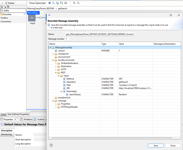

Now, looking at that last screenshot, you can notice that the REST LocalEnvironment (REST.Input.Parameters) only contains 1 parameter
"REST":{"Input":{"Method":"GET","Operation":"getSearch","Path":"/mystery/v1/search","URI":"http://localhost:7800/mystery/v1/search","Parameters":{"searchQuery":"Random"}}
But if you have another look, you can also see an HTTP LocalEnvironment (HTTP.Input.QueryString), that does contain both query parameters.
HTTP":{"RequestIdentifier":"4556485400000000000000007954e6169c14180000000000"},"RouterList":{}},"HTTP":{"Input":{"Path":{"Segment":["mystery","v1","search"]},"QueryString":{"searchQuery":"Random","index":"1"}}

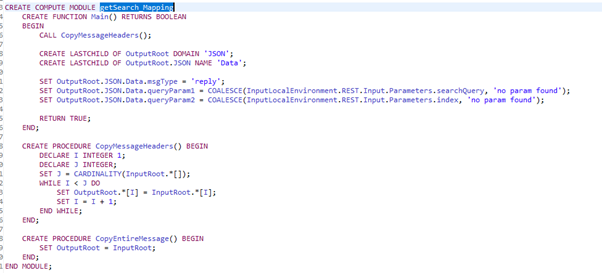

Exhibit A: REST vs HTTP in Action
Let’s not speculate, let’s test.

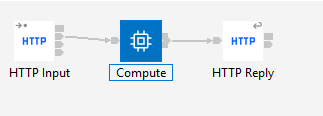

To really understand how ACE handles HTTP traffic under the hood, I set up two flows:
  • One is using a REST API defined via OpenAPI YAML.
  • One is using a plain old HTTP Input node.
The goal? To see exactly how each flow handles:
  • Query parameters (defined vs undefined)
  • HTTP methods (allowed vs blocked)
  • LocalEnvironment structure
  • Error handling
This isn’t theory, it’s fieldwork. And as we’re about to see, the differences aren’t so subtle.

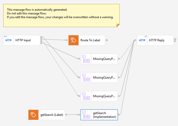

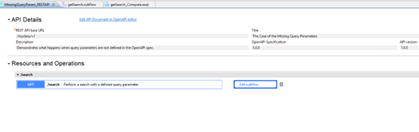

REST API
Setup
Outcome

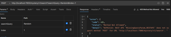

As you can see from the screenshots above:
  • Undefined methods are blocked, based on the yaml specification.
  • Undefined query parameters are not passed on to the REST LocalEnvironment

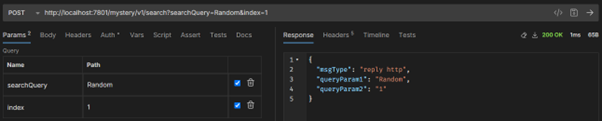

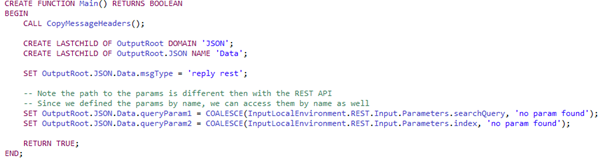

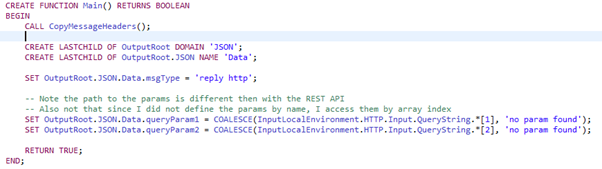

HTTPInput
Setup
Outcome
  • Unless you explicitly block them, undefined methods go through without a hitch.
  • All query parameters are passed on to the HTTP LocalEnvironment

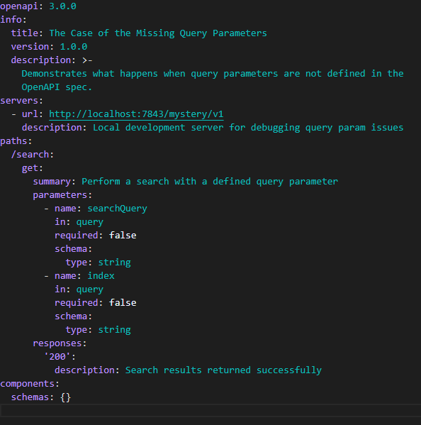

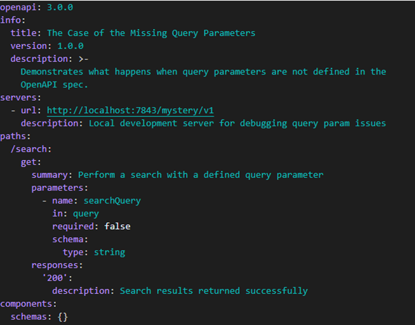

The Overlooked Clue: The OpenAPI Spec
The real issue? One of the query params was never defined in the OpenAPI YAML.
If they’re not in the spec, they don’t exist, at least not to REST API flow.

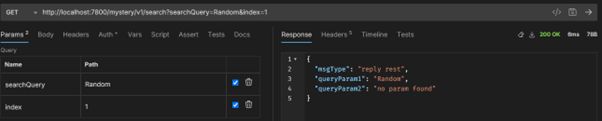

Here's the actual difference in LocalEnvironment output between REST and HTTP
// REST.Input.Parameters
  "searchQuery": "Random"
// HTTP.Input.QueryString
  "searchQuery": "Random",
  "index": "1"
Matches the API definition
The Smoking Gun: One Line That Fixes It All
A simple addition to the OpenAPI file that would’ve made it all work, adding the second parameter.
# The missing line in OpenAPI
        - name: index
          in: query
          required: false
          schema:
            type: string
Giving the final OpenAPI definition

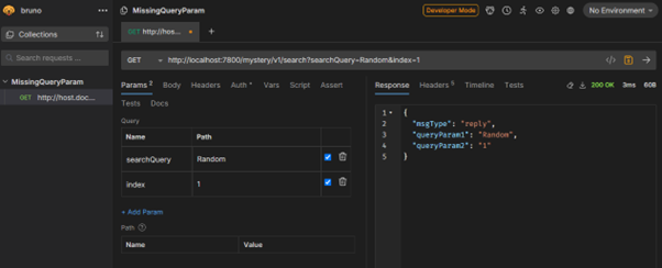

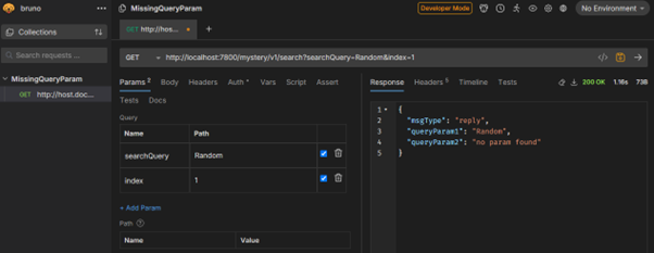

Running the call again, this time with the updated REST API.
And success! We solved the case.
