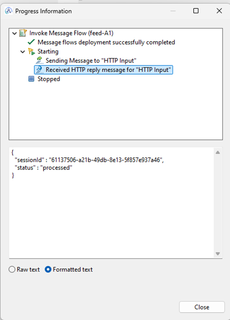

1. Start the Flow Exerciser and send a test message through (a test message is available in the code project).
2. Check the Response, ensure that you don’t receive an error from your flow and that your response looks like this
