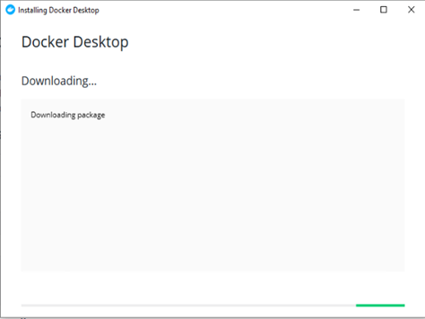

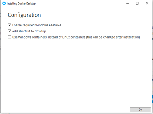

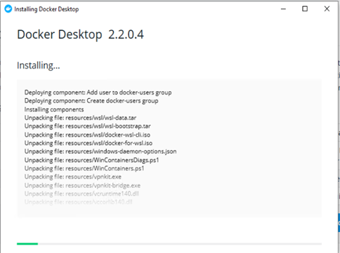

Step 2(Windows 10) : Install Docker
Download and install your favorite supported version of docker. I got mine from the Docker website.
Click on “Download From Docker Hub”
Click on “Get Docker”
Run the executable.
Let it download.
Be sure to leave “USE WINDOWS CONTAINERS INSTEAD OF LINUX CONTAINERS” unchecked.
The Cognos Jupyter containers are ubuntu.

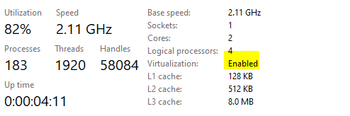

Note: Some pitfalls here include the fact that nested virtualization may be needed.
You need to make sure that under Task Manager > Performance tab that it indicates Virtualization is Enabled.
In order to assure this, before I started and connected to the VM on the machine hosting the VM, I ran the following commands in powershell:
  1. Enable-WindowsOptionalFeature -Online -FeatureName Microsoft-Hyper-V -All -Verbose
  2. Enable-WindowsOptionalFeature -Online -FeatureName Containers -All -Verbose
  3. bcdedit /set hypervisorlaunchtype Auto
  4. Set-VMProcessor -VMName <Enter-VM-Name> -ExposeVirtualizationExtensions $true -Verbose
  5. net stop vmms
  6. net start vmms

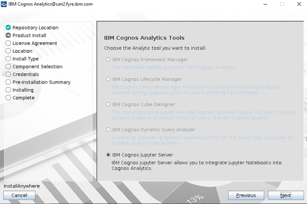

Step 3: Install Jupyter
Navigate to the installers
cd /tmp/installers

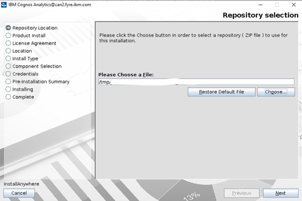

Run the installer
./ ca_instl_lnxi38664_2.0.191205.bin
Select the /zip repository in the installers directory recently created:
Please note, if you receive the following error, you likely do not have enough disk space on the server:
Error processing tar file(exit status 1): write /opt/*****: no space left on device
Around 35 GB of available space is needed for the images once completed, this does not include the intermediate/temporary space that docker requires for various layers during the install. Verify and allocate a minimum of 60 GB of space to the /var/lib/docker/ directory to run the install with no issues.

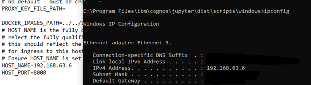

Step 4 (Windows) : Configure Jupyter
Navigate to the install location. You can do this in file explorer or by cd’ing there in a command prompt.
By Default: C:\Program Files\ibm\cognos\jupyter\dist\scripts\windows
Edit the config.conf file making the HOST_NAME variable set as either the fully qualified hostname or the IP address of the Jupyter server.  This should be reachable by the cognos server.

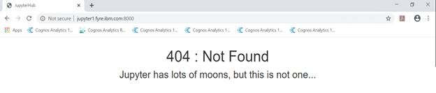

When this has started up correctly you should see the following entry within the install.sh start up:
Check the containers are running
docker ps
If you paste this in the browser, you should be able to see the following message, which indicates your browser can successfully communicate with the Jupyter server. This is not an error code, this is expected.
http://servername:8000

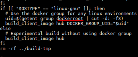

groupadd: invalid group ID 'docker'
The command '/bin/sh -c groupadd --gid $DOCKER_GROUP_UID docker &&   usermod -aG docker $NB_USER &&   gpasswd -a $NB_USER docker' returned a non-zero code: 3
cd to the build script
cd /opt/ibm/cognos/jupyter/dist/scripts/unix/
edit the build file
nano build.sh
Resolve this by changing the docker group to dockerroot in the group id section like this:

For the Jupyter service location place the URL that was specified on start-up during step 7.
http://jupyter1.fyre.ibm.com:8000
Be sure not to include a trailing slash here.
Click apply and refresh the browser (you may need to clear cache and start a new session)

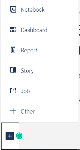

Click on New > Notebook
And test your notebook!
