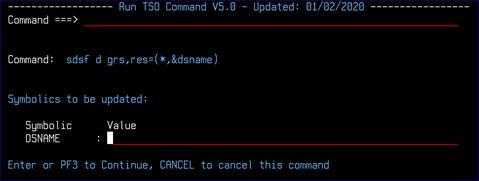

And this is an example of using a symbolic in a command:
When a symbolic is recognized and it is not one of the supported symbolics then the user is prompted to fill in the value thus:
Having filled in sys1.parmlib in the entry field we get these results in the RUNC report:

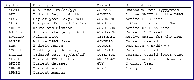

The set of pre-defined symbolics supported are:
