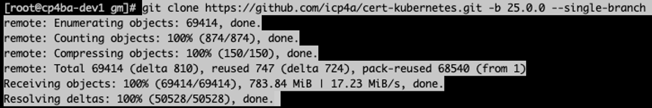

2.     Download the cert-kubernetes from github. For this blog we are doing 25.0.0 Fresh production Deployment with separation of duties, so let’s switch to 25.0.0 branch.
Migrate to any folder in your infrastructure node of Openshift cluster and download the github repository.
git clone https://github.com/icp4a/cert-kubernetes.git -b 25.0.0 --single-branch
