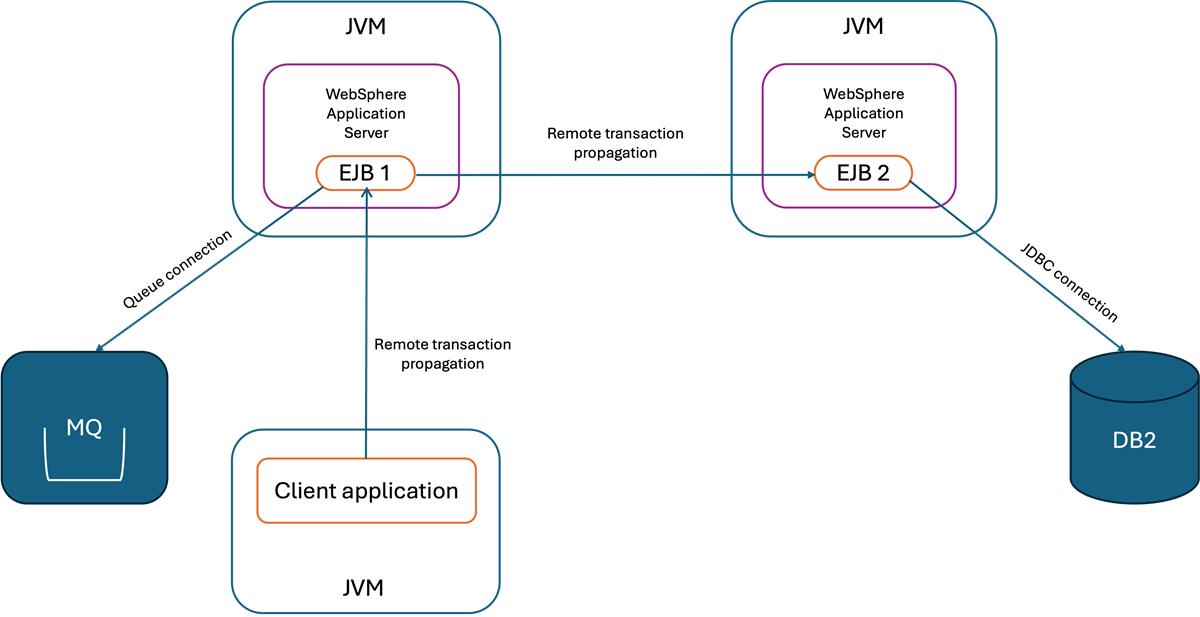

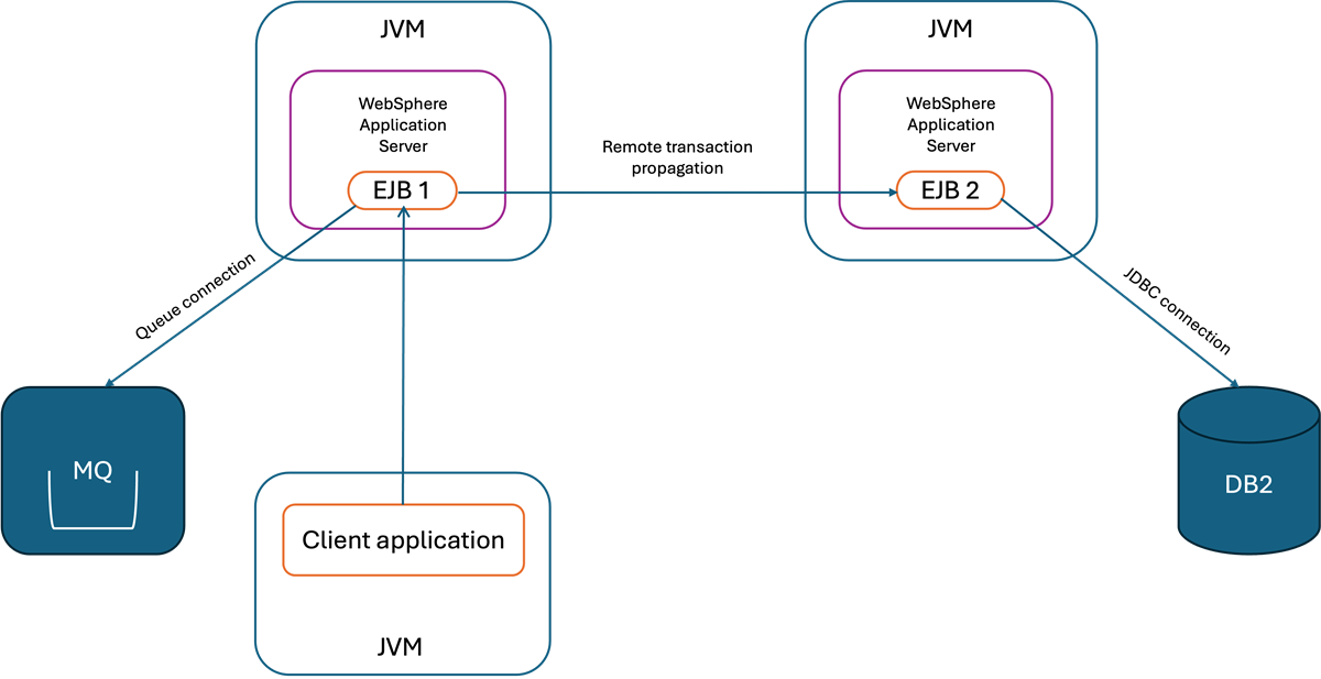

What is remote transaction propagation?
The following diagram illustrates remote transaction propagation: an EJB (EJB1) calling another EJB (EJB2) from a different JVM.
If the call is between two remote EJBs that are running in the same JVM, the call and transaction propagation are local. In these cases, the application can use transaction propagation on Liberty without any changes. This is the case for most applications.
If, however, the call is between two remote EJBs that are running in separate JVMs (as shown in the diagram), the transaction propagation is remote, so you must modify the EJB and client applications before they can run on Liberty. It might be possible to migrate some of the applications, such as EJB1 and EJB2 in the diagram, to run in the same JVM so that calls between them are local. Otherwise, you would modify both EJBs.
