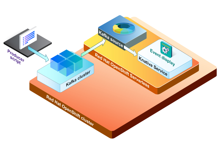

Now that you're familiar with the core components of OpenShift Serverless—Serving, Eventing, and Functions—let’s walk through a practical example. In this section, we will demonstrate how to build a simple serverless application that reacts to events from an Apache Kafka cluster.
Figure 1 illustrates the architecture and flow of the application, showing how messages from a producer are routed through Kafka and processed by a Knative service.
Application flow
Figure 1: Application flow

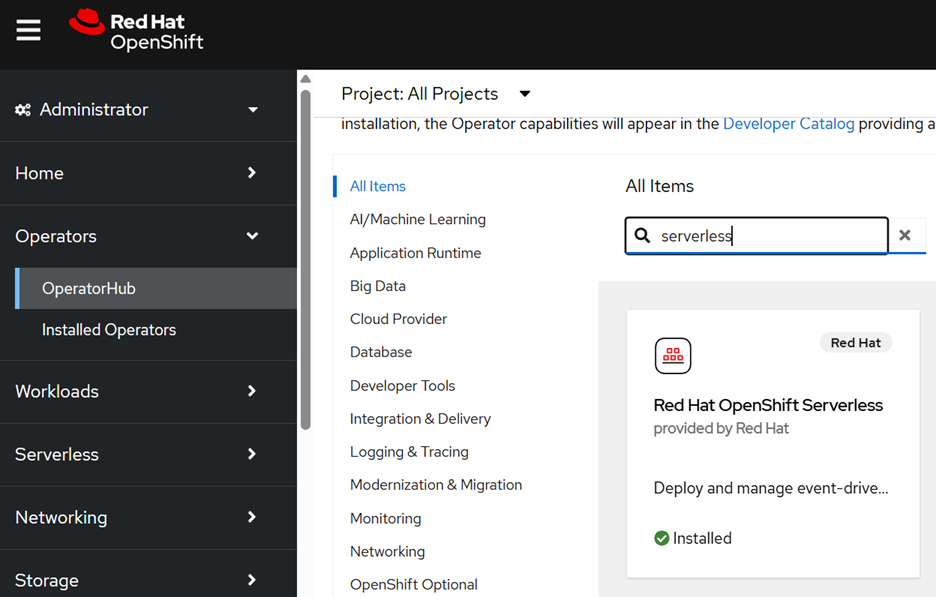

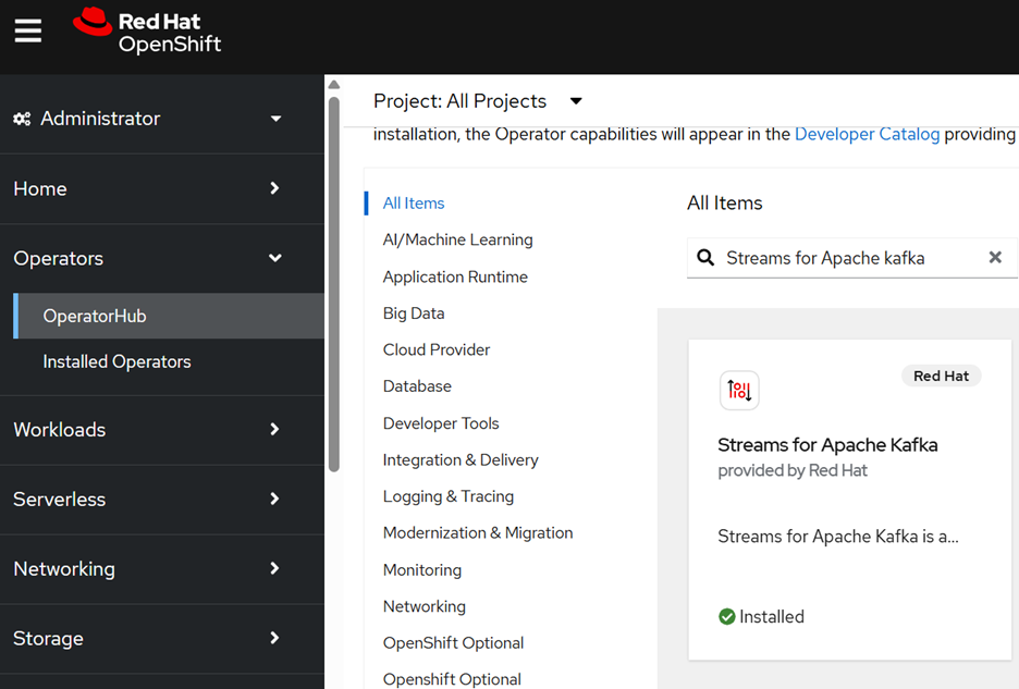

Step 2: Install Streams for Apache Kafka and OpenShift Serverless operators.
  1. Open the Red Hat OpenShift console.
  2. Click Operators > OperatorHub. On the All Items page, type Streams for Apache Kafka in the search field and follow the onscreen instructions to install the application.
    OperatorHub
    Figure 2: OperatorHub
  3. Follow the instructions provided in the previous step to install Red Hat Serverless.
    OperatorHub
    Figure 3: OperatorHub

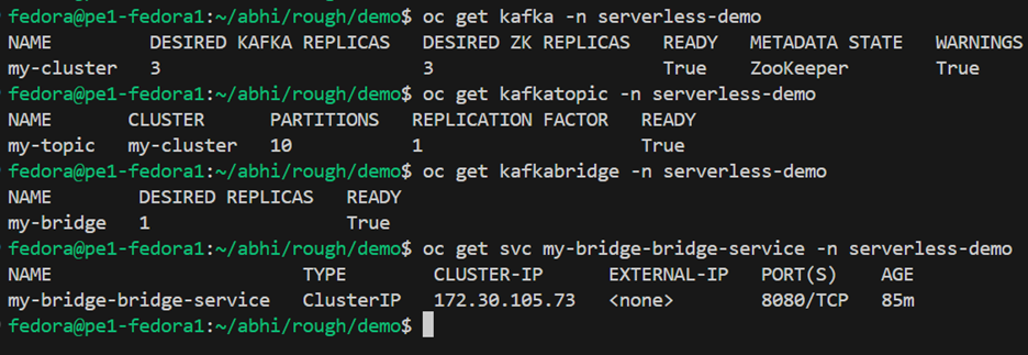

    Deploying the Kafka Bridge also creates a service named my-bridge-bridge-service.
    OperatorHub
    Figure 4: my-bridge-bridge-service

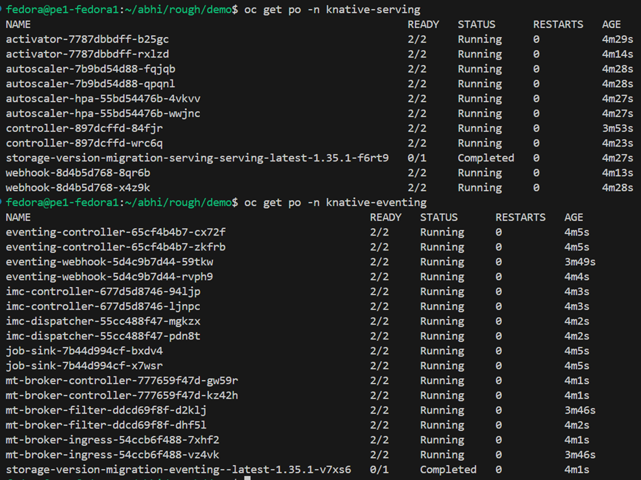

Step 5: Verify the Knative instances.
Run the following commands to verify Knative instances. All the component pods should either be in Running or Completed status of Knative Serving and Eventing.
oc get po -n knative-serving
oc get po -n knative-eventing
knative serving and knative eventing
Figure 5: knative-serving and knative-eventing

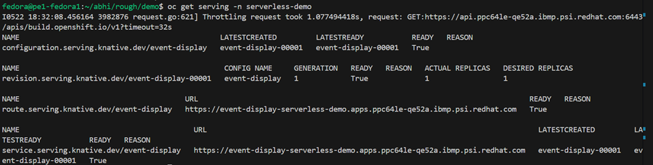

Step 7: Verify the Knative Serving instances.
Applying the application service configuration given in the previous step creates route, service, revision, and other configuration as part of Knative Serving. Verify these Knative Serving components using the following command:
oc get serving -n serverless-demo
knative serving instance
Figure 6: Knative Serving instance

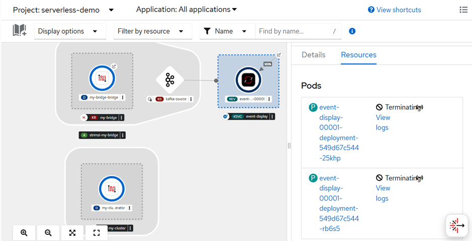

Visualize the earlier sample application
The Topology of serverless-demo can be visualized before sending messages.
serverless-demo
Figure 7: serverless-demo
As shown in Figure 7, note that there are no pods of the event-display application. Pods will scale up when the script starts running.
serverless-demo
Figure 8: serverless demo

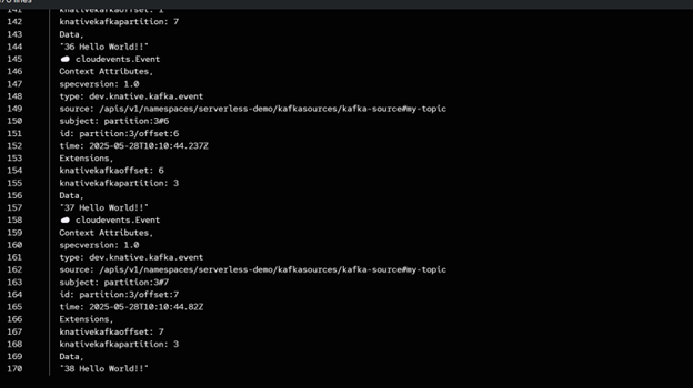

Monitor the logs generated by the producer script and observe one of the pods processing a CloudEvent message.
CloudEvent message
CloudEvent message
CloudEvent message
Figure 9: CloudEvent message
