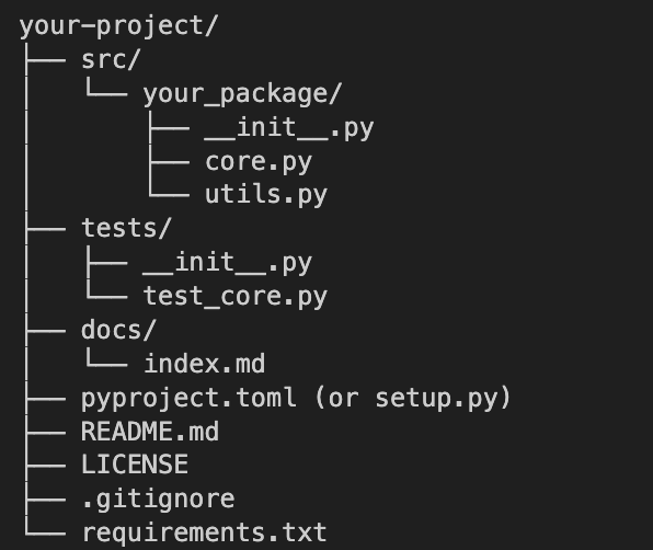

Project Structure
Once your environment is ready, organize your project structure. Successful project organization should follow these principles: clear structure (standardize your repository organization), modular design (separate code into logical modules with single responsibilities), test-driven development (include tests for each module), documentation (provide clear information for users and contributors), and examples (offer use cases to help users get started quickly).
A typical structure includes several key components: a src directory containing your package modules and source code, a tests directory for test files, and a docs directory for documentation; additionally, files such as pyproject.toml for project configuration and dependencies, requirements.txt for specifying project dependencies, README.md for project overview and usage instructions, LICENSE for open-source terms, and .gitignore to exclude unnecessary files from version control.

  5. Directory structure example
