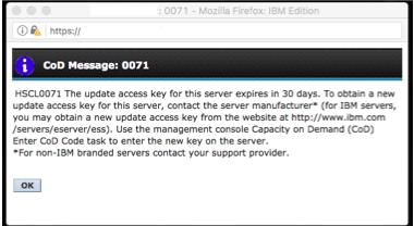

A message screen will be displayed to all users logged into the primary HMC as the "update access key" approaches expiration. This screen will be displayed at 30, 20, 10, 5, 4, 3, 2, and 1 day(s) before the "update access key" expires.  As previously stated, these warnings will only be seen by logged in users and can also be seen in the log history highlighted later in this blog.  The message will read:
CodMessage0072
"HSCL0071:The update access key for this server expires in {number} days.  To renew the hardware entitlement of this server, obtain a new update access key from the website http://www.ibm.com/servers/eserver/ess.  Use the management console Capacity on Demand (CoD) Enter CoD Code task to enter the new key on the server."

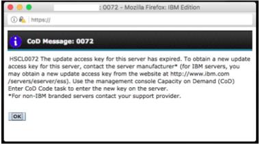

This HMC message screen will be displayed to all users logged into the primary HMC when the "update access key" expires. The expiration will also generate a service event which will be called home and will send out a notification.  The Message will read:
CodMessage00722
"HSCL0072: The update access key for this server has expired.  To renew the hardware entitlement of this server, obtain a new update access key from the website http://www.ibm.com/servers/eserver/ess.  Use the management console Capacity on Demand (CoD) Enter CoD Code task to enter the new key on the server"

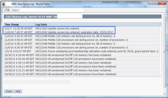

The expiration warnings and notice for the "update access key" will also be logged and can be viewed in the CoD History Panel.
CodHistoryLog
