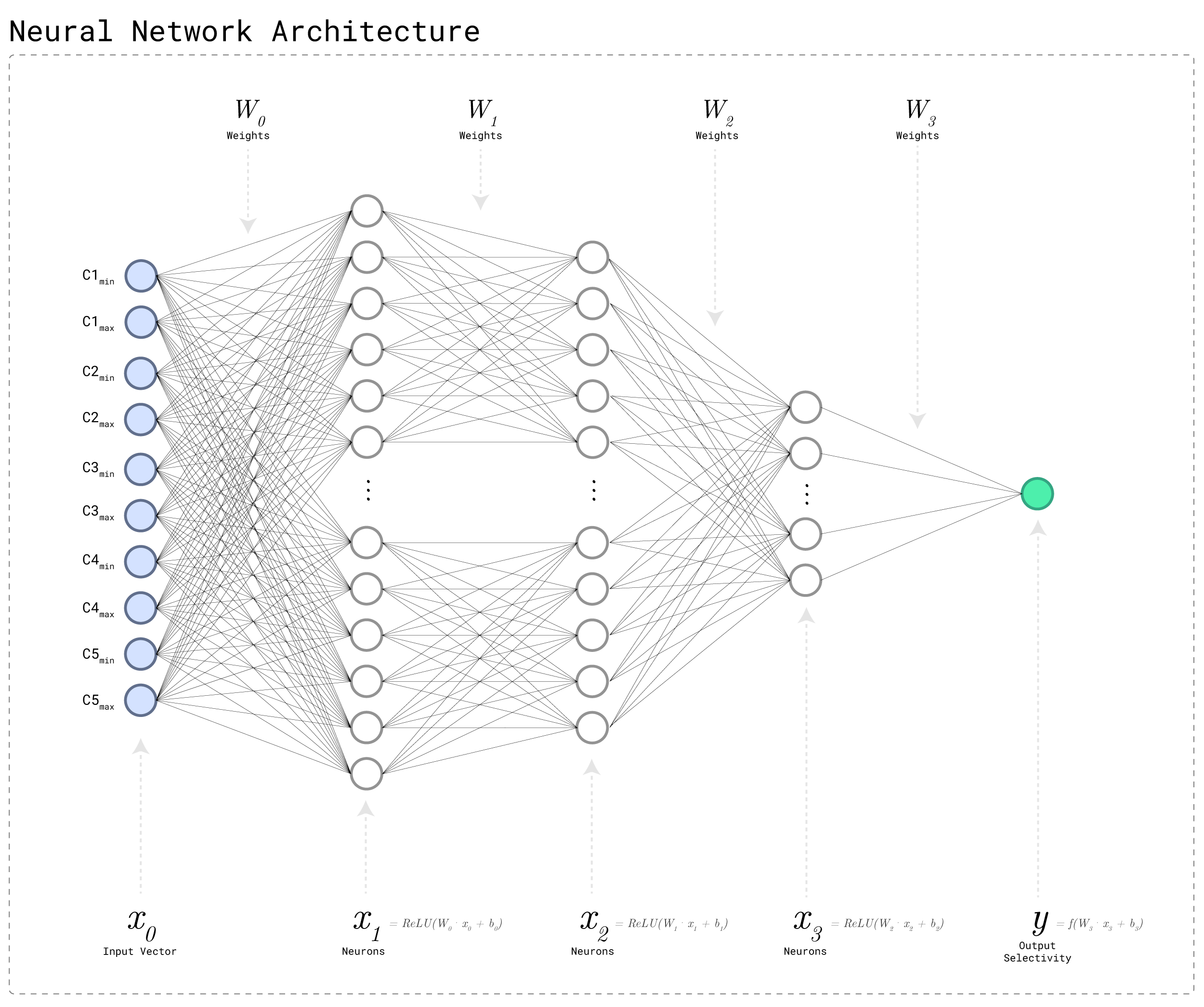

To understand why transfer learning is so effective, let's first examine what happens during neural network training from scratch. Recall the structure of the neural network used in the Db2 AI Query Optimizer:

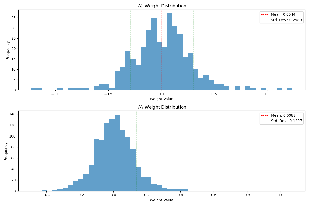

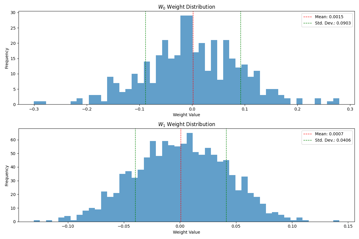

When we train a neural network from scratch, we start with randomly initialized weights following a normal distribution centered around 0.0. The image below shows a sample random distribution of weights for the first 2 layers of an AI Query Optimizer neural network for the TPCDS schema INVENTORY table, where 4 columns are included in the model:
As training progresses, the network adjusts these weights to minimize prediction errors. By the end of training, the weights still maintain a roughly normal distribution, but with some important differences.
Notice that while the distribution remains centered near zero, it has:
- Spread out slightly, with a wider variance
- Developed some outliers - weights with significantly larger positive or negative values

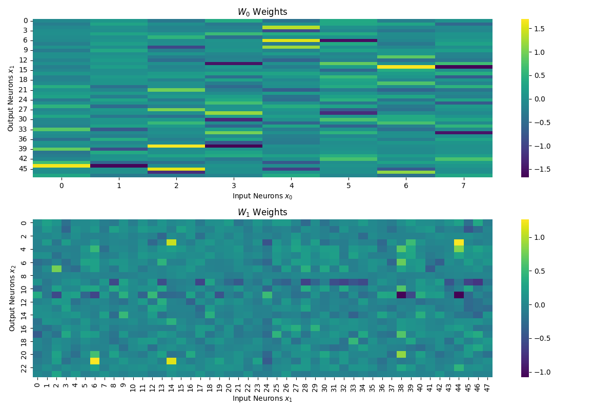

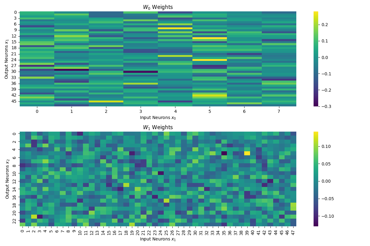

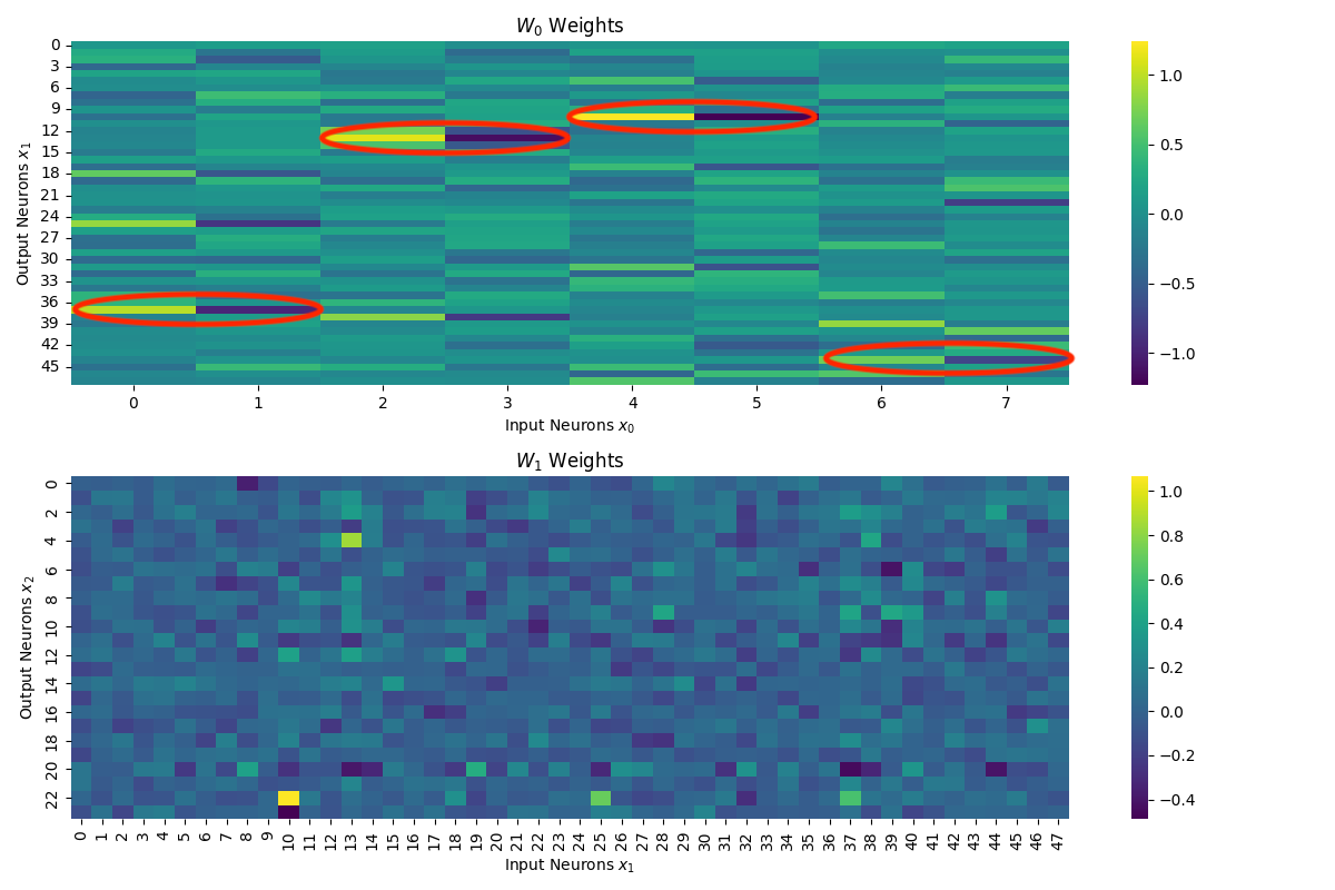

Let's look at a different visualization of the neural network weights, a heatmap. This visualization shows the magnitude of the weights, with bright yellow indicating larger positive values and dark blue indicating larger negative values. At the start of training we can see that the colours are randomly distributed, with no clear structure or patterns:
During training, some interesting patterns start to emerge in the heatmap representation, and by the end of training the heatmaps for the first 2 layers are as follows:
We can see that the first layer weights have formed specific patterns that capture the underlying data relationships. In this case, we observed one very interesting pattern in particular (highlighted in red) in the first layer weights where one neuron would develop a larger positive weight value, while an adjacent neuron would develop a larger negative value. This pattern emerged consistently across trained models and represents the network learning to detect important features in the underlying data. Recall from our neural network architecture that each 'pair' of inputs ([0,1], [2,3], [4,5], [6,7]) represents 'min' and 'max' values for a single table column, and from the heatmap we can see that the trained network has learned about this relationship.
For the second layer, it's hard (at least for humans!) to discern any specific patterns in the layer weights. However, we can see that the weights are no longer random, suggesting the trained network has learned something from the training data. Most values are clustered around zero, and there are a select few larger positive and negative values. Subsequent layers showed similar patterns, with most weights clustered around zero, and a few larger positive and negative values.
These "learned patterns" in the weight distribution (even if we can't always detect them with the naked eye) are what make the neural network effective at its task.

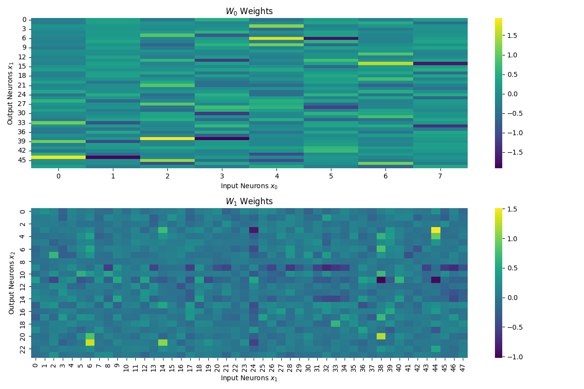

With transfer learning, we start with weights that already have a more structured distribution and contain meaningful patterns:
The fine-tuning process preserves most of the useful patterns from the pre-trained model while adjusting specific weights to better fit the current table's data characteristics:
Notice how the fine-tuned model preserves much of the structure from the pre-trained model while making targeted adjustments. This visual representation helps explain why transfer learning is so efficient - it's building upon existing knowledge rather than learning everything from scratch. This is why transfer learning can achieve similar or better accuracy with significantly less training time.
