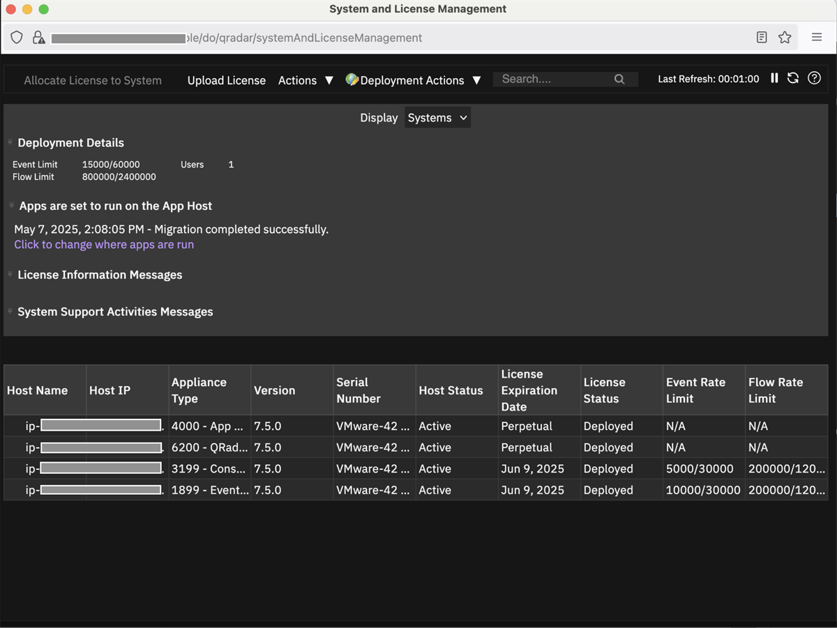

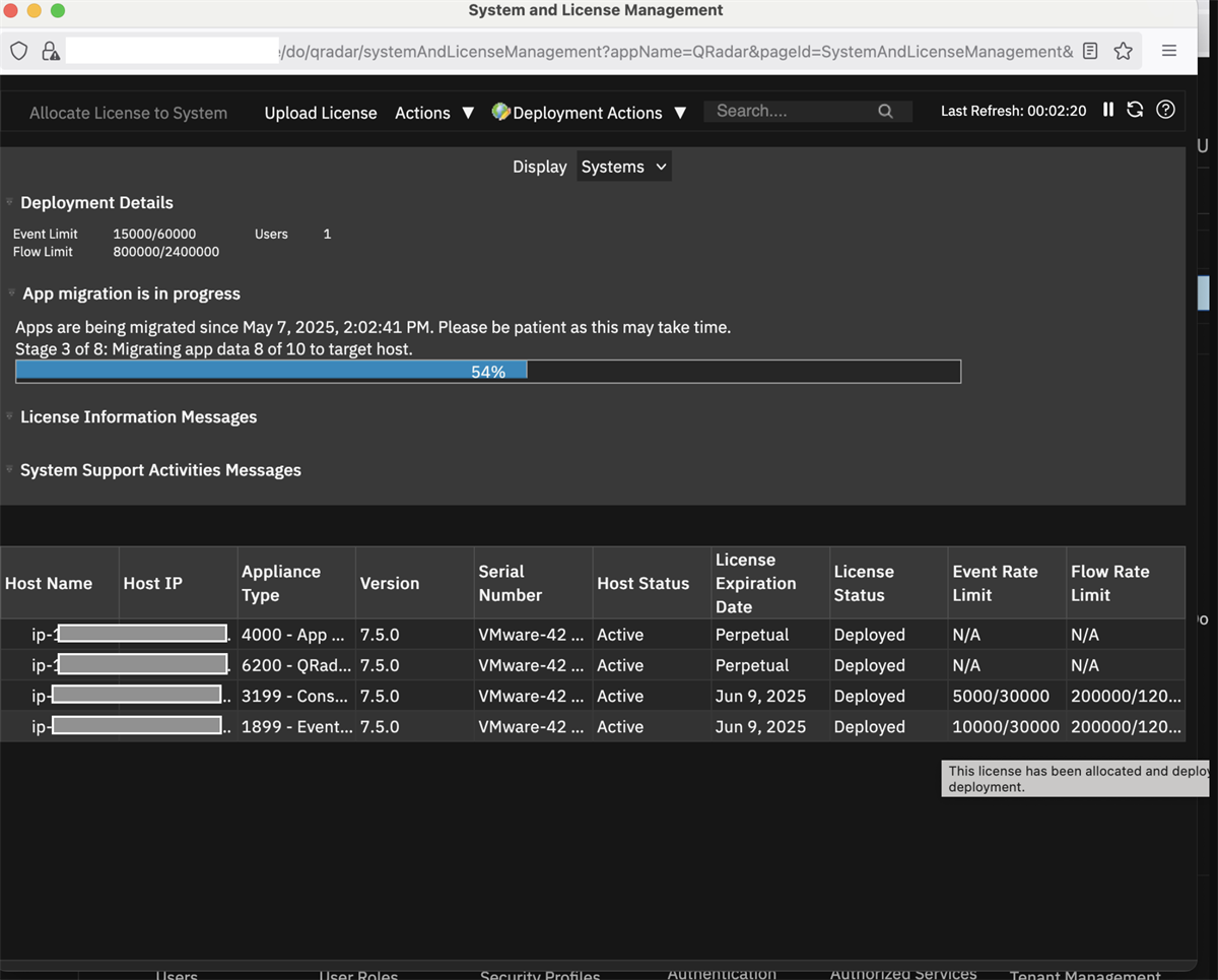

1. Login into QRadar UI - Go to System & License Management tab
2. Please click the link titled "Click here to change where apps are run" on this screen.
3. The apps will be migrated to the console as displayed in the  screenshot. Kindly wait for the migration to complete.
If the applications are hosted on the DR-site app host, a few additional steps are required before proceeding with failover/failback process. For detailed instructions, please refer to the corresponding IBM documentation.
