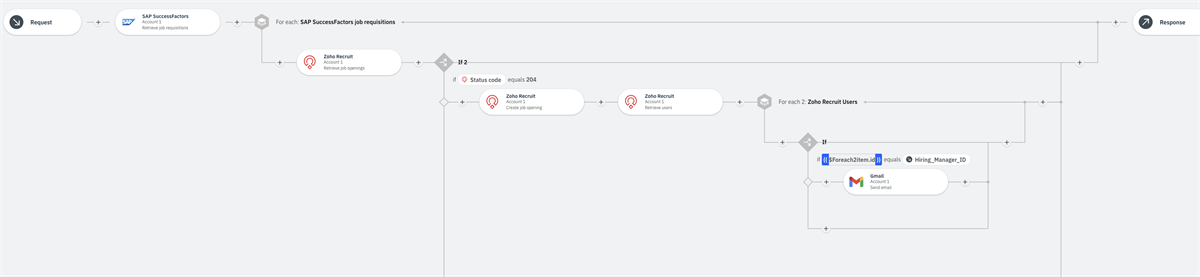

Scenario 1: Create a job opening in Zoho Recruit for job requisitions in SAP SuccessFactors
Consider the scenario:
In this flow, job requisitions from SAP SuccessFactors are retrieved and a job opening is created for each of the retrieved job requisitions. Then, an email is sent to the hiring manager with the details of the new job opening.
The following are the steps involved in the flow:

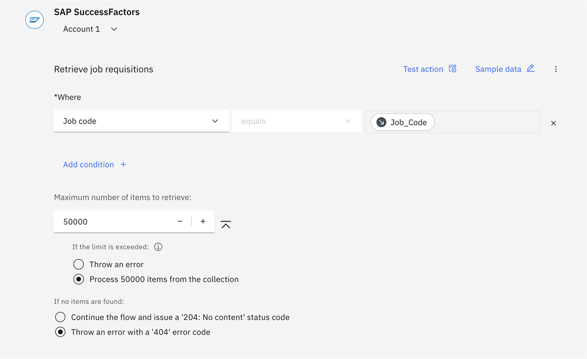

1.  Using the SAP SuccessFactors Retrieve job requisitions node, the flow retrieves the job requisitions from SAP SuccessFactors.

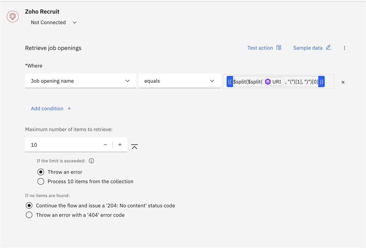

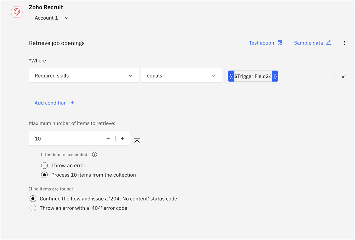

2. Using the Zoho Recruit Retrieve job openings node, the flow retrieves the job openings in Zoho Recruit.

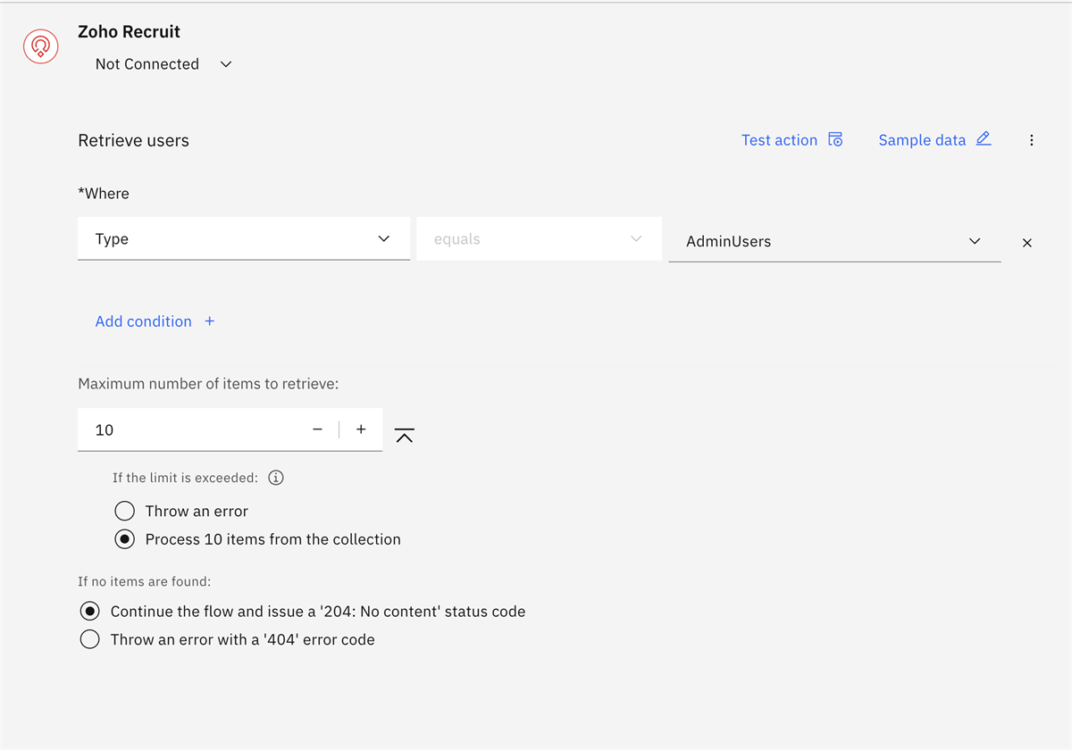

3. Using the Zoho Recruit Retrieve users node, the flow retrieves the users in Zoho Recruit.

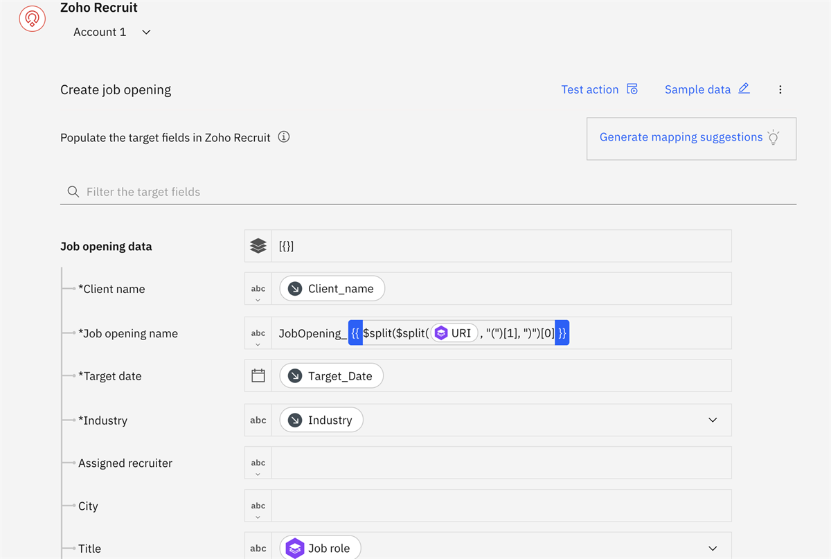

4. The flow verifies the job requisitions from SAP SuccessFactors in Zoho Recruit. If the job requisitions in SAP SuccessFactors do not exist in Zoho Recruit as job openings, the flow creates a new job opening in Zoho Recruit for each new job requisition.

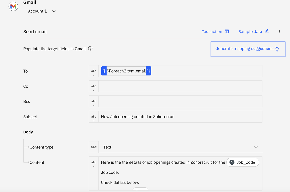

5. Using the Gmail Send email operation, the flow sends an email to the hiring manager with the details of the job opening created in Zoho Recruit.

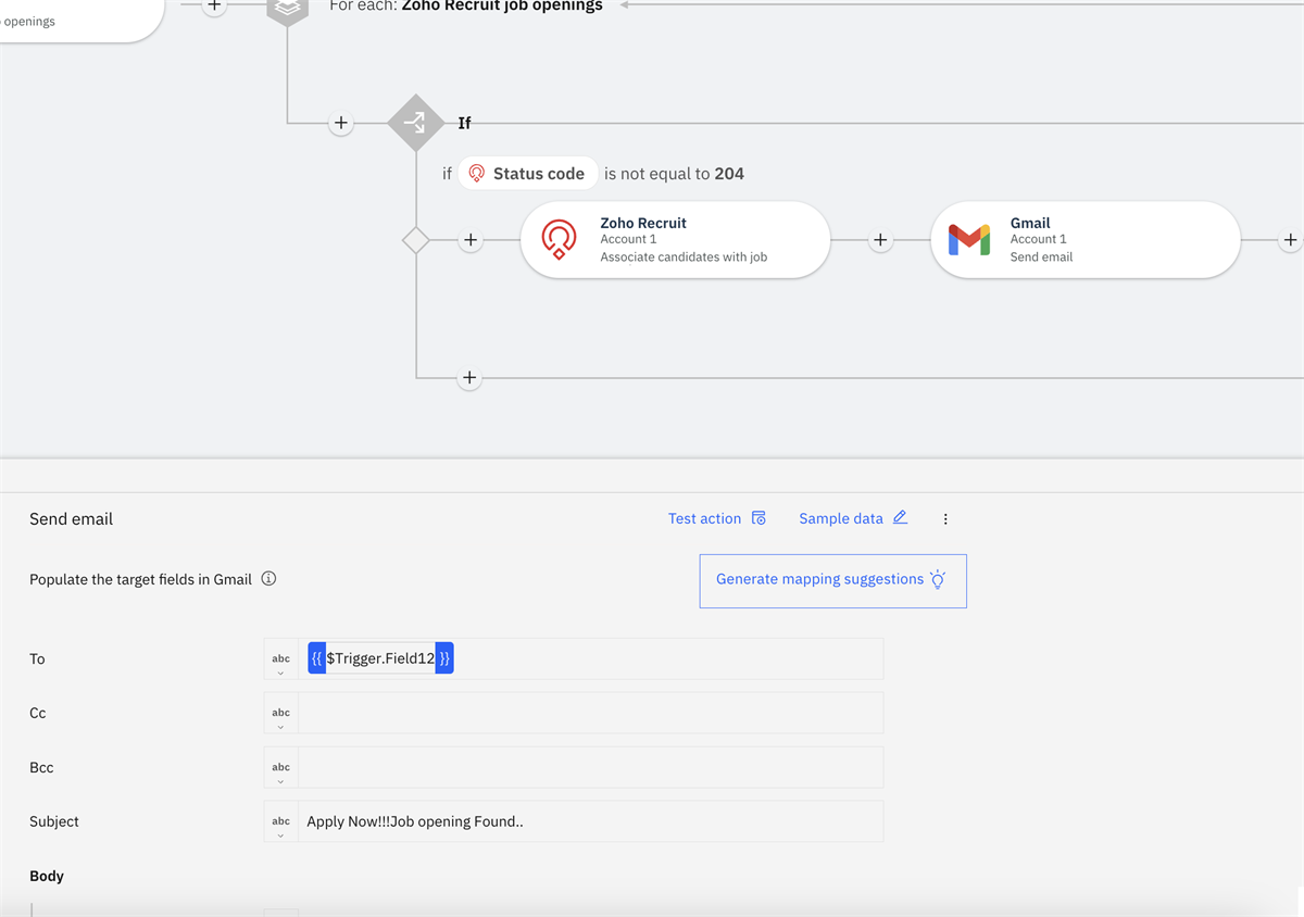

Scenario 2: Associate candidates with job openings in Zoho Recruit for each new Wufoo form entry

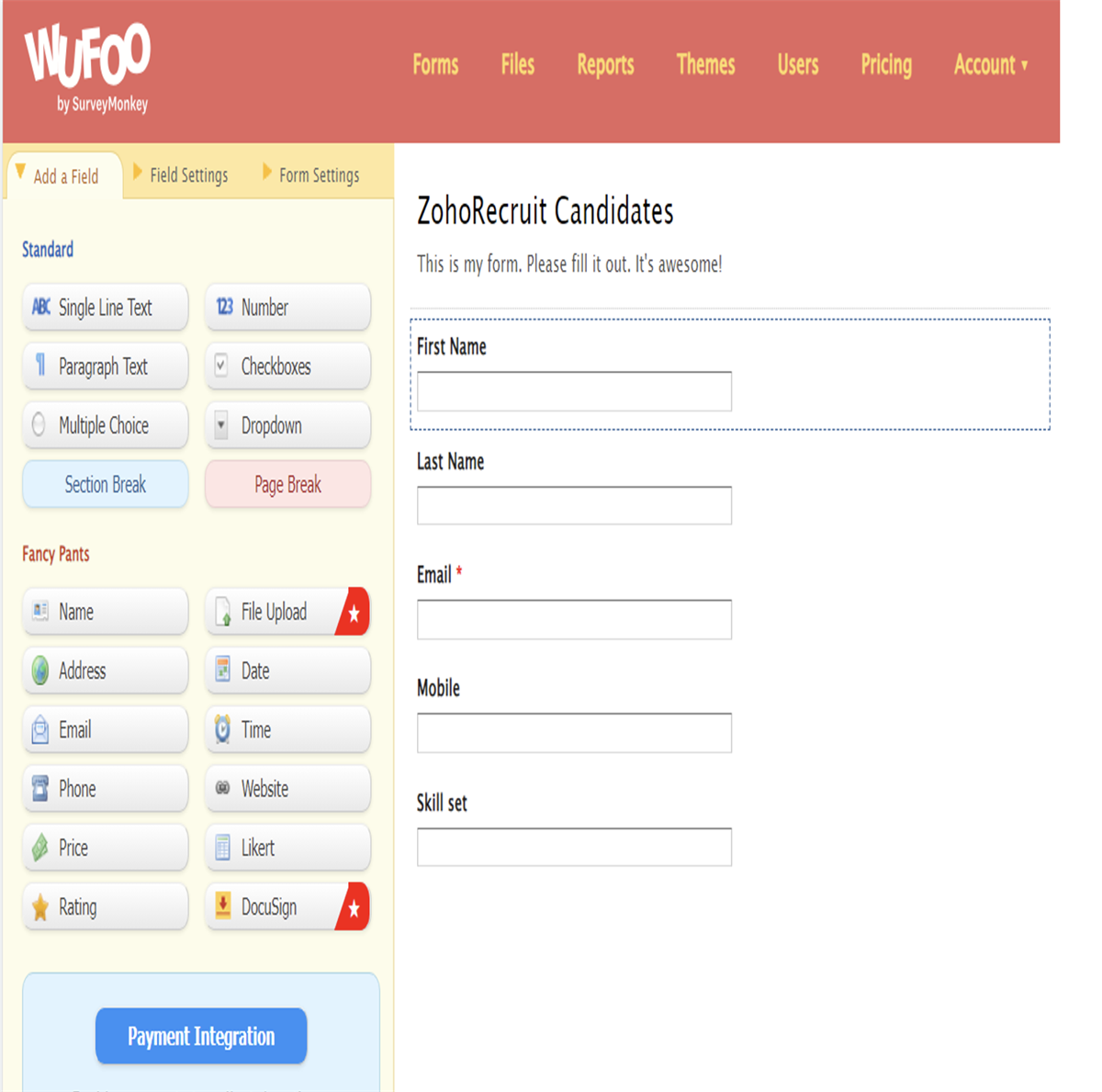

In this flow, when a new Wufoo form entry is received with candidate details, the flow creates a new Zoho Recruit candidate with the details and sends a mail to the candidate with the details of a job opening associated with their skill sets, as specified in the Wufoo form entry.
1. The flow retrieves the details of the new Wufoo form entry.

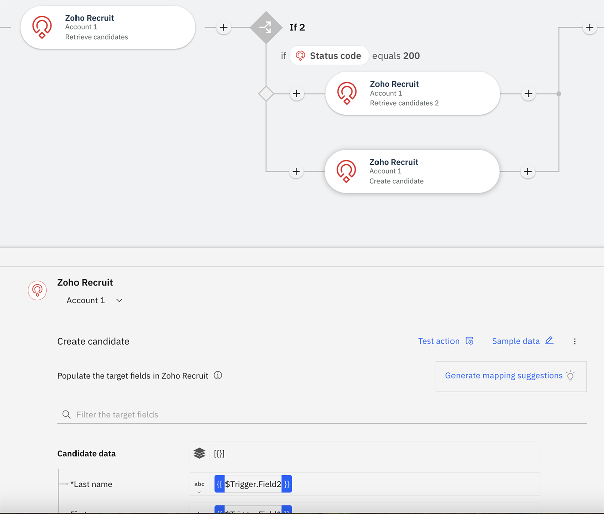

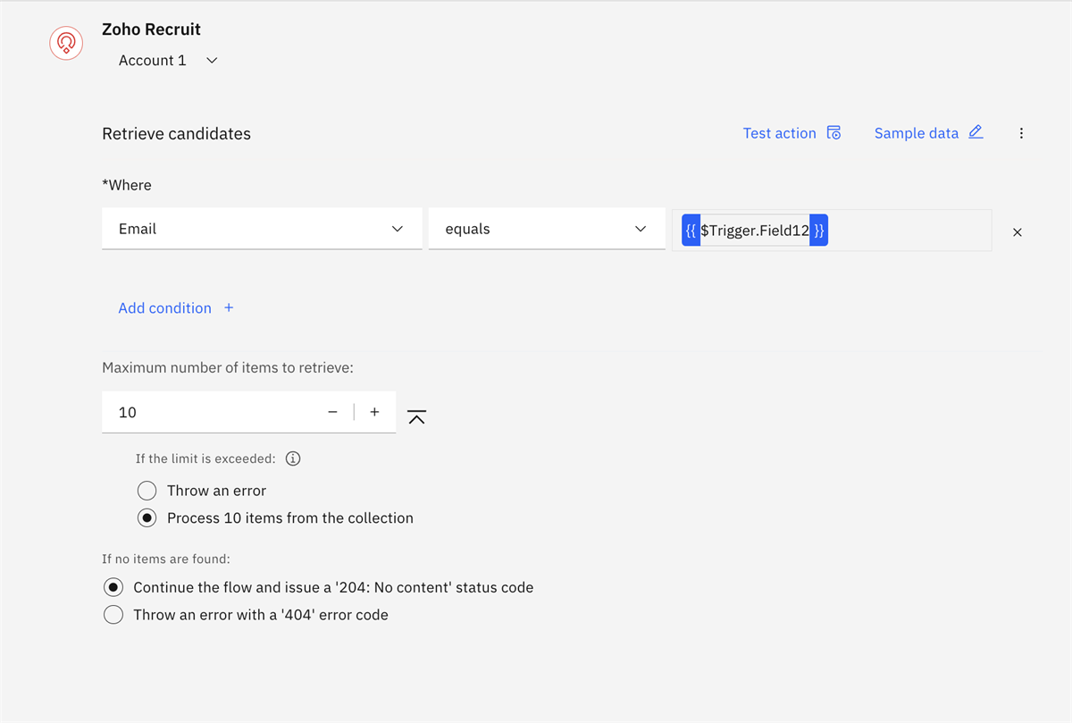

2. Using the Zoho Recruit Retrieve candidates node, the flow retrieves the candidates in Zoho Recruit.
3. The flow verifies the candidate details in Zoho Books. If the candidate from the Wufoo entry does not exist in Zoho Recruit, the flow creates a new candidate in Zoho Recruit.
4. Using the Zoho Recruit Retrieve job openings node, the flow retrieves the job openings in Zoho Recruit that are applicable to the new candidate.

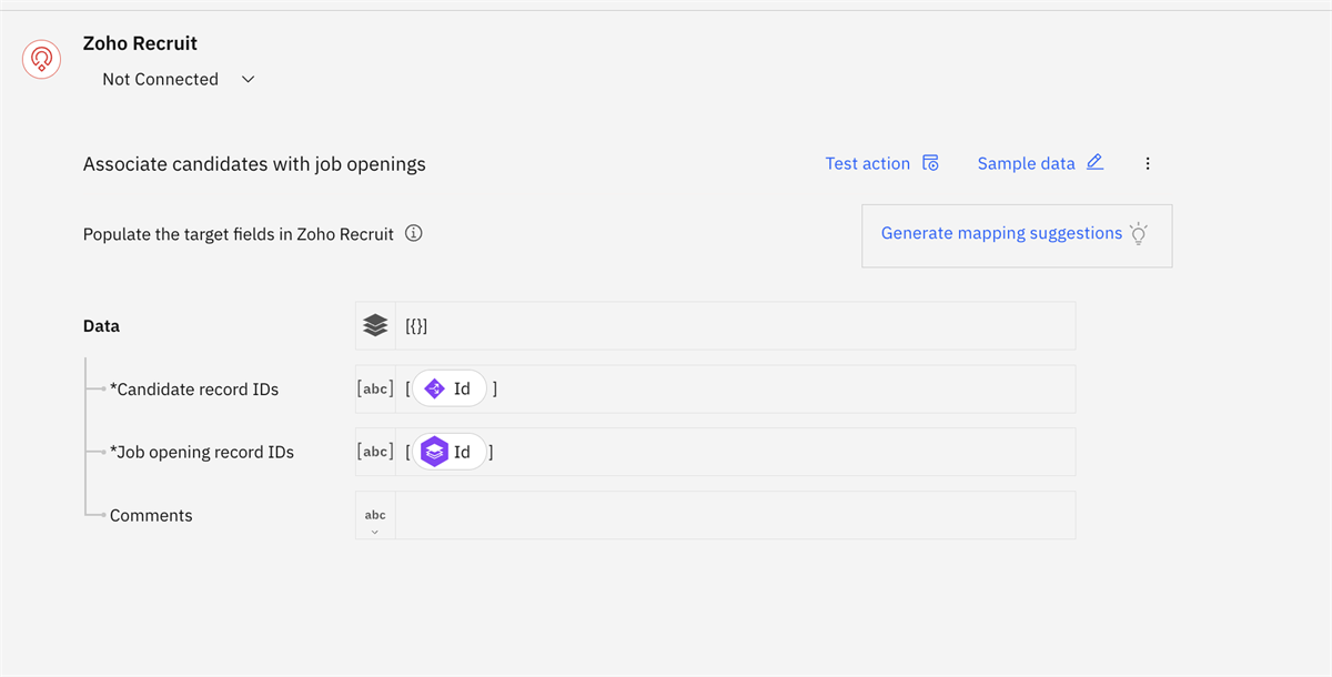

5. Using the Zoho Recruit Associate candidates with job openings operation, the flow associates the job openings with the new candidate.

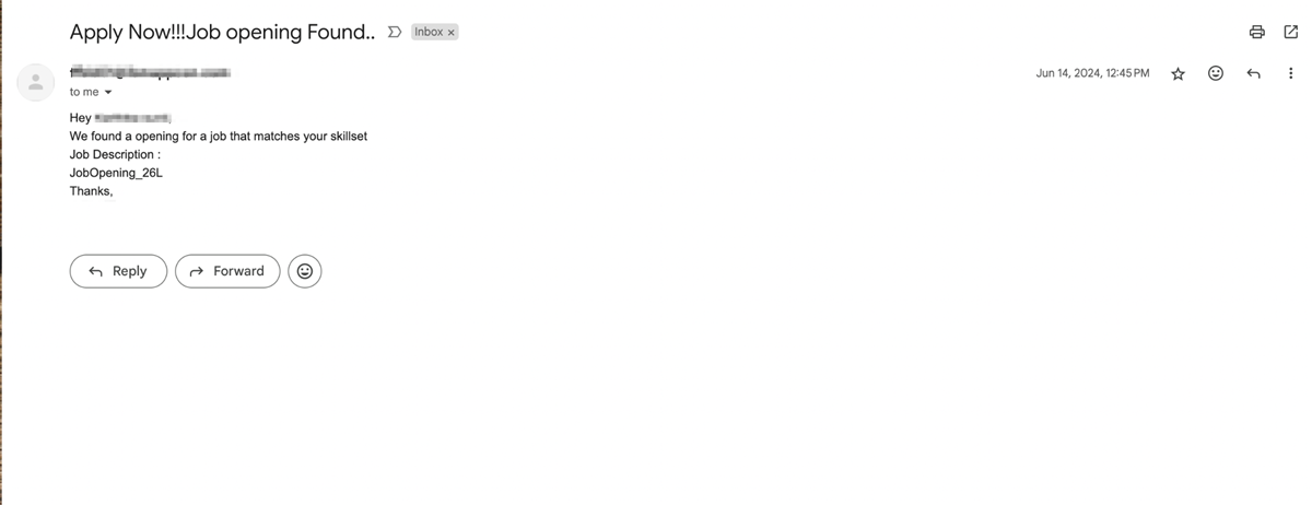

6. Using the Gmail Send email operation, the flow sends an email to the candidate with the details of the associated job opening.
