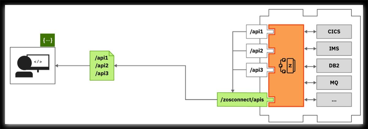

Accessing a z/OS resource with an API

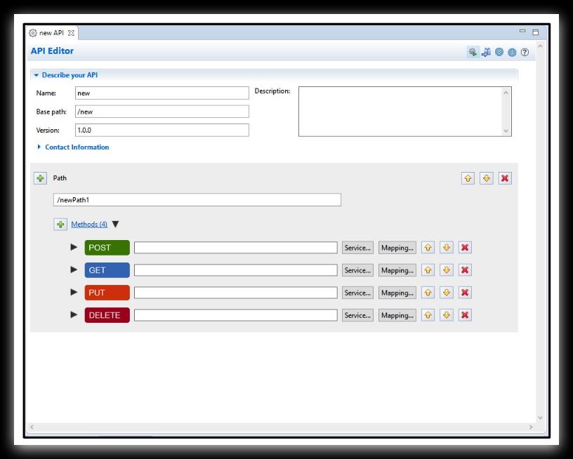

You can create your APIs using the Eclipse Tooling to generate a service archive file for the z/OS application.
Note: All service archives files are functionally equivalent regardless of how there are created or which resources they are intended to access
                                  Eclipse z/OS Connect API Toolkit
  Eclipse API Toolkit
 API Toolkit provides additional data mapping. Use the editor to describe the API and how it maps to undelying services. It also adds logic to interpret the results to add support for multiple HTTP response code.
