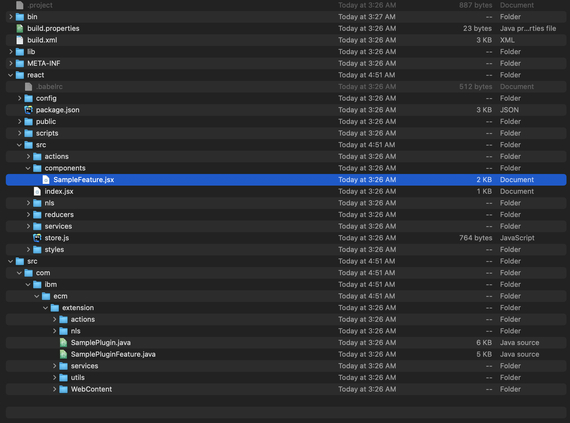

Step 1: Download code from this github repo https://github.ibm.com/wangweiu/ICNReactPlugin.
      This repo is an utility which generates the skeleton code for React based UI plugin, where later we can add our own react code for UI and backend code in Java. Please go through steps mentioned in readme of this repo to generate skeleton code, Once we generate plugin using this utility, the structure of the project looks like this, our react code has to be written inside SampleFeature.jsx file.

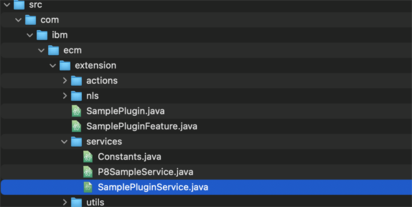

Step 2: Now a create a new service with name ServicePluginService which can be called from web browser.
Add that service in SamplePlugin as follows,
public PluginService[] getServices() {
		if (pluginServices.length == 0) {
			pluginServices = new PluginService[] {
					new P8SampleService(),
					new SamplePluginService()
		return pluginServices;
Now as you would be aware that once this service is invoked from frontend , control comes to execute method inside any service, so write your backend logic in SamplePluginService, a sample looks like below code
