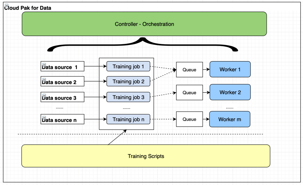

  1. High Level Design
In the diagram above, at the top is a controller that designs and schedules the whole pipeline. Data is sliced, e.g. into Data source 1, Data source 2 etc. Each slice of data will correspond to a training task. The scheduler creates m workers. each worker has a training queue, which can hold multiple tasks. The controller puts the training task into each queue. the worker gets the task from its training queue and complete the training. Then it takes out a new training task to complete until all the tasks in the queue have been trained.
2. Low Level Design
controller is implemented through a notebook. controller takes the role to create and run a pipeline. Worker is implemented by creating a Notebook-based job. The controller will create a number of training tasks based on the slicing data, and assign the corresponding training tasks to each workers. In each worker , we could choose either multi-process or single-process training approach to train models.

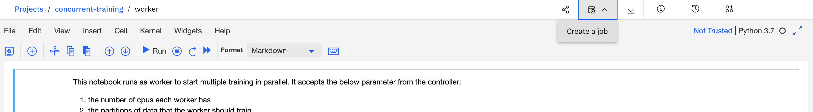

1. In the editor of Jupter Notebook, we can create a new job by clicking New job button in the upper right corner as shown below, which opens the Create a job' page.

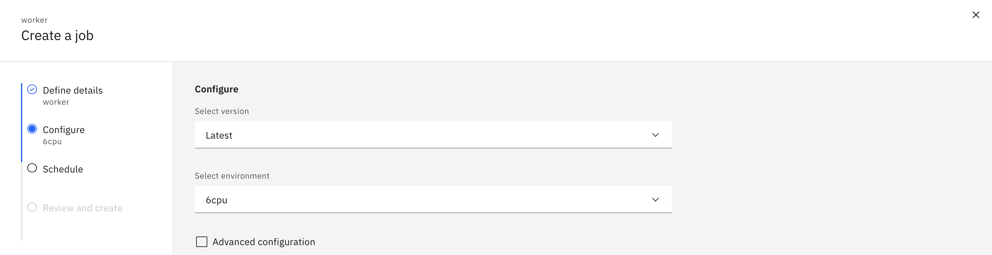

2. On the Create a job page, fill in 'worker' to Job name.
3. In the Configure tab, keep the current setting.

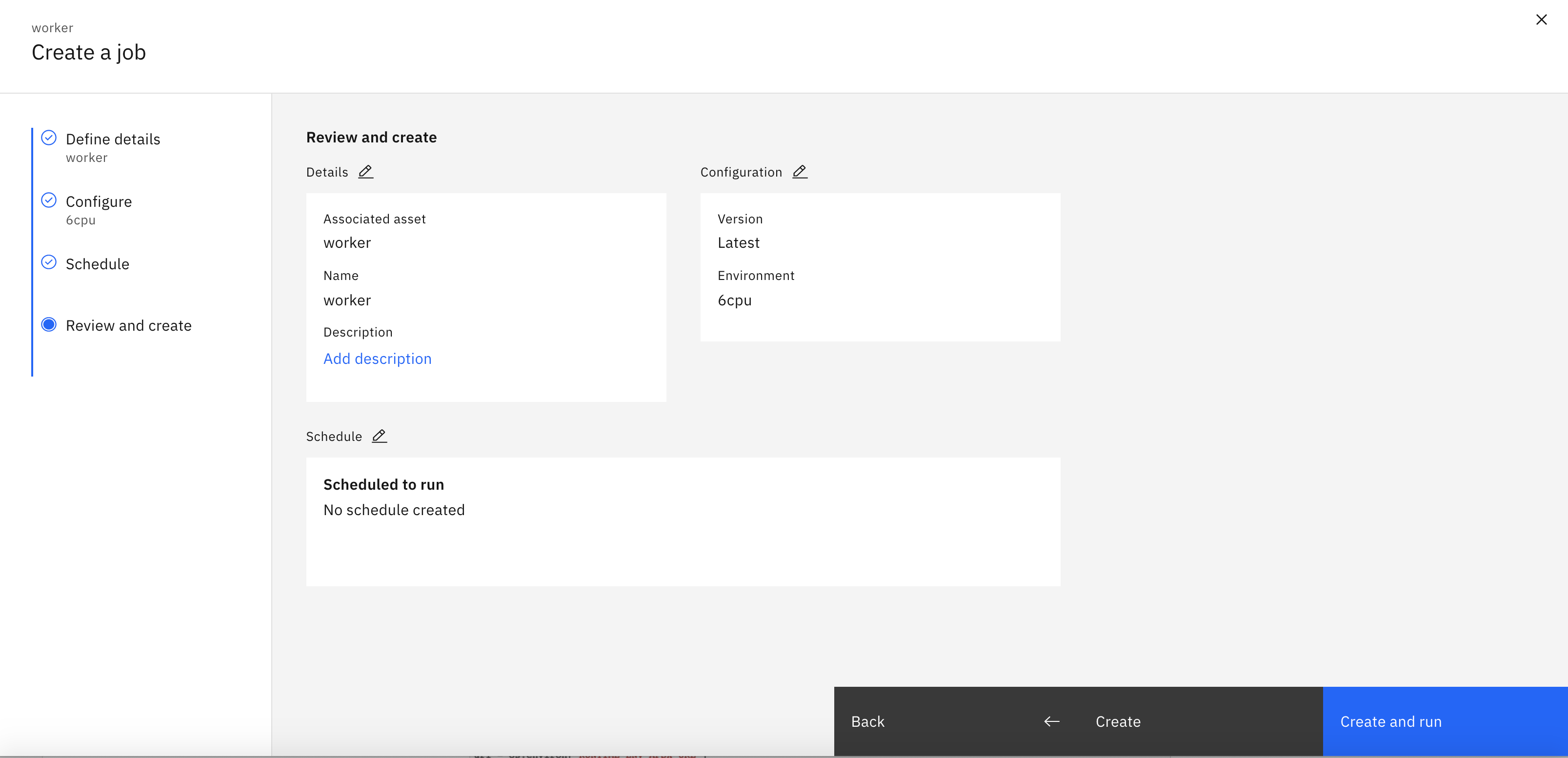

4. Proceed to the last tab and click 'Create' button to create the job.

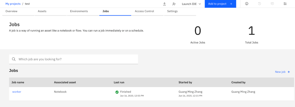

5. In the Jobs tab, you'll find the new job 'worker'.

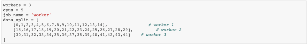

1. Open the controller notebook and set the configuration parameters.
The meaning of each configuration parameter is as follows.
  • workers: How many training workers?
  • cpus: How many processes are enabled in each worker?
  • job_name: The name of the job defined above.
  • data_split : Defines slicing data for each worker

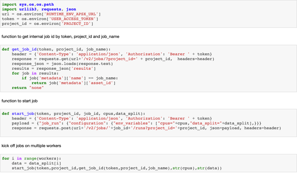

2. Run the following codes to start training.
In the above program, the get_job_id method is the first to get the internal job id. Then the start_job method is to start a job. Finally, start multiple workers through a loop.
