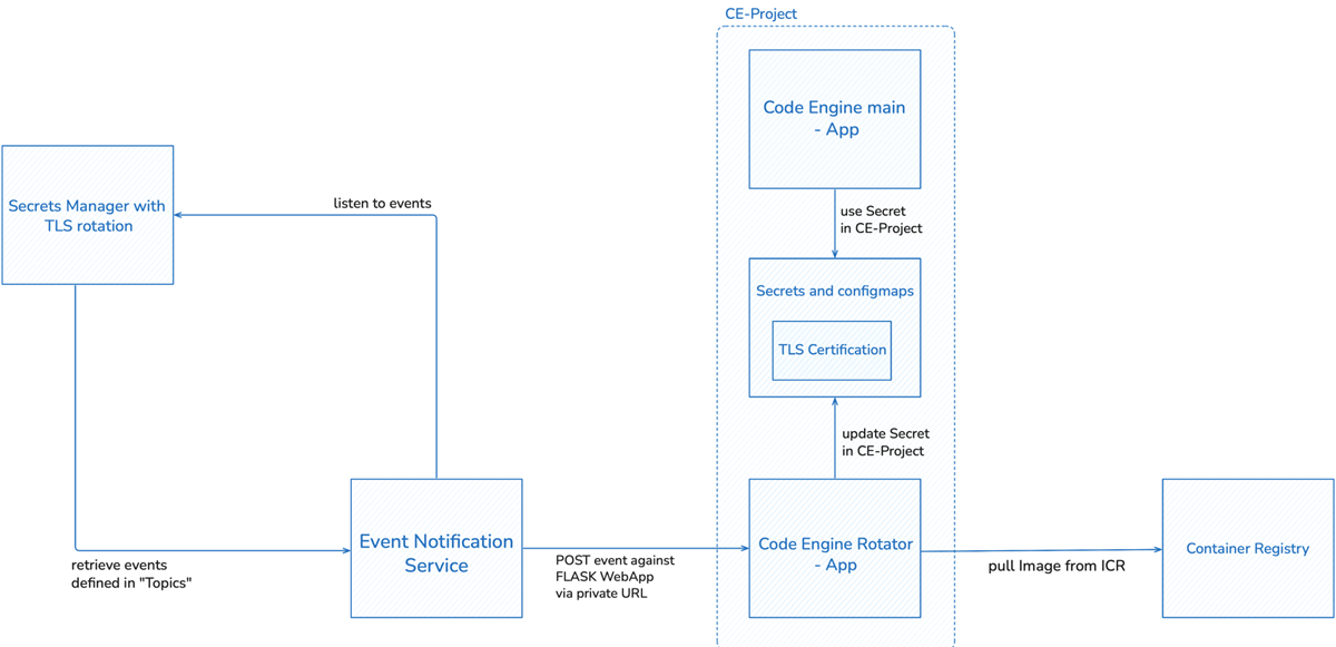

Architecture
The architecture is as simple as that:
  1. An event notification service listens for rotation events within your Secrets Manager instance and posts the events via a private endpoint to the Code Engine Rotator App, which is essentially just a Flask app that scales up in your Code Engine project when an event is received.
  2. The received payload will then be disassembled by the Python script to retrieve the Secret_ID of your public TLS certificate in your Secrets Manager.
  3. With the Secret_ID in hand, the code will authenticate to the Secrets Manager using a trusted profile to locate and retrieve the certificate value.
  4. The now assembled certificate chain will then be replaced within your Code Engine project, with authentication also done using a trusted profile.
  5. Your secret should now be rotated. The rotation app in Code Engine will scale back down and wait for another event.

Components Overview
Secrets Manager (Certificate Origin):
Stores the rotating public TLS certificate. After a rotation it can emit a “secret rotated” event (with secret_id, name, version metadata) only if the instance is first linked to an Event Notifications service in its Settings > Event Notifications.
Without that one‑time connection no events leave Secrets Manager and the pipeline won’t trigger. Once connected, eligible rotations are routed through Event Notifications to the sm‑tls‑sync app.

Event Notification Service:
Acts as the broker between producer (Secrets Manager) and consumer (your rotation app). A Topic can narrow events with:
  • Event type filter (e.g. Secret rotated)
  • Advanced JSON condition (e.g. match a specific certificate name)
    A Destination of type “IBM Cloud Code Engine (Application)” points to the private URL of the rotator app and injects the required custom auth header.

Code Engine Application (sm‑tls‑sync):
A tiny Flask service that’s normally scaled to zero. First incoming POST:
  • Cold start container
  • Validate custom header
  • Parse JSON: extract secret_id
  • Invoke downstream IBM Cloud APIs using short‑lived credentials
  • Replace the target TLS secret in the project
  • Return 201 → idle → scale back to zero
Code Engine Secret and Configmap store (Distribution point):
Stores the TLS secret in format=tls (cert chain + key). Any app in the same project referencing that secret gains the rotated material on next container start (or reread, depending on usage).

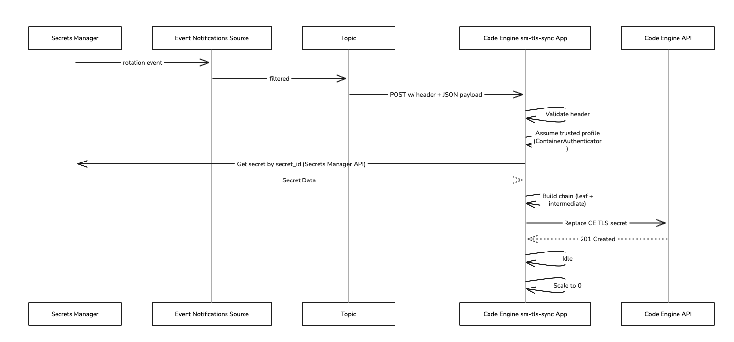

High Level Sequence:
Data Touchpoints:
  • Event Payload (subset):
    • data.secrets[0].secret_id
    • data.secrets[0].secret_name
    • (Optional) rotation metadata / version
  • Secrets Manager Response (public_cert):
    • certificate
    • intermediate
    • private_key
    • expiration_date (can be logged for observability)
Certificate Assembly Logic
  1. Start with certificate
  2. Append intermediate (if present) separated by a newline
  3. Keep private_key isolated
  4. Write as tls_cert / tls_key fields in a replace_secret call

Security & Isolation Layers:
  • Network: Private service endpoints; Code Engine app marked private (no public ingress).
  • Request Gate: Static header secret (lightweight, acts as a first barrier).
  • Identity: Trusted profile eliminates long‑lived API keys and restricts blast radius.
  • Principle of Least Privilege: Only read specific class of secrets + write a project secret, nothing else.
