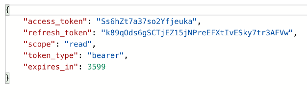

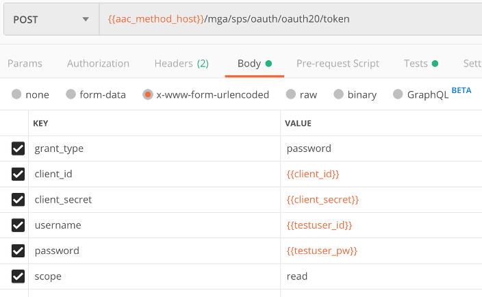

  1. Obtain an OAuth token which will be used to authenticate all subsequent requests. This can be done using any of the OAuth standard flows; deciding which flow to use will depend on the specific details of your implementation, but for API’s the most commonly used flows are Authorization code (if your application can send a redirect request to the end user), or ROPC-Resource Owner Password Credentials if the client is a trusted client. For native mobile applications or single page applications using javascript, you may want to look into using the Authorization code with PKCE flow, this flow is designed to minimize the risk of unauthorized access should the application client secret be compromised.

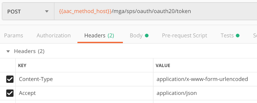

Sample Postman request to get an OAuth token using ROPC flow:
  • Request Headers:
  • Request Body:
  • Response Body:

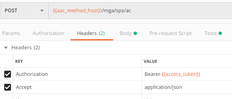

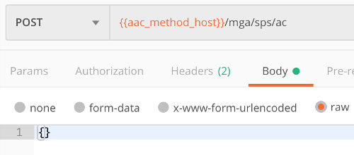

  1. Use the token obtained in step 1, to send a request to the AC service to get the session index which will be used to set the value of ac.uuid cookie:
  • Headers:
Authorization: Bearer {{token}}
Accept: application/json
  • Request type:
POST
  • URL:
/mga/sps/ac
  • Request Body:

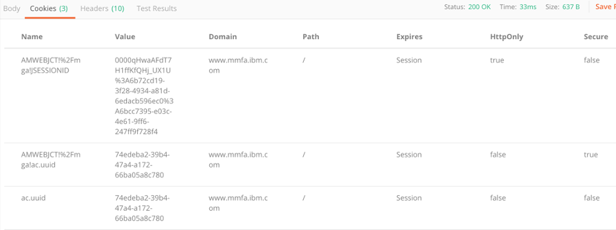

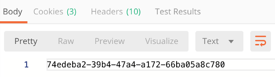

Sample Postman request to get value of ac.uuid cookie:

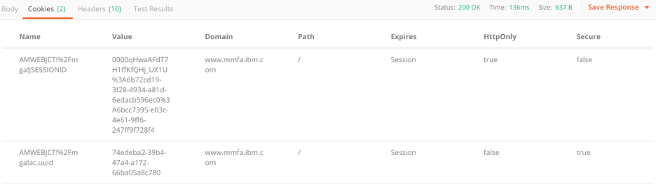

  • Request Headers:
  • Request Body:

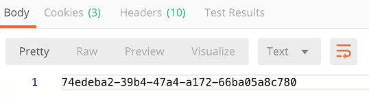

  • Response Body:
  • Response Cookies:

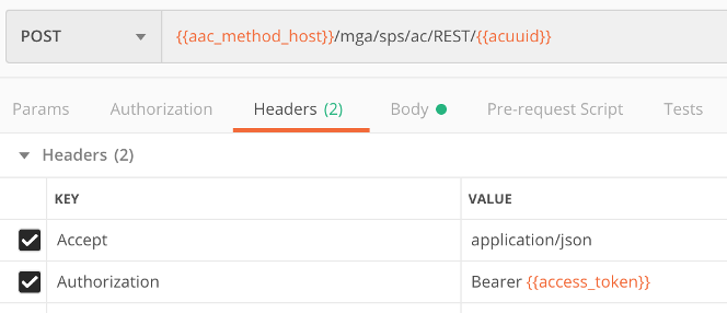

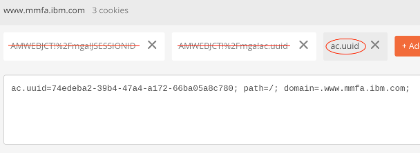

  1. Use the token obtained in step 1, and the session index value obtained in step 2 to send device attribute/value pairs which will be used to register the device to the AC service. Make sure to send a cookie named ac.uuid in the request with the value of the session index obtained in the previous step.
  • Headers:
  • Request type:
POST
  • URL:
/mga/sps/ac/REST/{{session_index}}
  • Body:

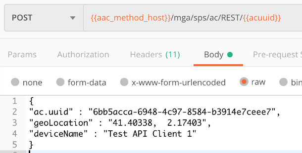

    • List of device attribute/value pairs to be used to register the device in the request body as JSON. i.e.:
"ac.uuid" : "6bb5acca-6948-4c97-8584-b3914e7ceee7",
"geoLocation" : "41.40338,  2.17403",
"deviceName" : "Test API Client 1"
Sample Postman request to set value of device registration attributes:
  • Request Headers:
  • Request Body:
  • Request Cookies:
  • Response Body:
  • Response Cookies:

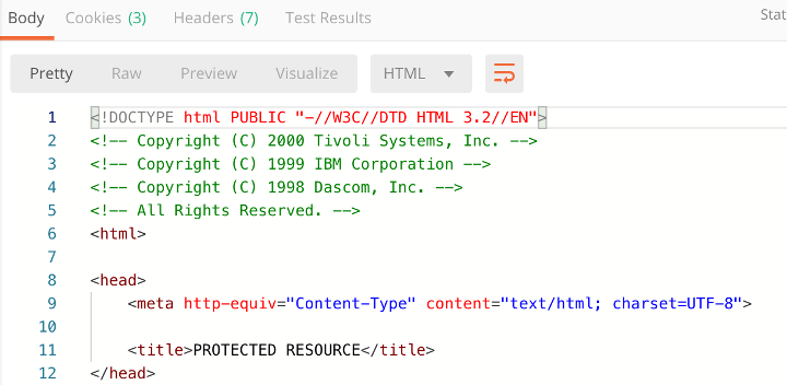

  1. GET /protected.html. This can be any URL that is protected with a context-based Access Control policy that contains the “Register Device” obligation. Make sure the cookie name sent in the request is ac.uuid. This step may have 2 different responses, if you get the actual protected.html page, it means you're authenticated and don't need to take any further action. If the response you get is a 302 redirect to a URL like /mga/sps/apiauthsvc?TransactionId=c2ab-e580-422a-9f42-a88185cb6327 (or the User error page) it means you need to complete an additional authentication policy as defined in the context-based Access Control policy.
Sample Postman request to get a protected resource (/protected.html):
  • Request Headers:
  • Response Body:
