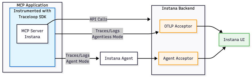

Here is an architecture of how Instana integrate with traceloop SDK and enable MCP observability.

Export modes
You can export traces to Instana in two different modes:
Agent mode :
Export traces to a local Instana agent that runs on your machine:
export TRACELOOP_BASE_URL=<instana-agent-host>:4317
export TRACELOOP_HEADERS="x-instana-key=<agent-key>"
export OTEL_EXPORTER_OTLP_INSECURE=true
Agentless mode (direct to backend):
Export traces directly to the Instana backend:
export TRACELOOP_BASE_URL=<instana-otlp-endpoint>:4317
export OTEL_EXPORTER_OTLP_INSECURE=false
Replace the values with your actual Instana configuration:
  • For agent mode, ensure your local Instana agent is running and accessible.
  • For agentless mode, use your Instana backend OTLP endpoint and API key.
