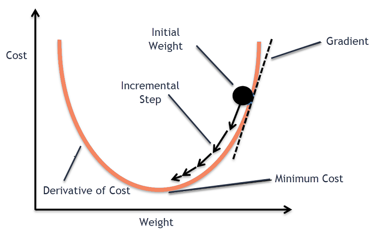

At its core, gradient descent is an iterative algorithm designed to minimize a specific objective function. Whether you’re trying to minimize the error of a regression model or maximize the accuracy of a classification task, gradient descent offers a systematic approach to the parameter space to find the best solution.
The foundation of gradient descent is based on gradients. For calculus, a gradient represents the steepest gradient for a function. On the other hand, a negative gradient indicates the steepest gradient. Gradient descent iteratively changes parameters in the opposite direction of the gradient of a loss function. The goal of gradient descent is to converge to the minimum value of the function.
Basic Formulation:
Let’s delve into the basic mathematical formulation of Gradient Descent. Suppose we have a parameter vector θ and a loss function J(θ) that we aim to minimize. The update rule for Gradient Descent can be expressed as follows:
Here, θt​ denotes the parameter vector at iteration t, α represents the learning rate — a critical hyperparameter dictating the magnitude of each step, and  J(θt​) signifies the gradient of the loss function J(θ) evaluated at θt​. This succinct formulation encapsulates the essence of Gradient Descent, illustrating its iterative parameter updates driven by the negative gradient direction.
The above equation shows how Gradient Descent iteratively updates parameters by moving in the opposite direction of the gradient.
