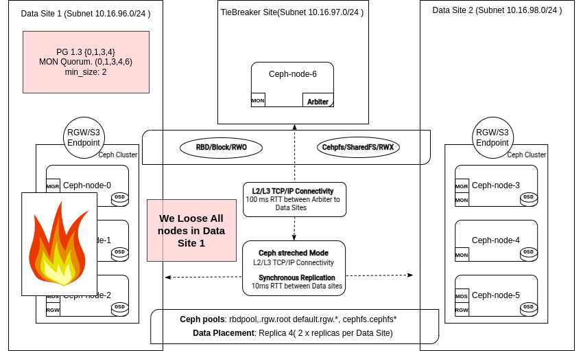

The cluster is working as expected, our monitors are in quorum, and the acting set for our PGs includes four OSDs, two from each site. Our pools are configured with the replication rule, size of 4, and  min_size 2.

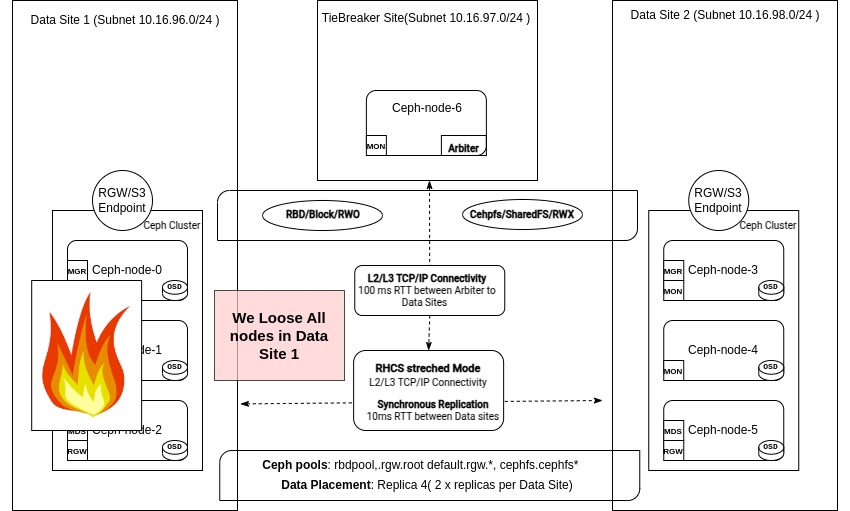

At this point, something unexpected happens, and we lose access to all nodes in DC1.
Failure occurs at DC1

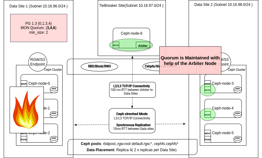

Here is an excerpt from the Monitor logs on one of the remaining sites: Monitors in DC1 are considered down and removed from the quorum:
2025-02-18T14:14:22.206+0000 7f05459fc640  0 log_channel(cluster) log [WRN] : [WRN] MON_DOWN: 2/5 mons down, quorum ceph-node-06,ceph-node-04,ceph-node-03
2025-02-18T14:14:22.206+0000 7f05459fc640  0 log_channel(cluster) log [WRN] :     mon.ceph-node-00 (rank 0) addr [v2:192.168.122.12:3300/0,v1:192.168.122.12:6789/0] is down (out of quorum)
2025-02-18T14:14:22.206+0000 7f05459fc640  0 log_channel(cluster) log [WRN] :     mon.ceph-node-01 (rank 4) addr [v2:192.168.122.179:3300/0,v1:192.168.122.179:6789/0] is down (out of quorum)
The Monitor running on ceph-node-03 in DC2 calls for a new monitor election, proposes itself, and is accepted as the new leader:
2025-02-18T14:14:33.087+0000 7f0548201640  0 log_channel(cluster) log [INF] : mon.ceph-node-03 calling monitor election
2025-02-18T14:14:33.087+0000 7f0548201640  1 paxos.3).electionLogic(141) init, last seen epoch 141, mid-election, bumping
2025-02-18T14:14:38.098+0000 7f054aa06640  0 log_channel(cluster) log [INF] : mon.ceph-node-03 is new leader, mons ceph-node-06,ceph-node-04,ceph-node-03 in quorum (ranks 1,2,3)
Each Ceph OSD checks heartbeats of other OSD Daemons at random intervals of less than six seconds. If a peer OSD does not send a heartbeat within a 20-second grace period, the checking OSD considers the peer OSD to be down and reports this to a Monitor, which will then update the Ceph Cluster Map.
By default, two OSDs from different hosts must report to the Monitors that another OSD is down before the Monitors acknowledge the failure. This helps prevent false alarms and flapping. However, all reporting OSDs may be hosted in a rack with a malfunctioning switch that affects connectivity with other OSDs. To avoid false alarms, we regard the reporting peers as a potential “subcluster” experiencing issues.
The Monitors OSD reporter subtree level groups the peers into the “subcluster” based on their common ancestor type in the CRUSH map. By default, two reports from different subtrees are needed to declare another OSD down.
2025-02-18T14:14:29.233+0000 7f0548201640  1 mon.ceph-node-03@3(leader).osd e264 prepare_failure osd.0 [v2:192.168.122.12:6804/636515504,v1:192.168.122.12:6805/636515504] from osd.10 is reporting failure:1
2025-02-18T14:14:29.235+0000 7f0548201640  0 log_channel(cluster) log [DBG] : osd.0 reported failed by osd.10
2025-02-18T14:14:31.792+0000 7f0548201640  1 mon.ceph-node-03@3(leader).osd e264  we have enough reporters to mark osd.0 down
2025-02-18T14:14:31.844+0000 7f054aa06640  0 log_channel(cluster) log [WRN] : Health check failed: 2 osds down (OSD_DOWN)
2025-02-18T14:14:31.844+0000 7f054aa06640  0 log_channel(cluster) log [WRN] : Health check failed: 1 host (2 osds) down (OSD_HOST_DOWN)
Monitors detect and mark OSDs down
In the output of the ceph status command, we can see that the quorum is maintained by ceph-node-06, ceph-node-04, and ceph-node-03:
# ceph -s | grep mon
mon: 5 daemons, quorum ceph-node-06,ceph-node-04,ceph-node-03 (age 10s), out of quorum: ceph-node-00, ceph-node-01

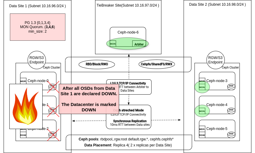

We see via the ceph osd tree command that the OSDs in DC1 are marked down:
# ceph osd tree
ID  CLASS  WEIGHT   TYPE NAME                  STATUS  REWEIGHT  PRI-AFF
-1         0.58557  root default
-3         0.29279      datacenter DC1
-2         0.09760          host ceph-node-00
 0    hdd  0.04880              osd.0            down   1.00000  1.00000
 1    hdd  0.04880              osd.1            down   1.00000  1.00000
-4         0.09760          host ceph-node-01
 3    hdd  0.04880              osd.3            down   1.00000  1.00000
 7    hdd  0.04880              osd.7            down   1.00000  1.00000
-5         0.09760          host ceph-node-02
 2    hdd  0.04880              osd.2            down   1.00000  1.00000
 5    hdd  0.04880              osd.5            down   1.00000  1.00000
-7         0.29279      datacenter DC2
-6         0.09760          host ceph-node-03
 4    hdd  0.04880              osd.4              up   1.00000  1.00000
 6    hdd  0.04880              osd.6              up   1.00000  1.00000
-8         0.09760          host ceph-node-04
10    hdd  0.04880              osd.10             up   1.00000  1.00000
11    hdd  0.04880              osd.11             up   1.00000  1.00000
-9         0.09760          host ceph-node-05
 8    hdd  0.04880              osd.8              up   1.00000  1.00000
 9    hdd  0.04880              osd.9              up   1.00000  1.00000
Ceph raises the OSD_DATACENTER_DOWN This is the condition when an entire site fails. This indicates one CRUSH datacenter’s total failure (network outage or power loss). From the Monitor logs:
2025-02-18T14:14:32.910+0000 7f054aa06640  0 log_channel(cluster) log [WRN] : Health check failed: 1 datacenter (6 osds) down (OSD_DATACENTER_DOWN)
We can see the same from the ceph status command.
# ceph -s
  cluster:
    health: HEALTH_WARN
            3 hosts fail cephadm check
            We are missing stretch mode buckets, only requiring 1 of 2 buckets to peer
            6 osds down
            3 hosts (6 osds) down
            Degraded data redundancy: 46/92 objects degraded (50.000%), 18 pgs degraded, 33 pgs undersized
Data center down warning in Ceph
