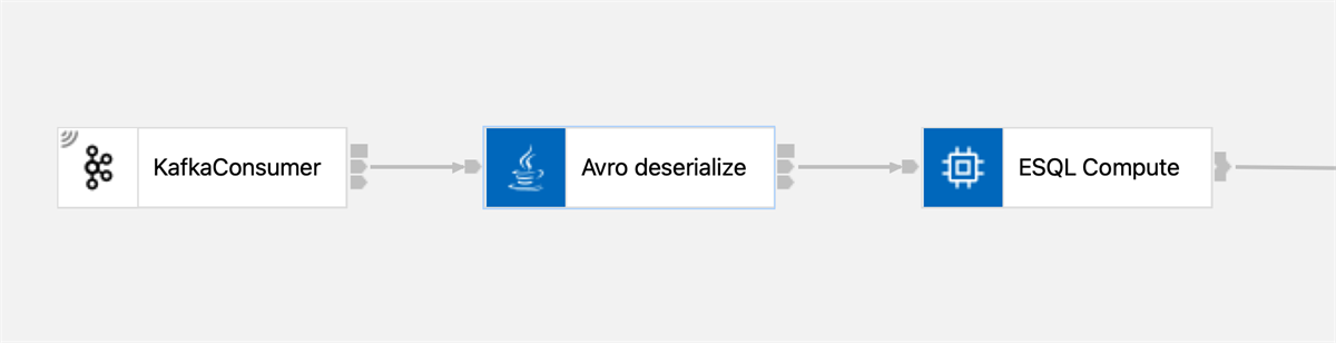

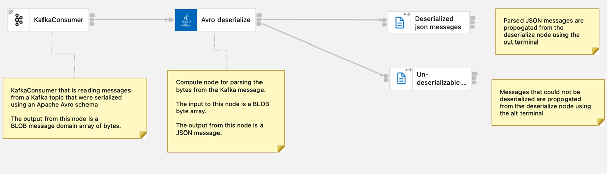

KafkaConsumer node
Configure this node to start consuming messages from your Kafka topics. It will emit BLOB binary messages each containing the raw stream of bytes from a Kafka message.
Screenshot from IBM Event Streams but the examples in this post could be used with Avro-serialized messages on any Kafka cluster
Avro Deserialize Java Compute node
This node will:
Similar to how most SerDe clients work, performance is improved by caching and reusing Avro schemas where possible.
If the Compute node cannot deserialize the message data, it emits the raw Kafka message as-is to the alt output terminal, so they can be sent to a dead-letter-queue for review or alternative processing. Possible reasons why this might happen include:
- The schema that was originally used to serialize the message data has since been deleted from the Schema Registry and is no longer available
- The schema registry is not currently available
- Schema registry credentials provided to the node were rejected

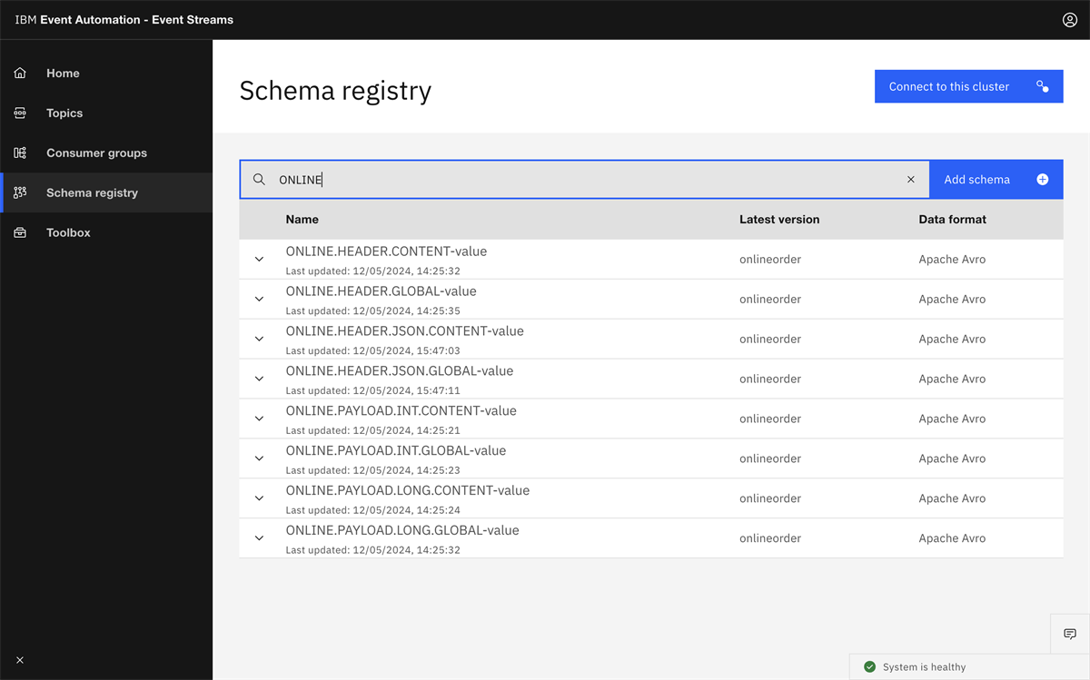

To illustrate the way this can be used, I started a variety of Kafka Connect Connectors. Each was configured slightly differently.
Screenshot from my OpenShift Console, showing the Connectors I used for this post. The definitions are available in Github, but I’ll copy the relevant config below.
These all produce the same type of randomly generated events, each to different topics. This gave me a variety of topics, all using slightly different approaches of serializing the message data and different mechanisms for recording the schema that was used.

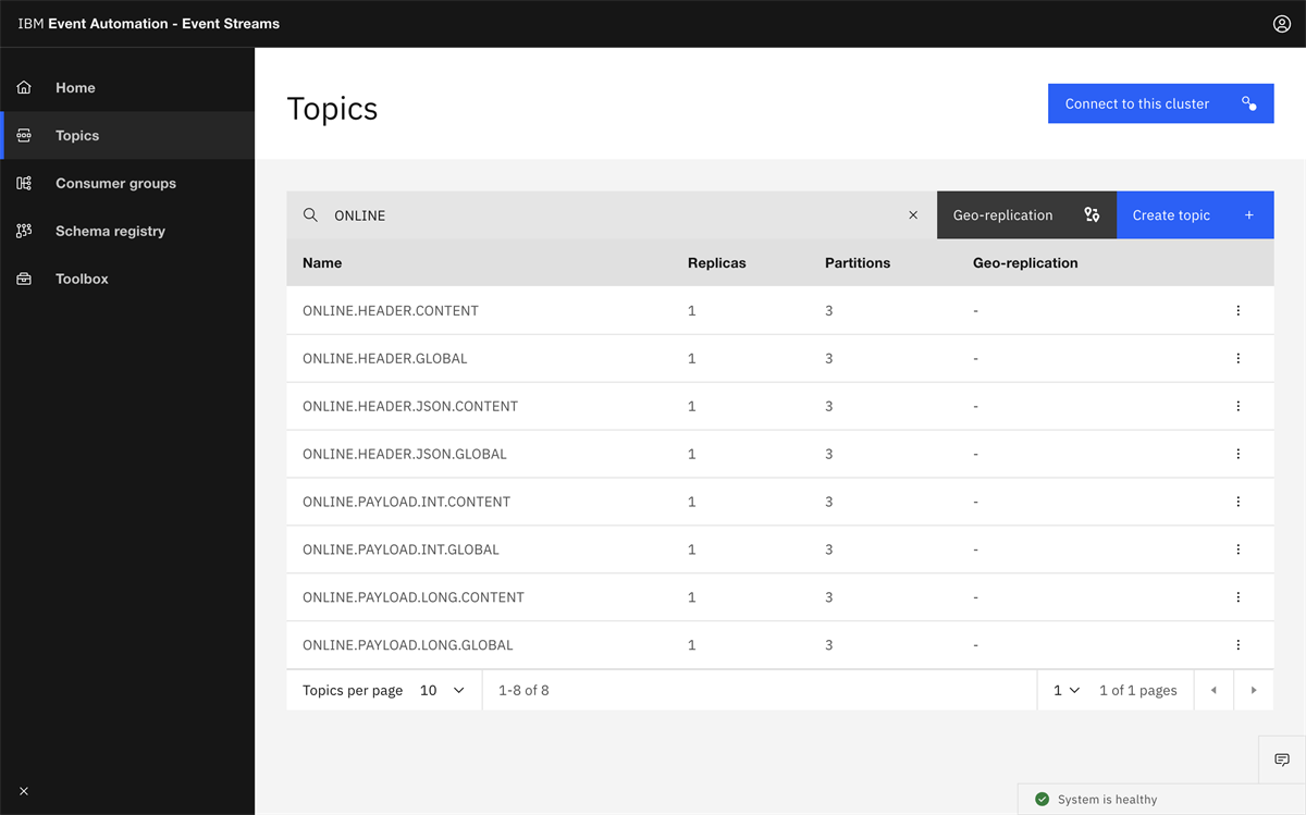

Screenshot from the IBM Event Streams UI showing the topics I used for this post. The definitions are available in Github, but there is nothing specific about the config that is relevant here other than the topic name.
All of the messages used the same type of schema, but a separate schema was registered for each topic, allowing me to illustrate how the Java Compute node can lookup and retrieve different schemas when the identity is encoded in different ways.

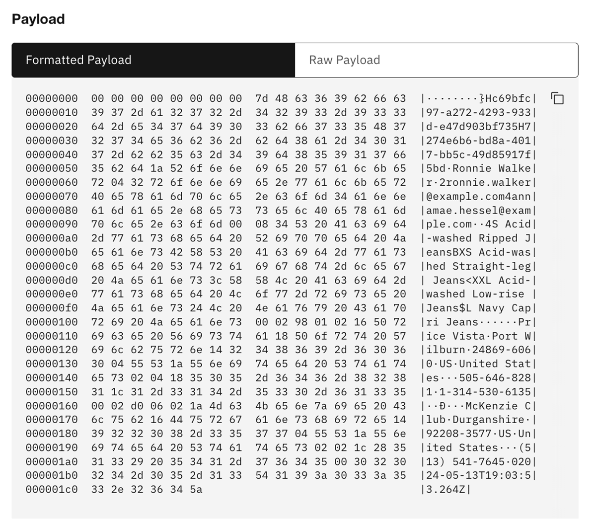

Obviously, this is JSON and not Avro. The actual messages look more like this, but that’s harder to visualise!

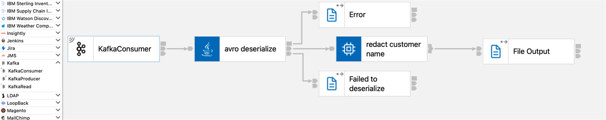

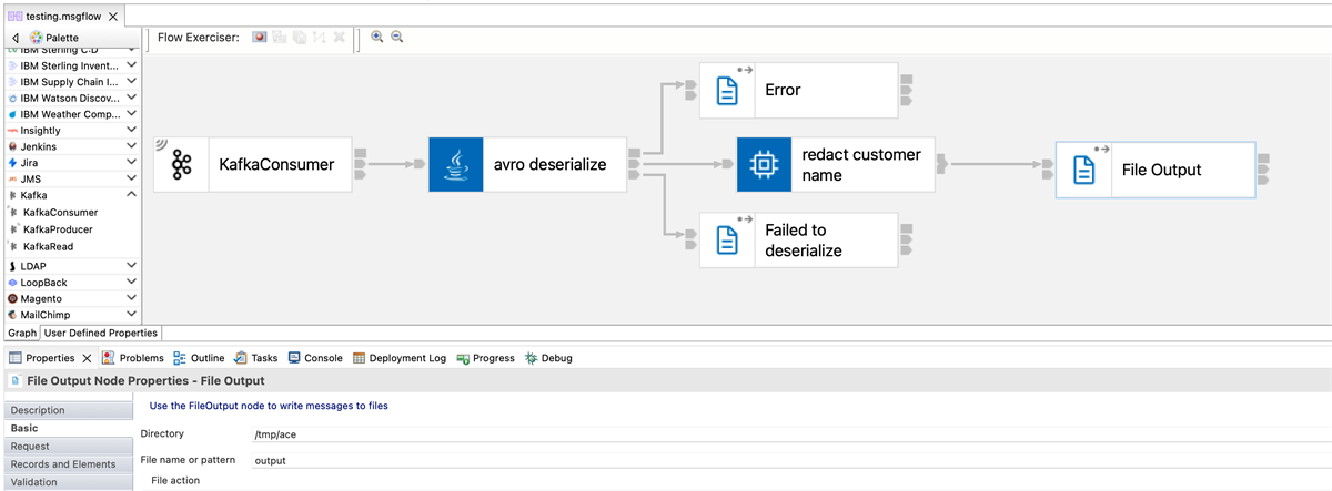

The demo processing
To illustrate the way that App Connect Enterprise can process this binary data once it is able to deserialize it, I created this flow:
The avro deserialize node is a Java Compute node using the AvroDeserialize.java source in Github.
The redact customer name node is a Compute node using this ESQL:
SET OutputRoot.JSON.Data.customer.name = 'redacted';
demos/ace-setup/redaction.esql#L7
Showing that we can replace the customer name is enough to illustrate that the flow has been able to successfully parse the binary data and apply the Avro schema correctly.

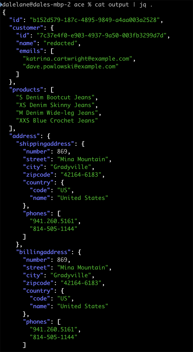

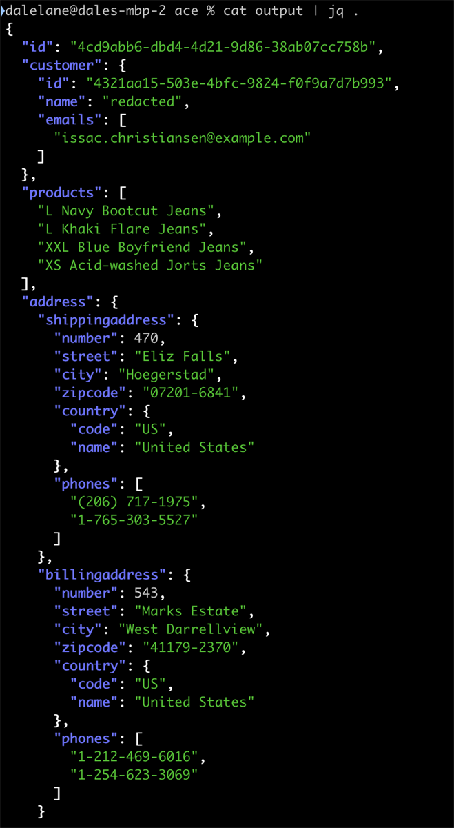

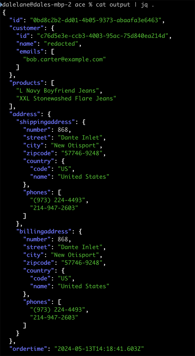

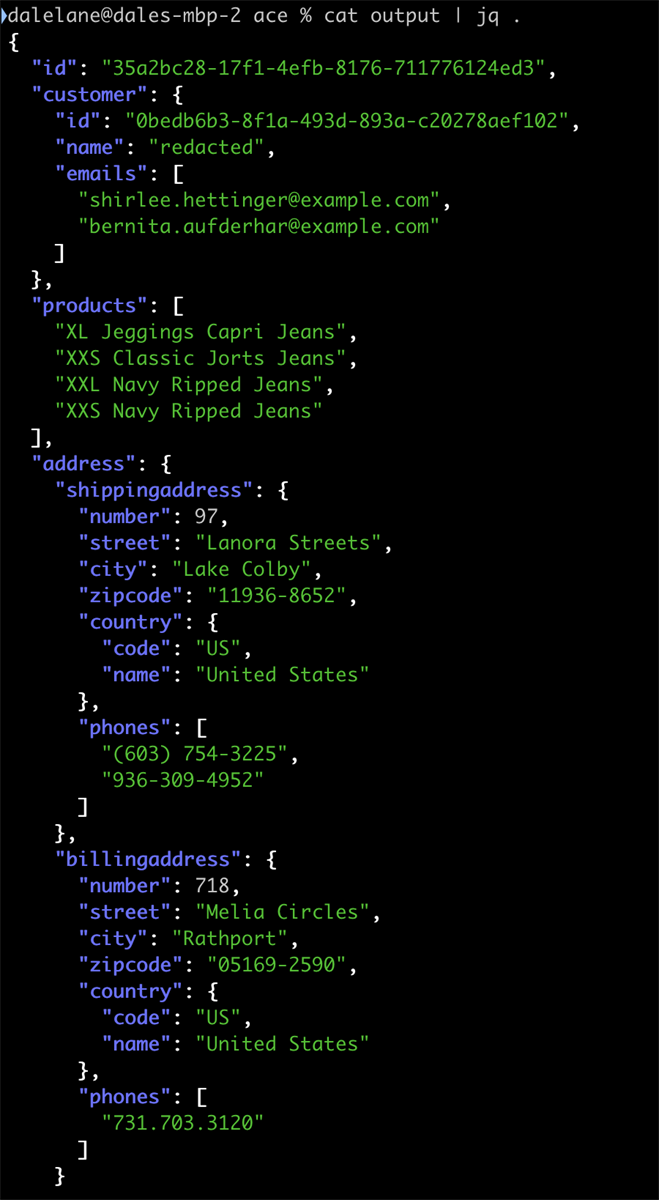

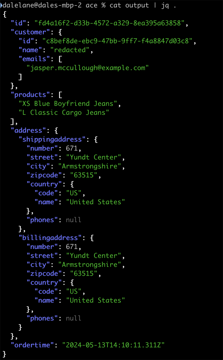

The demo output
My flow outputs the parsed and modified messages in the JSON output format to /tmp/ace/output. I’ll include screenshots of this file to show the results of processing.

This results in Kafka messages like this:
I configured the Avro Deserialize node using:
<schema.registry.api>apicurio</schema.registry.api>
<schema.registry.use.id>contentId</schema.registry.use.id>
<schema.registry.id.length>8</schema.registry.id.length>
demos/ace-setup/schemaregistry-policies/online-payload-long-content.policy.xml#L5-L7
This enabled the App Connect flow to output the JSON format results with the customer name redacted by the ESQL processing:

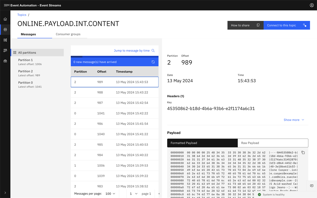

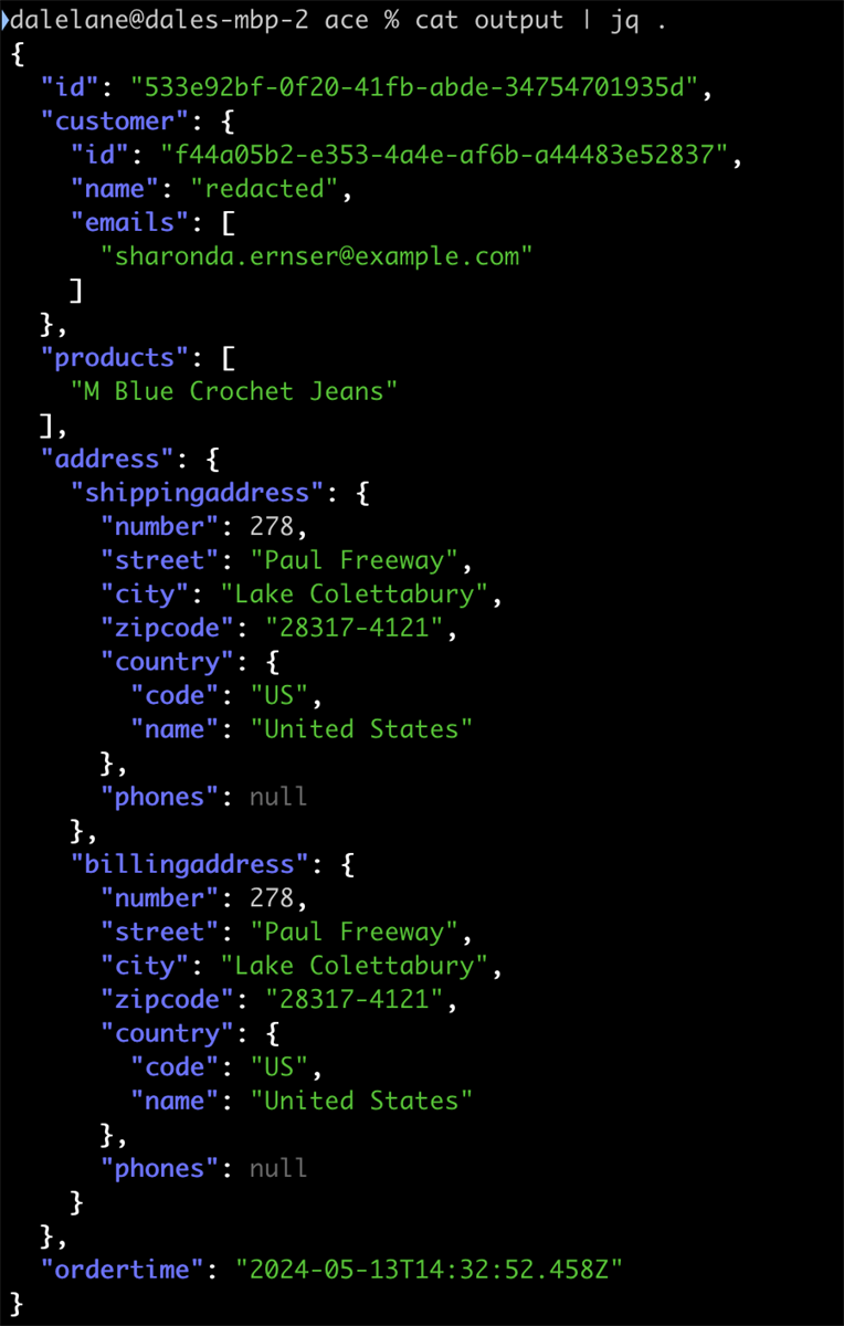

Storing the content ID of the schema as an Integer at the start of a binary-encoded message payload
The Converter was configured to produce messages like this:
value.converter.apicurio.registry.as-confluent: true
value.converter.apicurio.registry.use-id: contentId
value.converter.apicurio.registry.headers.enabled: false
value.converter.apicurio.registry.avro.encoding: BINARY
demos/kafka-setup/connectors.yaml#L40-L48

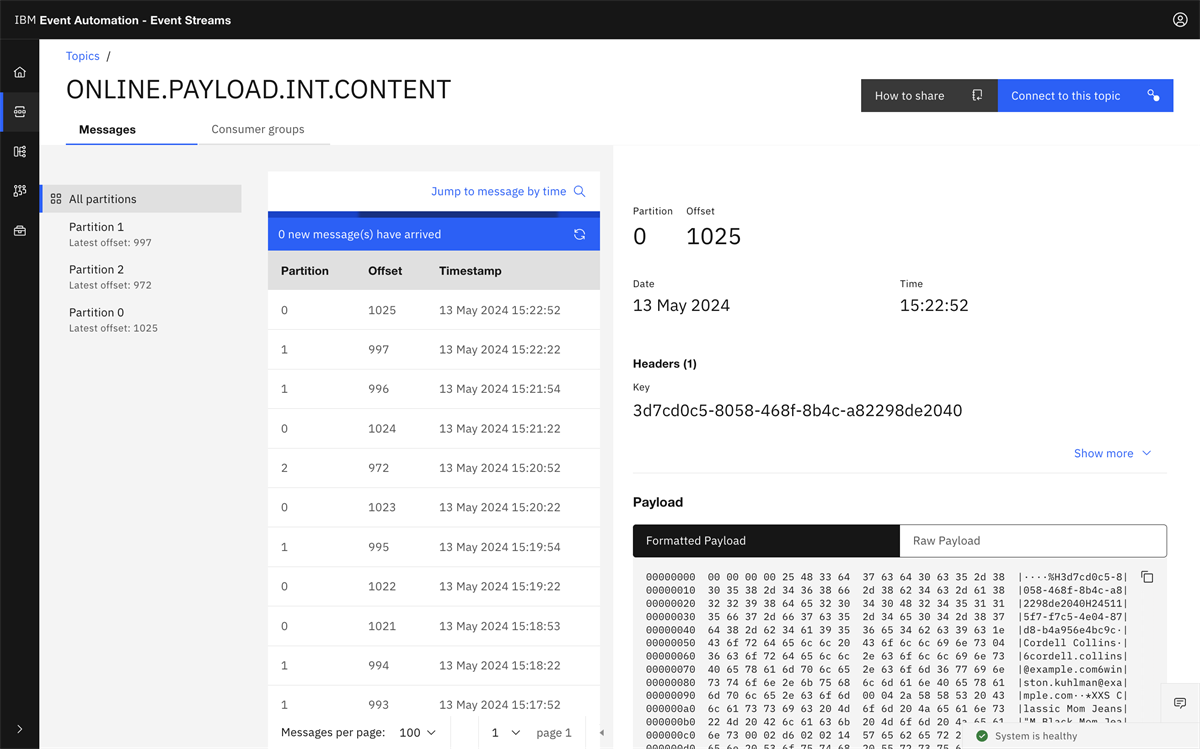

<schema.registry.id.length>4</schema.registry.id.length>
demos/ace-setup/schemaregistry-policies/online-payload-int-content.policy.xml#L5-L7

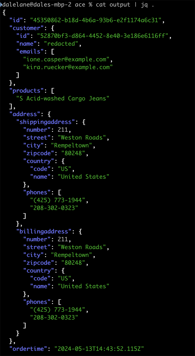

Storing the global ID of the schema as a Long at the start of a binary-encoded message payload
value.converter.apicurio.registry.use-id: globalId
demos/kafka-setup/connectors.yaml#L186-L193
<schema.registry.use.id>globalId</schema.registry.use.id>
demos/ace-setup/schemaregistry-policies/online-payload-long-global.policy.xml#L5-L7

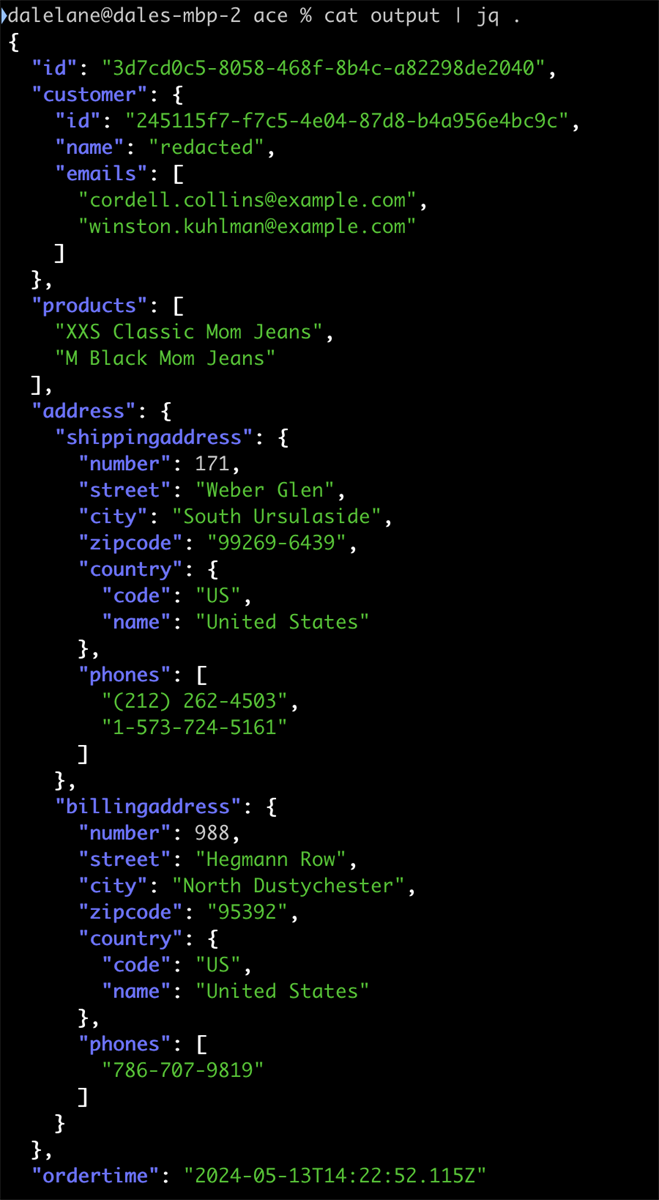

Storing the global ID of the schema as an Integer at the start of a binary-encoded message payload
demos/kafka-setup/connectors.yaml#L137-L145
demos/ace-setup/schemaregistry-policies/online-payload-int-global.policy.xml#L5-L7

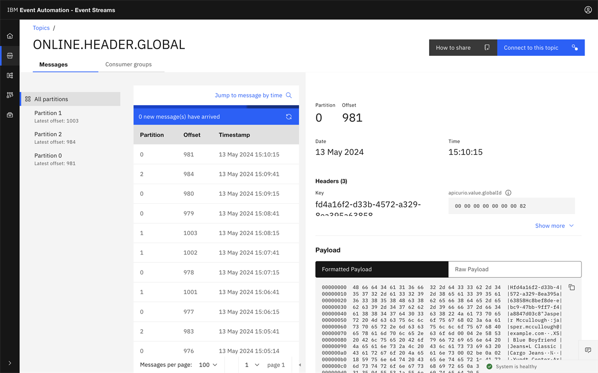

Storing the global ID of the schema in the header of a binary-encoded message
value.converter.apicurio.registry.headers.enabled: true
demos/kafka-setup/connectors.yaml#L282-L289
demos/ace-setup/schemaregistry-policies/online-header-global.policy.xml#L5-L6

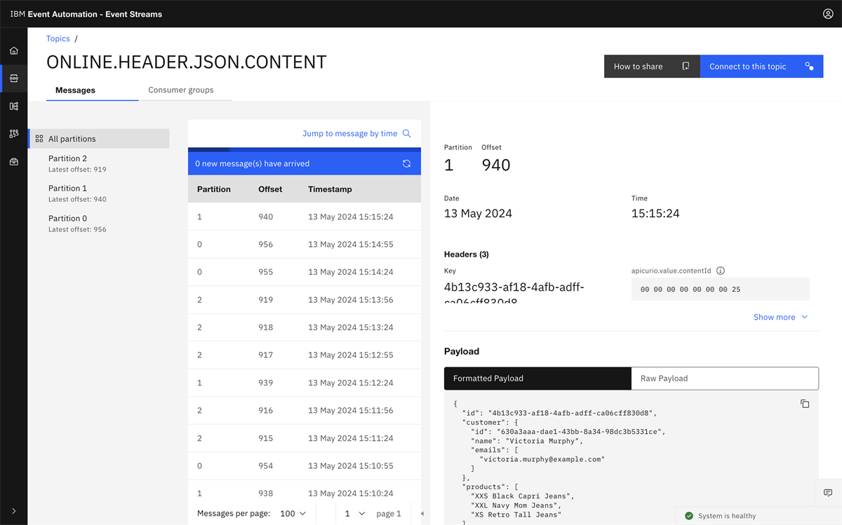

Storing the content ID of the schema in the header of a JSON-encoded message
value.converter.apicurio.registry.avro.encoding: JSON
demos/kafka-setup/connectors.yaml#L331-L338
demos/ace-setup/schemaregistry-policies/online-header-json-content.policy.xml#L5-L6
If you’d like to recreate this demo, you can find everything I used to set this up in Github, including how I set up Kafka and App Connect.
