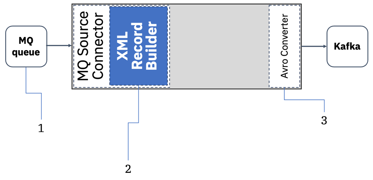

Transfer XML messages from MQ queues into Kafka topics as JSON messages
I can set up a Kafka Connect pipeline to bring XML MQ messages onto my Kafka topics as JSON strings.
  1. MQ queue with XML messages
  2. MQSourceConnector paired with XmlMQRecordBuilder
    Parses the XML and outputs it as Connect structs

Transfer XML messages from MQ queues into Kafka topics as Avro messages
Alternatively, I can configure a Kafka Connect pipeline to bring XML MQ messages onto my Kafka topics as Avro-encoded messages.
  3. AvroConverter
    Serializes the MQ messages into binary-encoded Avro
There are multiple AvroConverters to choose from, so I'll show a couple of examples.
If I'm using io.apicurio.registry.utils.converter.AvroConverter, configured to use an Apicurio schema registry, the config looks like:
mq.record.builder=com.ibm.eventstreams.kafkaconnect.plugins.xml.XmlMQRecordBuilder
mq.record.builder.root.element.name=simple
mq.record.builder.xsd.schema.path=/opt/kafka/external-configuration/xml-schemas/simple.xsd
value.converter=io.apicurio.registry.utils.converter.AvroConverter
value.converter.schemas.enable=true
mq-xml-to-avro-apicurio.yaml
If I PUT a message like this on my MQ queue:
<?xml version="1.0" encoding="UTF-8"?>
<simple>
    <message>Hello World</message>
    <count>123</count>
</simple>
The Connect pipeline will produce this to the Kafka topic as an Avro message like this:
And the AvroConverter will register an Avro schema based on the XSD schema in the schema registry:
