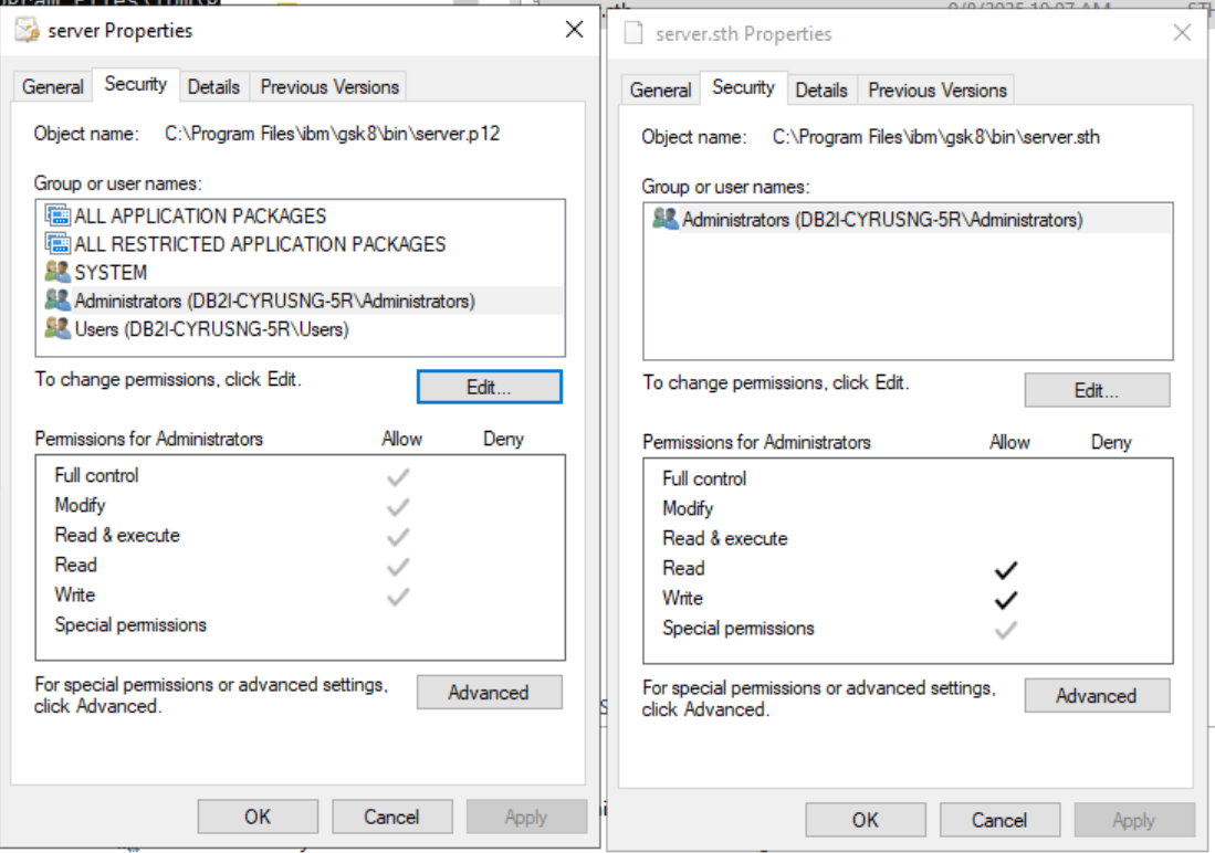

GSKit Error 102 and 408
In the db2diag.log, you may encounter:
2025-09-05-11.01.48.637518-240 I11138E569            LEVEL: Error
PID : 3402527                  TID : 139831086671424 PROC : db2sysc
INSTANCE: cyrusng              NODE : 000
HOSTNAME: CyrusNg-857tb-x86
EDUID : 1                      EDUNAME: db2sysc
FUNCTION: DB2 UDB, common communication, sqlccMapSSLErrorToDB2Error, probe:530
MESSAGE : DIA3604E The SSL function "gsk_environment_init" failed with the
          return code "102" in "sqlccEnvironmentInitCommon".
DATA #1 : String, 20 bytes
GSK_KEYFILE_IO_ERROR
DATA #2 : String, 25 bytes
I/O error reading keyfile
or

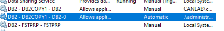

On Windows, these files should be accessible by the Db2 service account. You can find the account your Db2 service is running under by hitting Win+r and running services.msc. Search for the Db2 service and the account will be mentioned under the “Log On As” column.
Shows the Db2 service inside services.msc
Then, make sure your keystore is accessible by this account:
Details of the Db2 service showing the permissions of the Administrator user
Remember to make sure the entire path is accessible to the instance owner/service account! If you have determined that the instance owner or Db2 service account can access the files, then double check the version of GSKit installed on your system. You can do this using:
