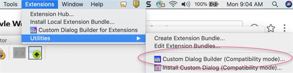

Step 1: Launch the CDB Authoring Tool
So let’s begin. First we will open the Custom Dialog Builder in Compatibility mode in order to able to work with Statistics versions prior to version 24. This is accomplished by selecting the “Extensions -> Utilities -> Custom Dialog Builder (Compatibility mode)” main menu item:

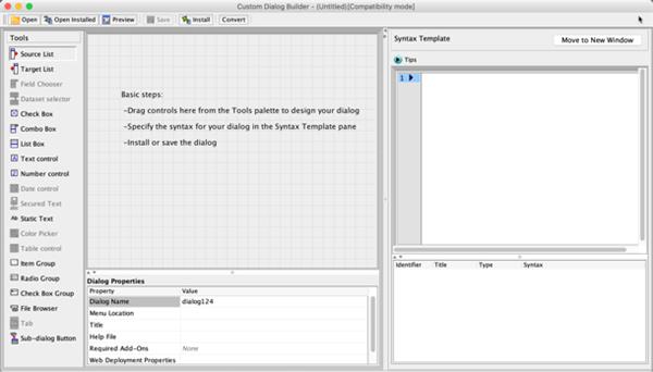

Step 2: Build the CDB Specification
We are then presented with the CDB authoring mode UI, which looks like this. Note the left-side palette from which controls are dragged to the canvas:

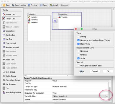

We can now drag controls from the left-side palette onto the authoring canvas. For this example we will allow users to select only numeric variables with the measurement level set to scale. To accomplish this we first drag out a Source List control from the palette, then we add a Target List control to receive variable selections beside it.
Next we open the Variable Filter dialog by selecting the target list and choosing the Variable Filter button as shown below. Here we want to select only non-string type variables that have a Scale measurement level:

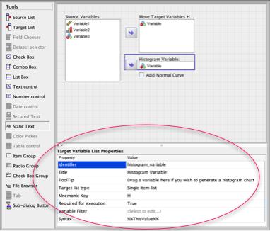

In the next step we will add the ability to generate a histogram for a selected variable. We will also allow the user to add a normal curve on the generated chart. To do that we drag another target list onto the canvas and drop it below the first target list. We then drag a checkbox control below the second target list to allow normal curve creation.

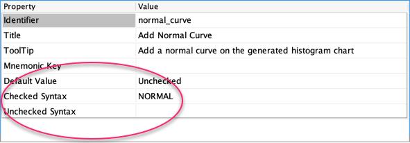

As circled below, each canvas control contains an associated property editor. In this case we use histogram_variable as the unique identifier for the histogram target list. We also setup a control title, tooltip and mnemonic key as seen here:
Note too that we have made both variable target lists in this UI Required for execution, which means that the OK and Paste buttons on the custom dialog will only be enabled when there is at least one variable present in each list.
The Syntax field in the property editor is for describing the syntax that each control generates. The default is %%ThisValue%%, which indicates that we wish for the default syntax be generated for this control. In the case of target variable lists %%ThisValue% equates to a space-delimited list of selected variable names. In general one uses the ThisValue constant or other control identifiers between double percent symbols (%%identifier%%) to setup replacement values within any generated syntax.
We can also now set the identifiers, labels, tooltips, etc., for the other controls. Of interest in the case of the Normal Curve checkbox is the fact that checkboxes have two possible syntax snippets they can generate. In this case when the checkbox is selected we generate the term NORMAL, and when the checkbox is unselected we do not generate any additional syntax:

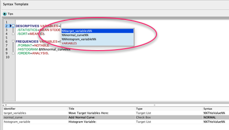

Step 3: Create the Syntax Template

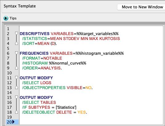

Custom dialogs generate Statistics syntax. To associate this dialog with the syntax that it will generate, we need to set up a template in the Syntax Template panel of the CDB.
For this example we are combining elements from both the Descriptives and the Frequencies procedures. We start with the basic specification we want, then add replacement values that are sourced from our UI. Here we have DESCRIPTIVES syntax in which the list of possible values for the VARIABLES keyword are presented in a menu whenever one holds down the control key and presses the spacebar at the same time:
When complete our syntax template contains hard-coded values for the statistics in our Descriptives output, with variables sorted by descending means. There is also a histogram from the Frequencies procedure in which the tables have been suppressed. We will also add two OUTPUT MODIFY commands at the end of the syntax template to hide the logs and to delete the Statistics table from the Frequencies procedure.

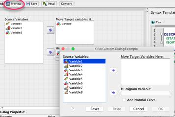

The next step is to test our custom dialog to ensure that it performs properly. Fortunately, the CDB comes equipped with a built-in test harness that allows authors to check their work and the generated syntax before deploying the dialog. We accomplish this by pressing the Preview toolbar button near the top of the CDB authoring tool:

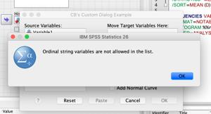

Now we can execute the dialog and see it as it will appear when deployed. A sample dataset is provided with the preview test harness to allow authors to exercise rules and syntax. In this case we can see our variable filters are working properly when we attempt to add any non-numeric or non-scale variables to the target list:

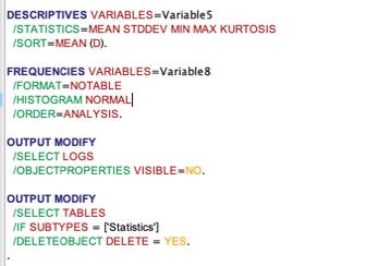

Step 5: Test the Generated Syntax
We can also test the generated syntax at this time. To do that we complete the required specifications for the dialog and then press the Paste button. Here we can see the syntax is generated as expected. We cannot execute that syntax yet however, since the variables used are only metadata from the dummy Test Harness dataset.

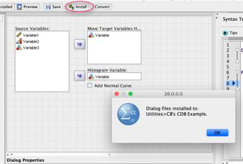

When your custom dialog is ready, deploying it is a snap - simply press the Install toolbar button:
You can also save your CDB specification in a .spd file for later use. Press the Save toolbar button to create files that are portable representations of custom dialogs. These can be sent and imported as a unit into other instances of SPSS Statistics, or opened again later for enhancing existing specifications. We can close the Custom Dialog Builder for now.

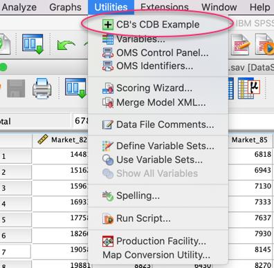

One of the nice features with custom dialog deployment is the ability to deploy new UIs in real time without requiring a restart of the application. Once you have finished deploying and/or saving your new custom dialog from the CDB, simply close the authoring tool and look in the main menus for your newly deployed dialog:

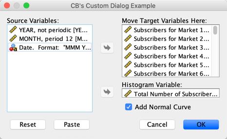

You can then select the new menu item to use your dialog. Here we use the variables representing regional market subscribers for the Descriptives table, and use the “Total Number of Subscribers” variable to generate the histogram:

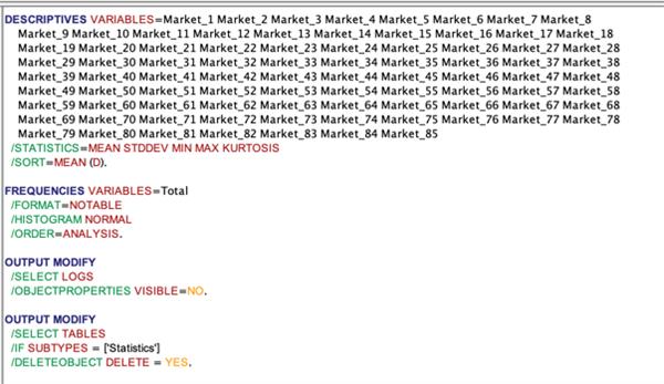

When pasted, the syntax generated from the above dialog looks like this:
When we then execute the above syntax we receive the following output. Note the variables in the Descriptive Statistics table sorted by descending means:
