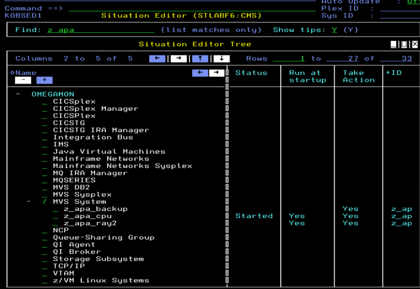

    • Enabling the system monitoring tool to schedule APA observation in the event of a threshold breach. From V14.1.4, APA has included the procedure (CAZ$NEW) and REXX program (CAZSTART) to enable IBM® OMEGAMON® to schedule APA observation in the event of a threshold breach.
    • IBM® OMEGAMON® APA command can be triggered from the system command console of OMEGAMON®. The following sample shows how to trigger APA observation from the OMEGAMON system command when the elapsed time of job APAJCL15 crosses 0.1 seconds.
    • You can complete the following steps to test the sample.
      • Create a situation in OMEGAMON®.
      • Define the conditions for the new situation.
      • Define a formula for the job. The following formula is defined for JCL APAJCL15. Note: The Interval field under the "Sampling" section determines how often the situation is detected. In this case, the condition is checked every 30 seconds.
      • Define the action. If the condition defined in the formula is satisfied, the procedure CAZ$NEW will be triggered to schedule the APA observation. The procedure CAZ$NEW that is used in the Action tab accepts various other parameters. For more information, see “Using the MVS START command to schedule a new measurement”.
      • Start the OMEGAMON task that monitors the job APAJCL15 since it starts running. If the condition is satisfied, APA observation will be scheduled.Since the Run at Startup field is set to “Y” when the situation is created, you do not need to manually start up the situation.In the sample screen, the command CAZ$NEW is the IBM APA supplied procedure. The current command instructs APA (STC=CAZE) to measure the Active job (ACT=Y). CAZNEWIM is the static member that contains instruction. To generate the report automatically as soon as a measurement is completed, specify “ARGDATA” parameter when the measurement is scheduled.

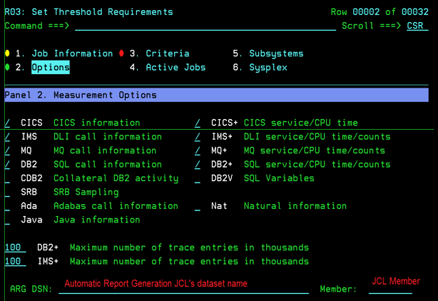

  • Enabling APA to measure a job in the event of a threshold breach through the APA ISPF interface
  • APA provides the feature to define the threshold for a job. When job start executing, APA monitors it and start performing the.1 analysis as soon as threshold breaches.
  • The following screen shows which APA interface provides the function to capture threshold for a given job.

To define the threshold from ISPF interface, follow the instructions in “Entering a Threshold Monitor request”.
To define the threshold from Batch Interface, follow the instructions in “TNEW” .
To create the report automatically from APA ISPF menu upon the measurement completion, populate “ARG DSN” and “Member” parameter on the APA ISPF menu.
