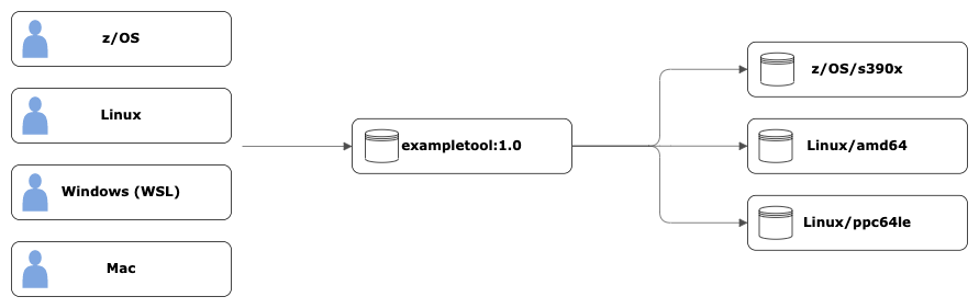

With the release of the IBM z/OS Container Platform, you now have the ability to build, run, manage, and orchestrate containers natively on z/OS. Containers bring with them the promise of portable containerized software that can be packaged, distributed, and run on multiple platforms.
Example of users on different platforms accessing a multi-architecture image
You are going to take full advantage of that promise here, and approach building a simple tool that you package up as a multi-architecture container image. This allows users to interact with the tool in a consistent manner across all supported platforms.
