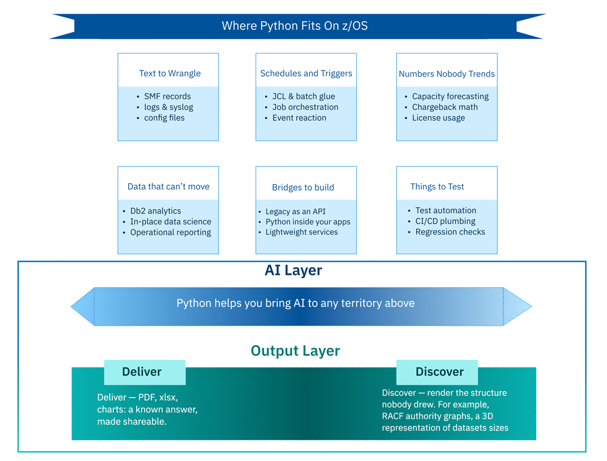

Understanding System Artifacts
That ABEND report isn’t special. It’s one of many ways the system leaves a trail behind as it runs: logs, job outputs, traces, datasets. Each captures part of what happened.
Step back, and a pattern appears. There’s text to interpret, numbers to analyze, flows to orchestrate, work to trigger, data to process in place, and checks to run before the next step. Most teams already work in these spaces every day. What’s changing is not that they exist, but how you interact with them.
From Outputs to Action
All those areas have something in common: the data is already on the system where the work began. For a long time, doing anything useful meant pulling it out: exporting, copying, or moving it somewhere else first.
What’s changed is that you can now bring the work to the data instead. The ABEND report stays where it is. The script acts in place. Once you see that, these system artifacts stop being just outputs to inspect. They become places you can act. Instead of opening SDSF and scanning, the system flags what matters.
Where Python Fits in Practice
Python on z/OS is no longer a curiosity, it’s a practical tool showing up in real workloads, often in places where traditional languages are either too rigid or too heavy.
Key Use Cases

Bottom line: Python doesn’t compete with z/OS strengths, it amplifies them, acting as a pragmatic layer for integration, transformation, and automation right where enterprise work happens.

The map we started with still holds: integration, data, automation, and adjacency to AI. Python doesn’t sit in one of those boxes; it runs across them. The same approach that starts with scanning ABENDs can extend into batch orchestration or lightweight data pipelines. A one-off utility quietly turns into something a team depends on, not by design, but through use.
