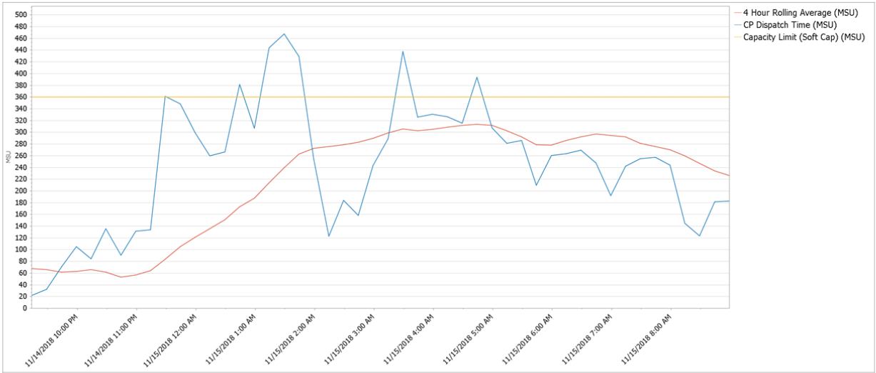

The following IBM Z IntelliMagic Vision for z/OS chart illustrates a common area of confusion. One peak drives capacity; the other drives costs.

Note that the R4HA (SMF70LAC) has an LPAR scope and is stored in the SMF 70 record. Quite often, it is necessary to calculate a R4HA for multiple LPARs. In this case they are added together.
Note that the peak value is not the “sum of the peaks” but rather the “peak of the sums”. That is to say, the hour with the highest combined peak of the combined LPARs, not necessarily the highest peak of any individual LPAR or sub-group.Subsystem Billing
