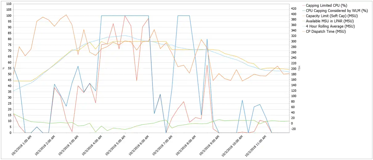

In any capping environment, the key is to track when LPARs are ‘eligible’ for capping vs when applications are actually delayed by capping. Note the following chart from IBM Z IntelliMagic Vision for z/OS:
In this automated-capping environment, there are significant differences between “Capping Limited CPU” (applications are delayed) and “CPU Capping Considered” (no delay).  Your solution should avoid the former while maximizing the latter.
