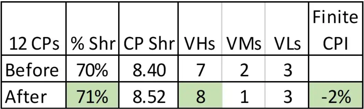

(1) For LPARs with a guaranteed share greater than 1 and a fractional share slightly below 0.5 (e.g., 8.4), a small weight adjustment can create an additional VH. This can be especially helpful on large LPARs with a significant workload currently executing on VMs and VLs.
Figure 1: LPAR Weight Change on Large LPAR
Figure 1 shows an example where changing the weight from 70 to 71 percent was sufficient to increase the number of VHs from seven to eight. This resulted in a measured decrease in Finite CPI of two percent for a given measurement interval, which correlated to a CPU reduction of one percent. One percent less CPU on a large LPAR can translate into a meaningful reduction in software expense, especially when compared with the level of effort required to identify and implement this type of change. Benefits from tuning LPAR weights typically produce single-digit percentage improvements as in this case, but there can be larger opportunities, as seen in what follows.

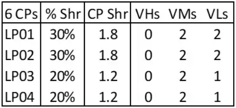

(2) Specialized situations may provide additional opportunities to tailor LPAR weights to increase the overall number of VHs assigned by PR/SM on a processor. The LPAR weight configuration of 30/30/20/20 percent shown in Figure 2 appears routine, but unfortunately, on a z13 it results in zero VHs.[5]

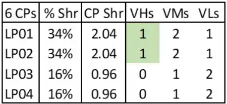

Figure 3: Adjusted LPAR Weights Creating 2 VHs
As Figure 3 shows, relatively small LPAR weight changes would increase the number of VHs on this processor from zero to two, increasing the amount of work eligible to execute on VHs from zero to 33 percent. On comparable systems in this environment, the Finite CPI for work executing on VHs was 20 percent lower than work on VMs, so this change would significantly reduce CPU consumption on this processor.

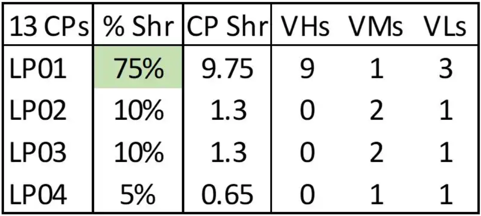

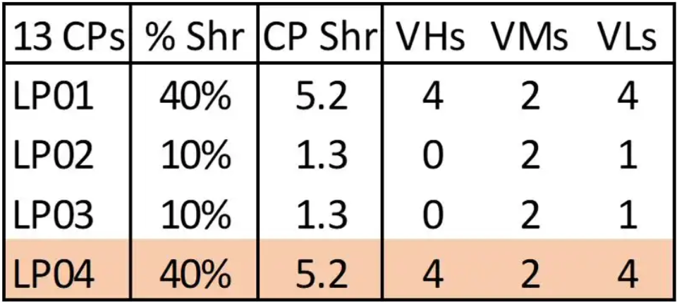

(4) Avoid activating idle LPARs with large weights or failing to deactivate idle LPARs after testing has been completed. Both scenarios can have a significant negative impact on cache and CPU efficiency.
Figure 5: Idle LPAR with Production Weight
Figure 6: Production LPAR with Production Weight

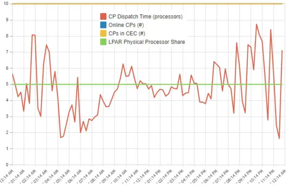

In the scenario shown in Figure 5, planning was underway for a configuration change to split the primary Production workload across two LPARs. To prepare for the change (which would go live in a few months) a new LPAR (LP04) was defined and activated with a production weight. The opportunity here is that the entire Production workload was still executing on LP01, which now only had access to 4 VHs, so that a sizable workload was executing on VMs and VLs. Changing the LPAR weights to reflect the current workload configuration (Figure 6) enabled the Production LPAR to leverage 9 VHs instead of 4. This reduced total CPU consumption for that Production workload by more than 5%, which translated into a 6-figure annual reduction in MLC expense in this environment.
At another site, again while preparing for upcoming configuration changes, new soon-to-be Production LPARs were activated to validate the I/O configurations. But instead of being activated with “validate an I/O configuration” weights they were activated with their ultimate Production weights. This significantly impacted the vertical CP configurations of the live Production LPARs, resulting in a 20% increase in CPU consumption across multiple Production systems.
I recently observed another variation on this theme, where LPARs were activated to conduct testing anticipated to last less than one week. However, due to a coordination lapse between teams, those idle LPARs remained activated 4 months after the testing had been completed, costing this site 5 VHs on a production CPC over that entire time period.

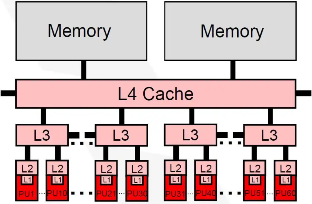

In addition to avoiding cross-LPAR contention for cache from other LPARs, an additional benefit of maximizing work on VHs is its positive impact on LPAR topology. PR/SM dynamically assigns LPAR CPs and memory to hardware chips, nodes and drawers seeking to optimize cache efficiency. This topology can have a very significant impact on processor performance because remote cache accesses can take hundreds of machine cycles.
Figure 7: z14 Drawer Cache Architecture [Hutton2020]
A z13, z14, or z15 processor has up to five CPU drawers (depending on the model), along with some number of I/O drawers. Figure 7 (reflecting one CPU drawer on a z14) provides a framework for the following discussion.[6] Each active physical CP (labeled “PU” on Figure 7) has its own dedicated Level 1 and Level 2 cache.
When a unit of work executing on a CP on a given Single Chip Module (SCM) accesses data in Level 3 (L3) cache (the first level that is shared across multiple CPs), that access can be on its own SCM chip, “on drawer” (on a different SCM in this drawer) or “off drawer” (on a different drawer in the processor). The more remote the access, the greater the number of machine cycles required. Similarly, accesses to L4 cache and to memory can be “on drawer” or “off drawer.”

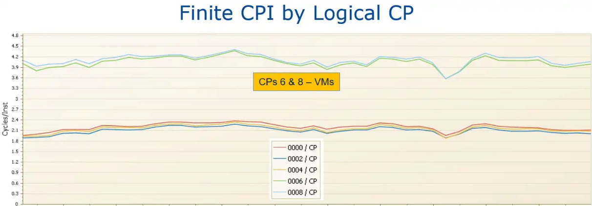

An example showing the potential impact of LPAR topology on Finite CPI is illustrated by Figure 8. Note that the Finite CPI values for the two VM logical CPs (CPs 6 and 8) on this system were significantly higher than those for the VHs. The atypical[7] magnitude of this system’s gap in Finite CPI between its VHs and VMs, which we might call the “VM penalty”, reflects an adverse LPAR topology where the VMs are likely located in a different drawer from the VHs.[8] When references by these VMs to data in shared levels of cache (Level 3 and above) are required to traverse across drawers to access data that has been staged by the VHs, those accesses can take hundreds of machine cycles.
Thus, the practical outcome of adverse LPAR topology is that workload not executing on VHs can experience Finite CPI values significantly higher[9] than work executing on VHs. In an environment where Finite CPI (“waiting cycles”) constitutes half of total CPI, a 40% higher Finite CPI translates into work executing on VM/VL logical CPs consuming 20% more CPU.
When there is a significant disparity between the Finite CPIs for VMs and VHs on the same system, an investigation of the LPAR topology is warranted.[10] Since PR/SM prioritizes collocating VHs, work executing there avoids the waiting cycles associated with cross-node or cross-drawer accesses that can be experienced on VMs. This, in addition to avoiding cross-LPAR contention for cache from other LPARs, is another benefit of maximizing work executing on VHs,
