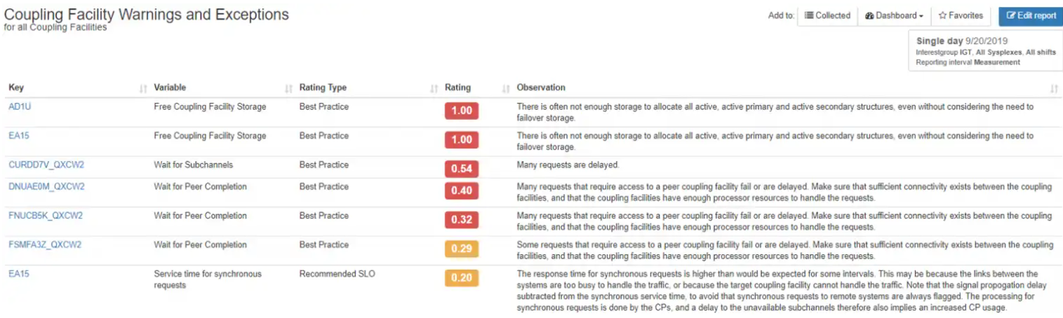

IBM Z IntelliMagic Vision for z/OS begins the root cause analysis process with a high level “Warnings and Exceptions” table which gets us started right where it matters most. The example below is for Coupling Facilities.
This view alerts us to all CF components that have exceptions (highlighted red), indicating likely disruptions, and warnings (highlighted yellow) about potential issues we may not even know about.
In addition to the prioritized exception table, we are offered Observations for what is likely causing the issue and what we can do about it. For example, the Observations for the “Wait for Peer Completion” report, says, “Many requests that require access to a peer coupling facility fail or are delayed. Make sure that sufficient connectivity exists between the coupling facilities, and that the coupling facilities have enough processor resources to handle the requests”
We are immediately shown what all current and upcoming issues are from this single view, and specifically what is causing them. Much of the root cause analysis is done in the first step.

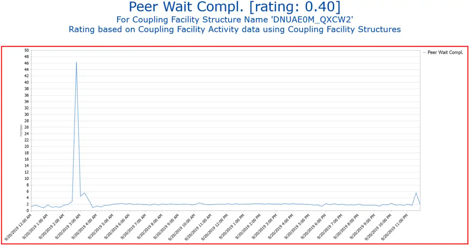

By clicking on any of the reports, we are taken to the report with the exception or warning. Let’s drill down to the Wait for Peer Completion report.
In this view we can see the Peer Wait Completion for a coupling facility structure, and indeed, the response time spiked early in the morning and is significantly exceeding the threshold.

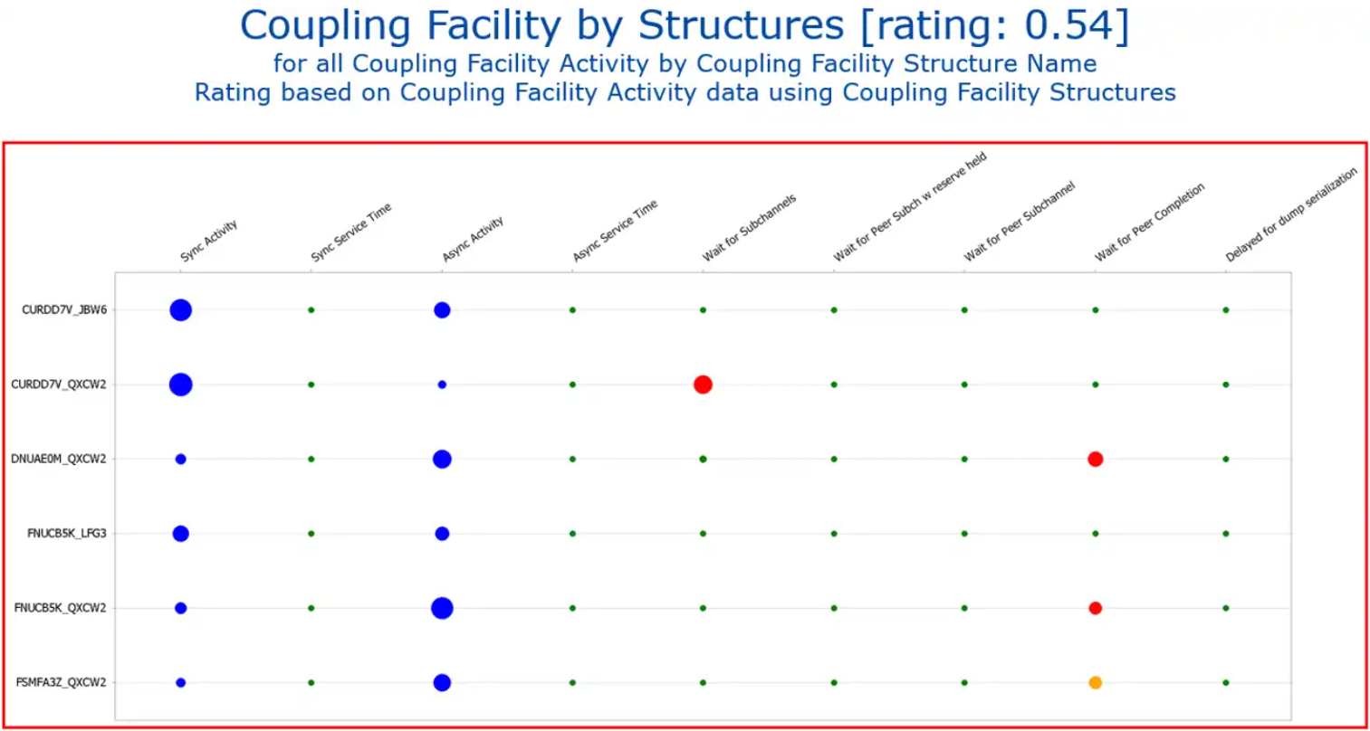

Another way to determine the root cause of performance issues is to begin at the Coupling Facility Health Insights Reports, such as the Health Insight for Coupling Facility by Structures. Rather than always needing to return to the exception dashboard to resolve issues, it’s important to be able to see issues while examining overall health and performance. This view below represents all of the structures in the environment and gives a good indicator of the overall health.
Using the basic color scheme of green means good, yellow is a warning, and red is an exception, we immediately see that there are performance issues occurring right now. The color of the icons, as well as the frame surrounding the report, comes from the rating, in this case 0.54. We do not need to interpret the rating at this stage because the color scheme does that for us. (Blue icons indicate metrics that don’t warrant a rating.)
Looking at the key metrics above the rated icons, we see that there is clearly an issue in Wait for Peer Completion for several Structures.
The rated health insights report turned some lights on in this rabbit hole, and the red bubbles tell us exactly which paths to go down – clicking on the red bubble takes us to the next step.

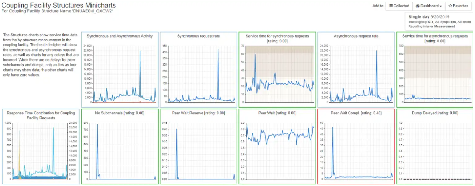

After clicking on the red icon in the previous chart, we see a set of minicharts representing all of the various components and key metrics of the structure. Like the overview dashboard, many of these charts are rated to tell us where to investigate further.
Drill Downs Result in Root Cause Discovery

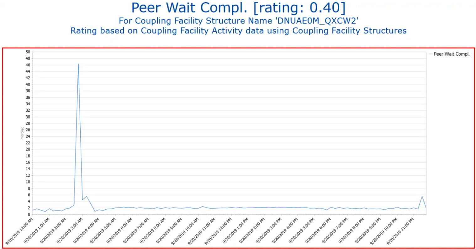

We can continue with the root cause analysis by drilling down into the chart with the red border. You can see that we navigated to the same report that we saw in the initial exception report.
During the time period seen at the bottom of the chart, this structure crossed the exception threshold for a significant enough amount of time to generate the red border and high rating.
And thanks to the recommendations from IBM Z IntelliMagic Vision for z/OS, we know that to resolve this problem. We need to make sure that sufficient connectivity exists between the coupling facilities, and that the coupling facilities have enough processor resources to handle the requests. A z/OS Systems performance expert may take this knowledge for granted, but a novice to the industry may greatly benefit not only from quick drill down capabilities, but from recommendations within the field descriptions.
