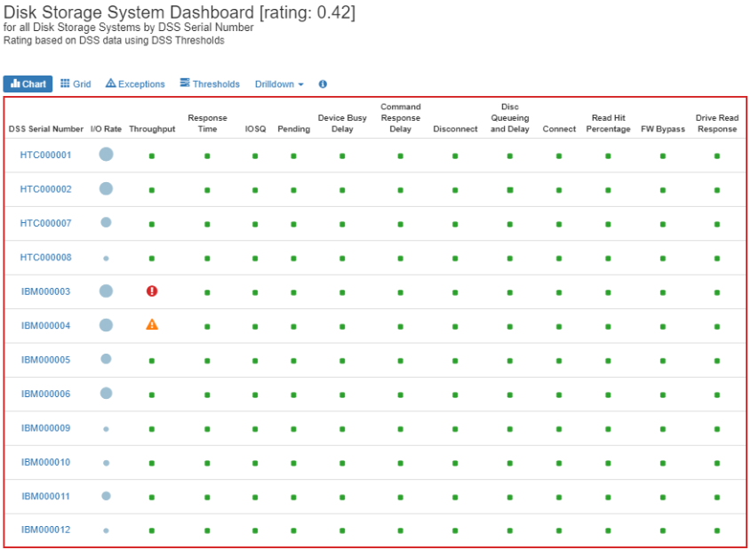

Let me explain with an example. You have done your best to ensure there is enough CPU on the floor to manage your workloads, but you did not update or plan for your DASD subsystem. If peak season rolls around and your CPU is indeed good, but the throughput on your DASD boxes exceeds the capabilities of the machines, your workloads are going to have an issue.
In the following IBM Z IntelliMagic Vision for z/OS dashboard, you can quickly see that while most of the higher level DASD metrics are healthy, throughput is being flagged as nearing the limits of the box capabilities.

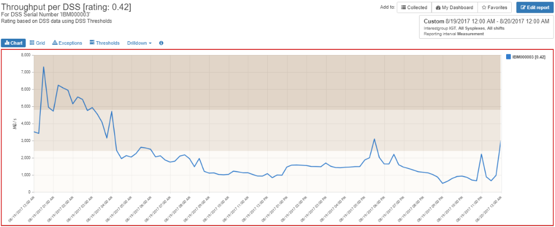

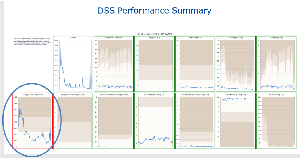

By drilling down, we can look at all of the charts related to the dashboard icons and see which DASD components you can tune before your company’s peak period.
In this case, we clearly need to take a closer look at our Throughput. If we had just been concerned about how much CPU we had, this throughput issue would not have been on our radar.

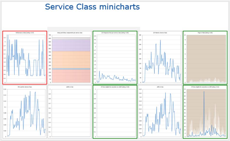

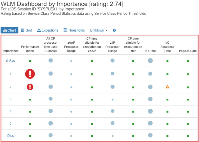

I can illustrate with another example. Is your Workload Manager (WLM) Service Policy ready for your upcoming peak season? You might have enough CPU on the floor, but if your workload causes the CPU usage to spike, does your service policy handle the spike as you expect?
The dashboard below shows that a service class or service classes in the importance 1 and importance 2 groups are having issues. This is not what you want to see, especially not during a peak before your company’s busy season.
A dashboard like this could show that you need to update your service class goals in order to perform better during peak workload times. You would much rather see your importance 1 and 2 groups in “the green” rather than the red in this example.
IntelliMagic Vision has an extensive suite of WLM dashboards and reports to drill down very quickly into service class period performance. Here is one example of a multi-chart for a service class that was flagged as missing its goal.
You can quickly see when the service class is missing its goal, why it’s missing its goal, and if it is “busy enough” to be a priority in your tuning efforts. Perhaps you need to make higher importance service class period goals more aggressive and/or lower importance service class period goals less aggressive.

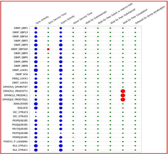

Another example of an area that can be challenging to monitor and track is the area of coupling facility performance. If all of your z/OS infrastructure components are healthy except your coupling facility requests, then your business can still be heavily impacted.
IntelliMagic Vision has an extensive set of coupling facility dashboards and other reports that can make the health assessment of your coupling facility very easy. Here is an example of one of the higher-level coupling facility dashboards. What jumps out is that one structure is getting poor synchronous service times, which should be addressed with some urgency.
