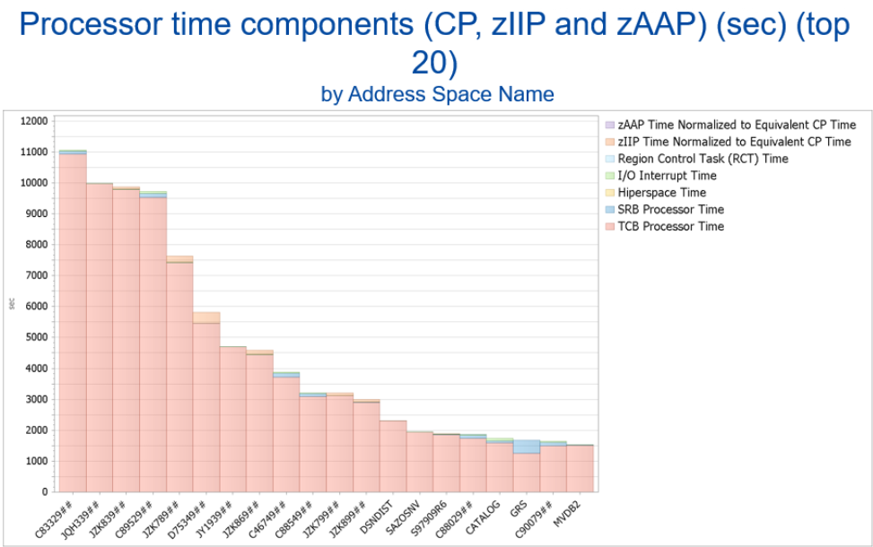

Recently, we helped a customer understand which address spaces were the top CPU consumers whenever their z/OS system alerted them to capping issues. When the alert is received, IntelliMagic Vision runs the automation and emails them the top address spaces over the last four hours. Here is an example of the type of report below:

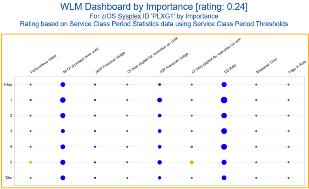

Another example of the type of alerting integration possible is to receive a Workload Manager Dashboard in the event z/OS alerted that a service class was missing its goal. This dashboard would tell you right away if higher importance work (1’s or 2’s) was having an issue, or lower importance work was triggering the alert.
If you received the dashboard shown above, you might be able to address the alert at a more convenient time, since only importance 5 work is missing its goal. Regardless of the importance, you could also have a report in the report set that would tell you which service class was missing its goal.
