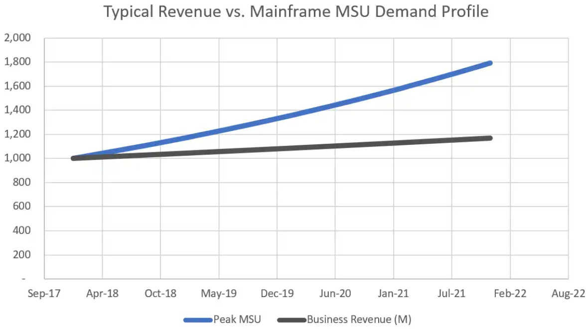

How does your MSU growth compare to your revenue growth? As the new year begins, how are your goals aligning with the business?
While this is purely a hypothetical example that plots typical compute growth rates (~15%) with business revenue growth (~4%), there are many of you that would agree with the widening gap. Whether it is MSU’s or midrange server costs vs. revenue, this graphic is commonplace.
The simplification above ignores seasonality and other variables that may also impact growth, but it demonstrates the problem nearly every CIO has. How can the gap for IT spending vs. revenue and/or profit be managed so that additional spending on other key components of the business can deploy the cash needed to build revenue and profit?

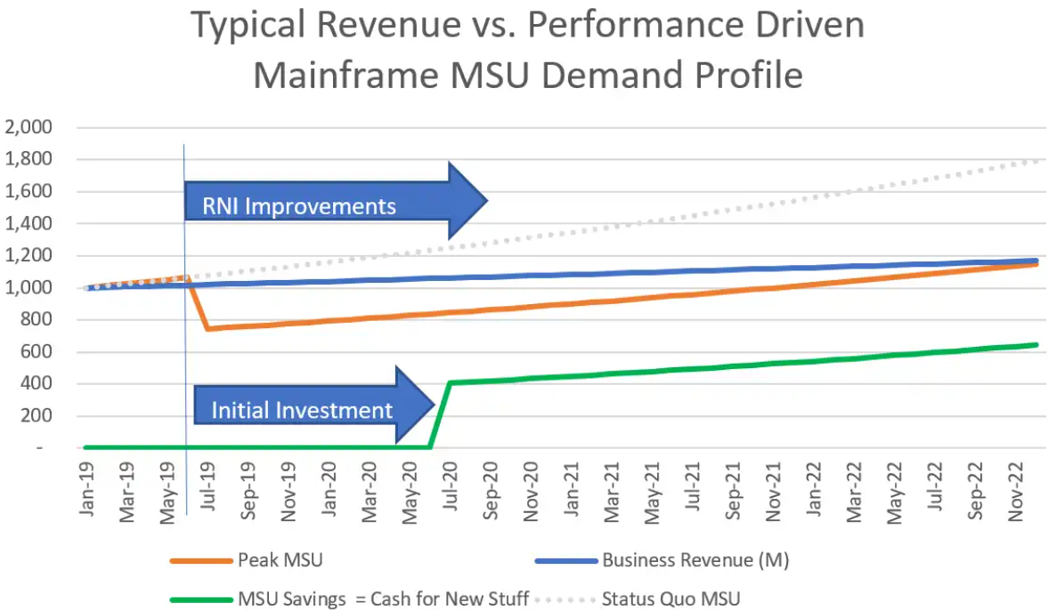

One very visible example from our own Todd Havekost demonstrates the value of lowering your RNI (Relative Nest Intensity) using some configuration changes.
Just a quick refresh on RNI: a lower value indicates improved processor efficiency for a constant workload. A lower RNI drives lower MSU for the same workload, and the results can be significant!
There are several ways to drive for lower RNI, and the reference above gives you several ideas on where to start. Look at how a small change in a performance metric can alter the long-term capacity plan!
Performance Led Capacity Plan
While you don’t often receive a gift like this in your performance options, keep informed.
Part of your capacity planning regimen should be working with your colleagues in systems, DB2, CICS, and applications to solicit changes that might deliver a welcome demand drop and slower future growth. A small change in the rudder, can move a mighty ship!
