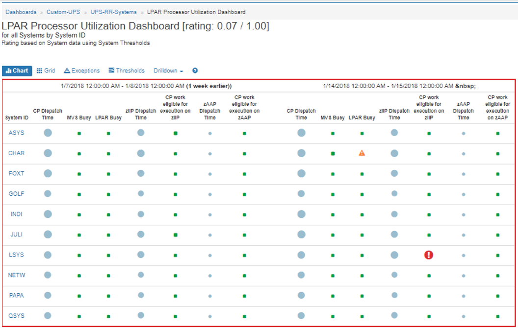

The visual below provides a rated bubble chart with one red indicator for excessive zIIP eligible work on a general-purpose engine.
LPAR Processor Utilization Dashboard
Probing into that system provides a view of the last day as compared to the week prior – a common baselining technique easily selected within IntelliMagic Vision.

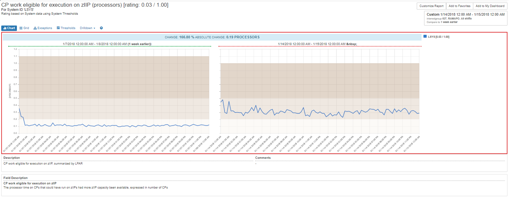

Zooming into the view below, this bad behavior is highly correlated with the demand from a rather generic (STCLOW) service class.

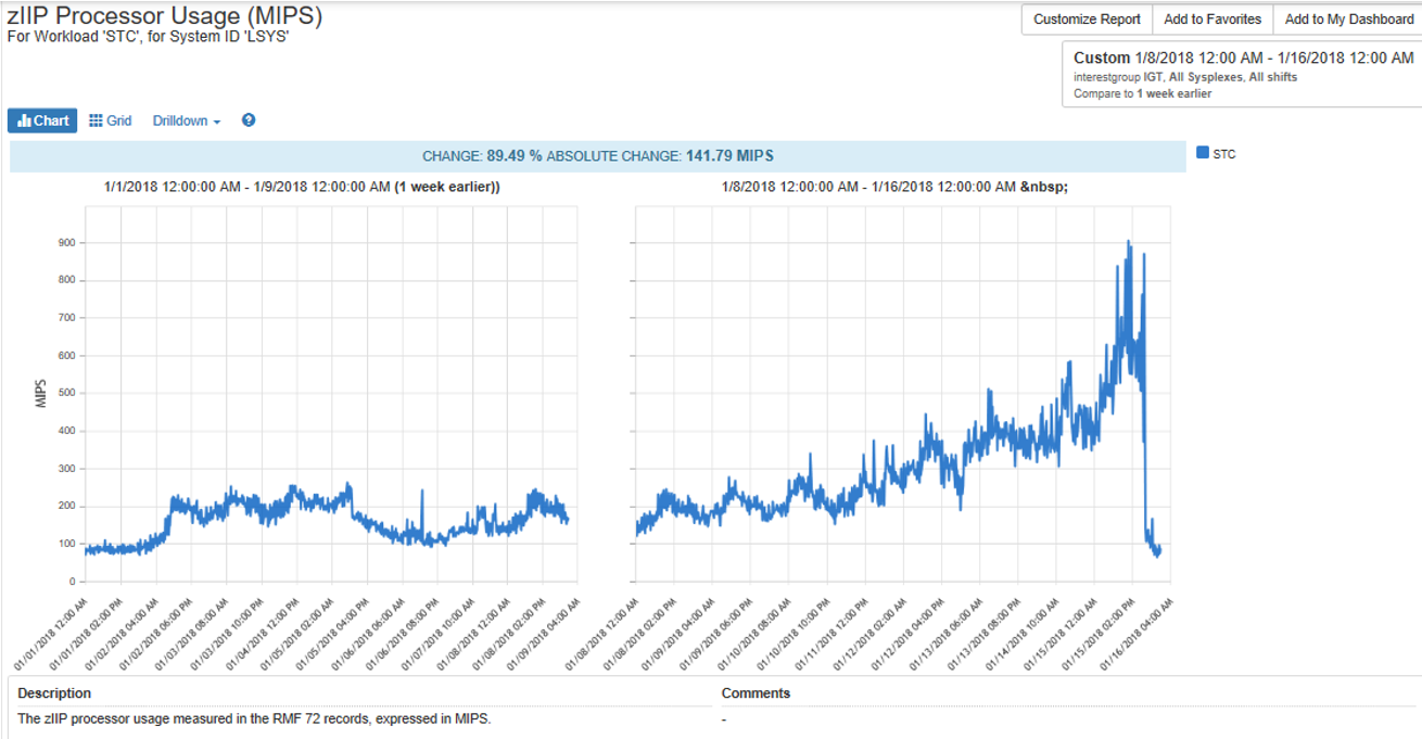

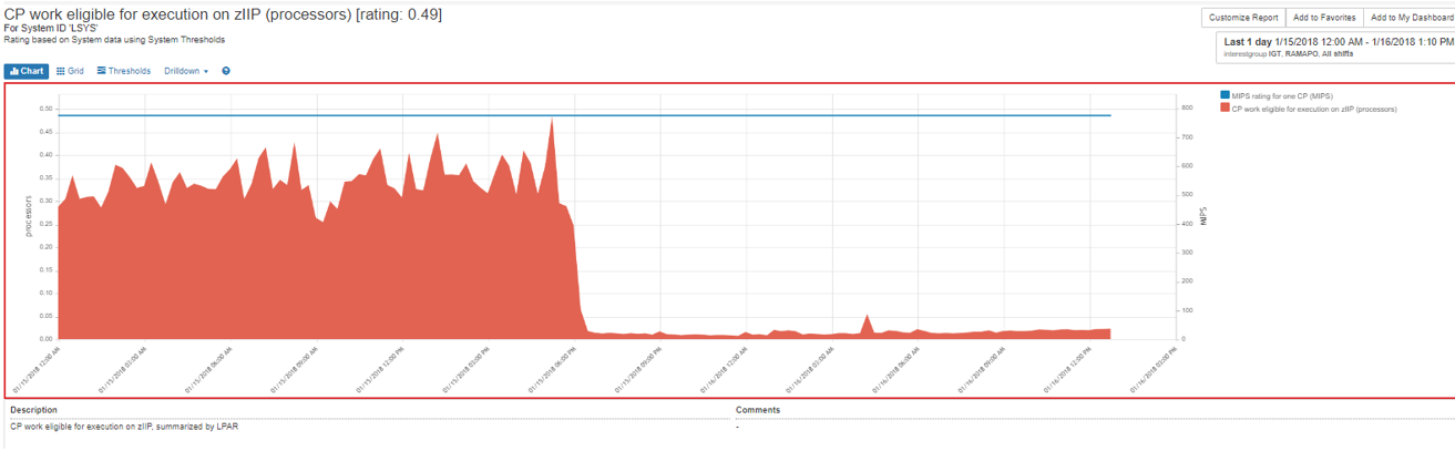

In fact, once we remedy the problem we see that it was consuming 900 MIPS of zIIP capacity and was also driving 300 MIPS work onto the general CP (two charts below). If this is your internal software, you would be opening a defect with the application owner; if it was COTS software, perhaps a rebate is in order until the vendor remedies this problem. Regardless, you have what’s required to drive a wooden stake home and prevent another occurrence.
The growth below shows the exponential zIIP growth that eclipses 900 MIPS in two weeks.
zIIP Processor Usage (MIPS)
The CP work eligible for zIIP processing on the CP was remedied on January 16th, but was over 700 MIPS which likely impacted the MLC for January.
