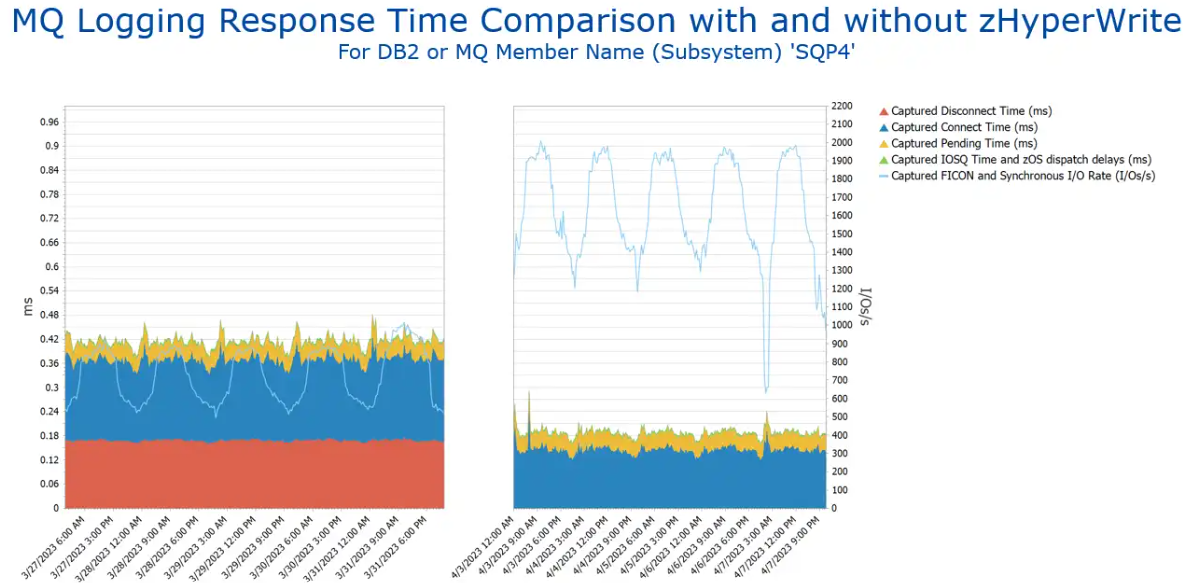

Figure 1 below shows an example of implementing zHyperWrite in a large MQ environment, with comparison data for key before-and-after metrics. Figure 1: IBM Z IntelliMagic Vision for z/OS report comparing MQ Logging with and without zHyperWrite
Figure 1: IntelliMagic Vision report comparing MQ Logging with and without zHyperWrite
Figure 1 shows MQ logging data for several business days before the zHyperWrite implementation on the left and several business days after implementation, on the right. You can see that the I/O rate doubled, since there are now FICON channel I/Os to both the primary and secondary device. Metro Mirror ops/second are shown in red. These are the ops that were peer to peer from primary to secondary but are now direct writes from the system to the secondary. Notably, the response time was greatly improved, roughly cut in half.

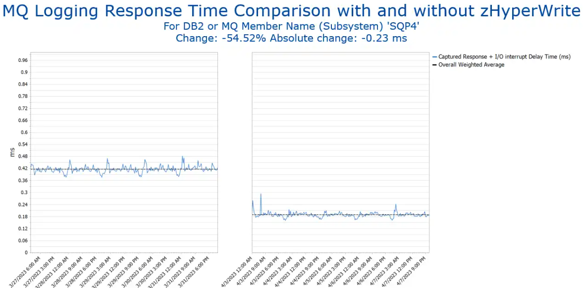

Breaking down the response time components, as shown in Figure 2 below, we can see that the improvement is primarily due to the elimination of disconnect time (the red area).
Figure 2: Implementing zHyperWrite Eliminated Disconnect Time, Improving Response Time

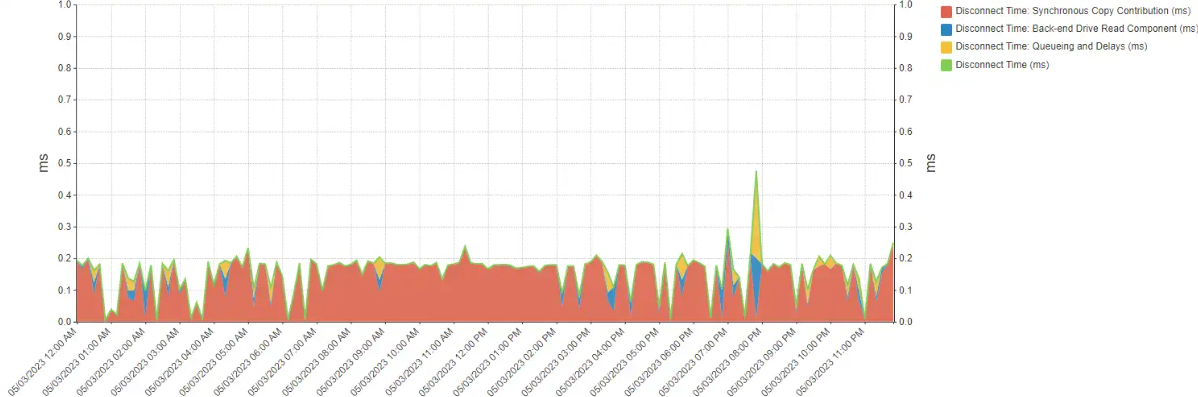

Further breaking down the components of disconnect time shows that the improvement comes from eliminating the synchronous copy contribution. This data can be obtained from the type 74 records combined with intelligence built into IBM Z IntelliMagic Vision for z/OS. Here is an example of a volume used for MQ logging, not using zHyperWrite.
Figure 3: Name
Note that the overall disconnect time is approximately .2 milliseconds, as we saw at the dataset level in Figure 2 before zHyperWrite. Also note that almost all the disconnect time is the synchronous copy contribution (in red).

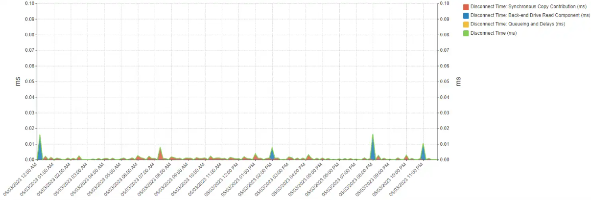

In contrast, the Figure 4 shows a volume with MQ logging using zHyperWrite, with essentially zero disconnect time.
Figure 4

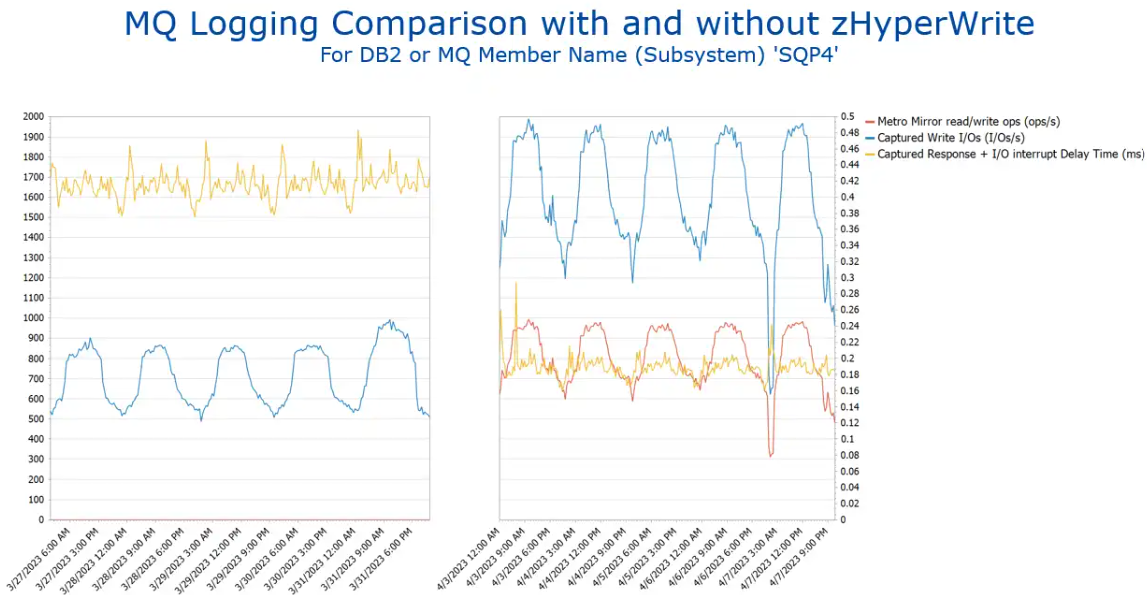

The most important bottom-line comparison is the overall response time improvement. Figure 5 shows a 54% improvement for this heavily used MQ subsystem.
Figure 5: MQ Logging Response Time Comparison with and without zHyperWrite
