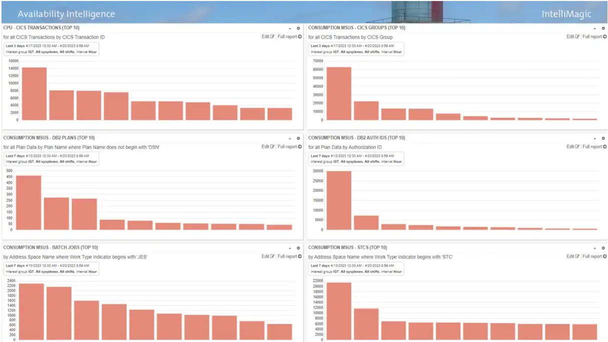

However, with the multitude of diverse workloads on the mainframe, it becomes essential to have visibility into top CPU consumers and top drivers of CPU growth to focus on the most promising opportunities. One way this can be achieved is through dynamic dashboards designed to give team members a common view across the organization and to enable them to quickly identify and drill down to pursue more detailed analysis of metrics of interest. Figure 1 illustrates a dashboard that captures top 10 CPU consumers for several types of workloads.
Figure 1: IBM Z IntelliMagic Vision for z/OS Dashboard with “Top 10” reports

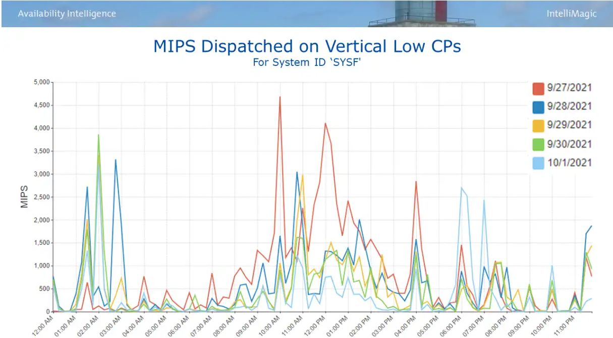

First, identify the volume of work executing on Vertical Low (VL) logical CPs. This represents work exceeding the LPAR's guaranteed share derived from its LPAR weight. Vertical High (VH) CPs have dedicated access to a physical CP and its associated cache. But work running on VLs is exposed to cross-LPAR contention for cache so that its data often gets flushed out of cache by data from other LPARs.
Figure 2 provides a view to answer the question "do you have a significant amount of work executing on VLs?" If not, you can look elsewhere. If so (as is the case in Figure 2), then you need to answer one other question.
Figure 2: MIPS Dispatched on Vertical Low CPs
If not, you can look elsewhere. If so (as is the case in Figure 2), then you need to answer one other question. “Is there a significant difference in Finite Cycles per Instruction (CPI) between your work executing on VLs and that running on VHs and VMs?” Finite CPI quantifies the machine cycles spent waiting for data and instructions to be staged into Level 1 cache so that productive work can be done. So another way to express this question is "do your VLs have a significant Finite CPI penalty?"

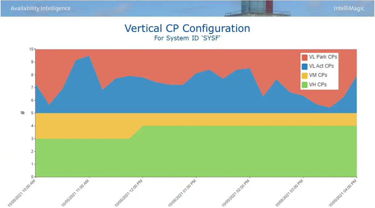

To answer that question, you first need to understand your Vertical CP configuration. In the example in Figure 3, the 10 logical CPs for this system are configured as 5 VLs (in red & blue) and a combination of 5 VHs and VMs (in green and yellow).
Figure 3: Vertical CP Configuration

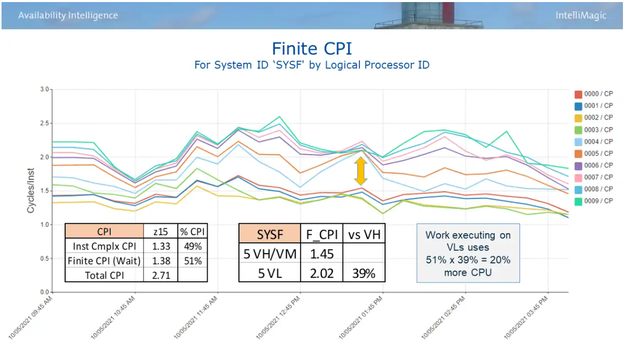

Armed with this understanding, you can examine Finite CPI by logical CP to quantify the penalty for the VLs, as shown in Figure 4. A sizable gap between the two sets of lines as seen at the arrow here is a visual indicator of a substantial VL penalty.
Figure 4: Finite CPI by Logical CP
Here is how the math works, first quantify the Finite CPI penalty for the VLs. To translate this into CPU savings, it needs to combined with the contribution of Finite CPI (waiting cycles) to overall CPI, a value also provided by the SMF 113 data.
On this system, the work executing on VL logical CPs incurs a 39% Finite CPI penalty, and Finite CPI (waiting cycles) makes up 51% of total CPI. So multiplying those two numbers results in a total CPU penalty of 20% for work executing on VL CPs. Or expressed another way, on this system changes that reduce the amount of work executing on VLs would reduce the CPU for that work by 20%.

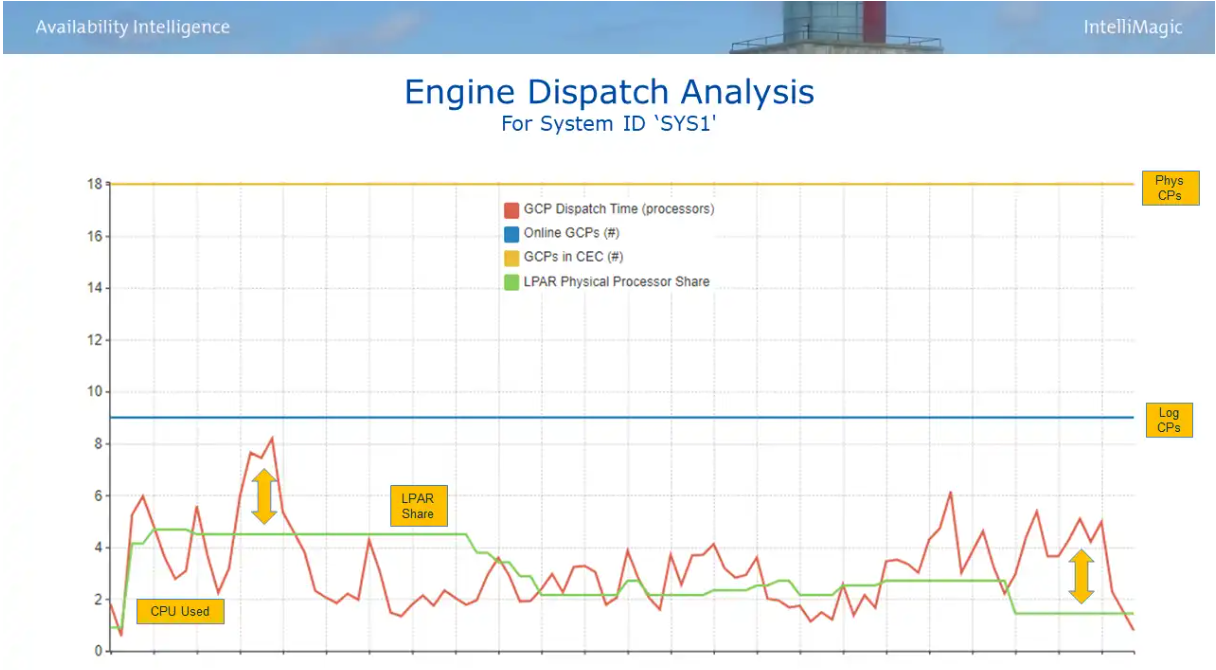

One course of action could be LPAR weight changes to improve the vertical CP configuration. A good way to identify any such opportunities is through an Engine Dispatch Analysis view as seen in Figure 5, which compares CPU usage of an LPAR over time to its allocated share.
Figure 5: Engine Dispatch Analysis – SYS1
If you have sizable cache efficiency opportunities like this, what kind of changes can you explore? One course of action could be LPAR weight changes to improve the vertical CP configuration. A good way to identify any such opportunities is through an Engine Dispatch Analysis view as seen in Figure 5.
This view presents four variables.
  • The number of physical CPs on the processor (in yellow, 18 here)
  • The number of logical CPs for the selected LPAR (in blue, 9 here)
  • The LPAR guaranteed share (in green), which is a function of LPAR weight and # of physical CPs
  • Note: The LPAR share is variable here because IRD (Intelligent Resource Director) is active causing PR/SM to dynamically change LPAR weights.
  • The interval CPU consumption in units of CPs (in red)
We will analyze two different LPARs that reside on the same processor. The arrows on Figure 5 highlight night shift intervals for this first LPAR (SYS1) where CPU usage far exceeds its share, resulting in lots of work executing on VLs.

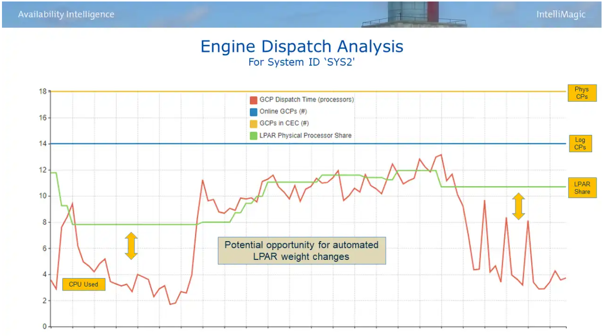

Compare this to the situation for a second LPAR (SYS2) during those night shift intervals, shown in Figure 6. The guaranteed share (in green) is far higher than CPU usage (in red), reflecting that SYS2 has far more weight than it needs.
Figure 6: Engine Dispatch Analysis – SYS2
This is an example where automated LPAR weight changes between these two LPARs could help that night-shift work run more efficiently on SYS1 with no adverse impact to SYS2.
